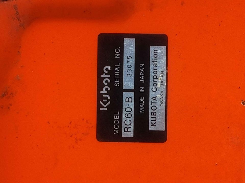

have read and tried to find if a RC60B - no following numbers or letters - will fit my BX25D. Thanks for any insights...

I did a quick search using "Kubota RC60-B". Found a couple of "For Sale" ads that indicate it fits B series tractors. Whether it could be modified to fit a BX25D is another can of worms.
Doug in SW IA
/ BX25D belly mower #3
From a Brochure online:
Mid-Mount Mower RCK54-23BX, RCK54P-23BX, RCK60B-23BX.
These are the 3 decks that fit on a BX25D.
