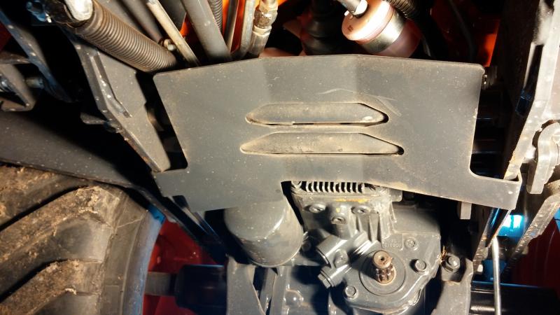

Mine is a 2yrs old BX25 and it has fan protection just as pictured. Not sure when the change was made, but it was at least a couple years back. The new guard works, frankly I was suprised it works as well as it does.
   / BX25D hydro fan and underside #12

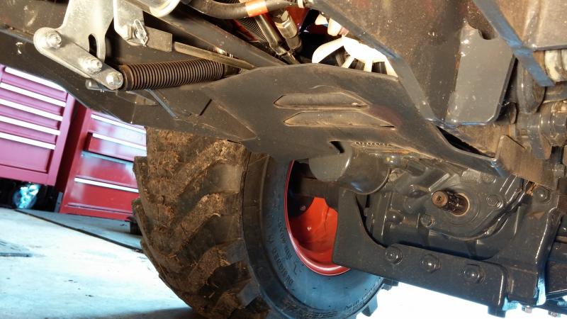

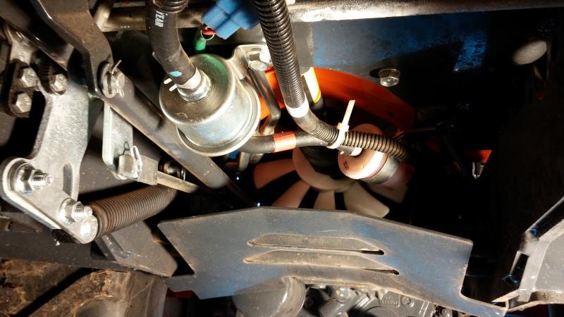

All I really did tonight was run out and take the pics...I did not feel like screwing with moving the buggy and everything so I just crawled under it again with a better light....the photos are much better this time.
Yea I am a bit lazy....and too much crap to move

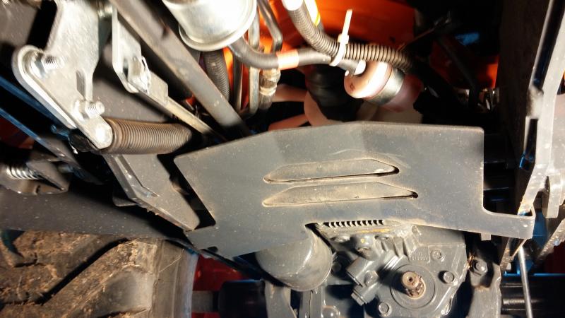

I don't have a BX25, it's too small to push the snow I need moved, but I can see why guys like them. That factory protective plate seems to me to be inadequate- a branch could easily get pushed in there, and wham. You gotta problem. Paul Shorts plates look like total protection, from below, anyway.
   / BX25D hydro fan and underside #16
When I had my 09 BX25 I made up a protective plate for the underbelly and fan.Looked real good until I installed the mower deck.When I tried to raise the deck the linkage bound up on the skid plate.After much trimming I was able to have protection for the fan and be able to use the deck as well.Just a word of caution to anyone who is thinking of making their own skid plate to use in conjunction with the deck,there is enough room but just barely.I think if I had one of the newer machines I would just add a vertical piece to the existing guard.

Now that I have seen it I am going to hold off ordering a plate. My thoughts are similar to kcender - adding a vertical piece to the top would add the needed protection. Seems like some minor fabricating and it would be a lot better.

Yes I would hold off. I wanted to feel the fan...see how bendy it was and such and I could just reach it with my finger tips....it is a good bit back there.
Truth be known I really thought about buying the armor without even taking a look under the machine. Now that I have been under there. I am really thinking I will risk it. I am thinking it will take a pretty good bit of wood or whatever to snap a blade...and the planets will have to be aligned just right for it to get in there. I would suggest waiting to see for yourself then make your own judgement based on the work you plan on doing.
   / BX25D hydro fan and underside #19
After seeing your pics, your plate is much more substantial than any other factory plates I have seen. If mine has the same plate as yours (when it is finally delivered), I doubt that I would see the need for an aftermarket skid plate. Thanks for the pics!
