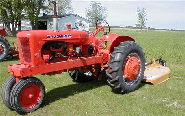

It is a lawn tractor because the engine/trans/rear end are not one continuos assembly as are my old units. Units mounted to a frame instead.
Lawn tractor: :)
   / BX25D ... Is it the machine I need? #40
Honestly the way it is assembled really works. Whatever you want to call it.....

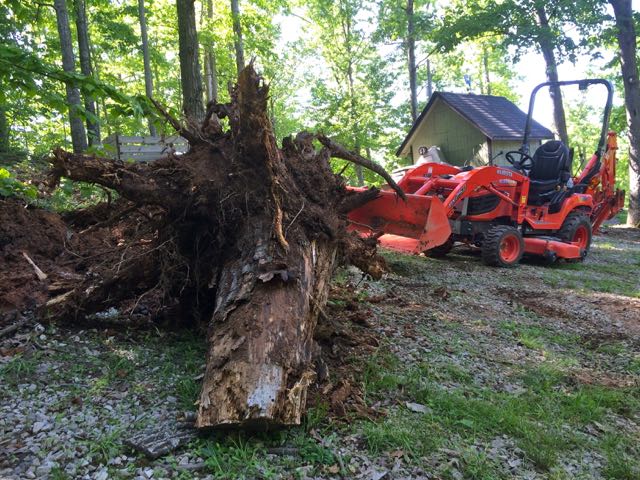

You very rarely (can't say I think I ever have) heard of any problems with the BX's breaking in ス, or having major structural issues. I use mine to remove stumps (see below - this one took a bit over an hour) , dig ditches, buried 150' of 4" line 4' deep without issue. It is not as fast as a Mini Ex or full size how but it does a real good job especially for the size.
