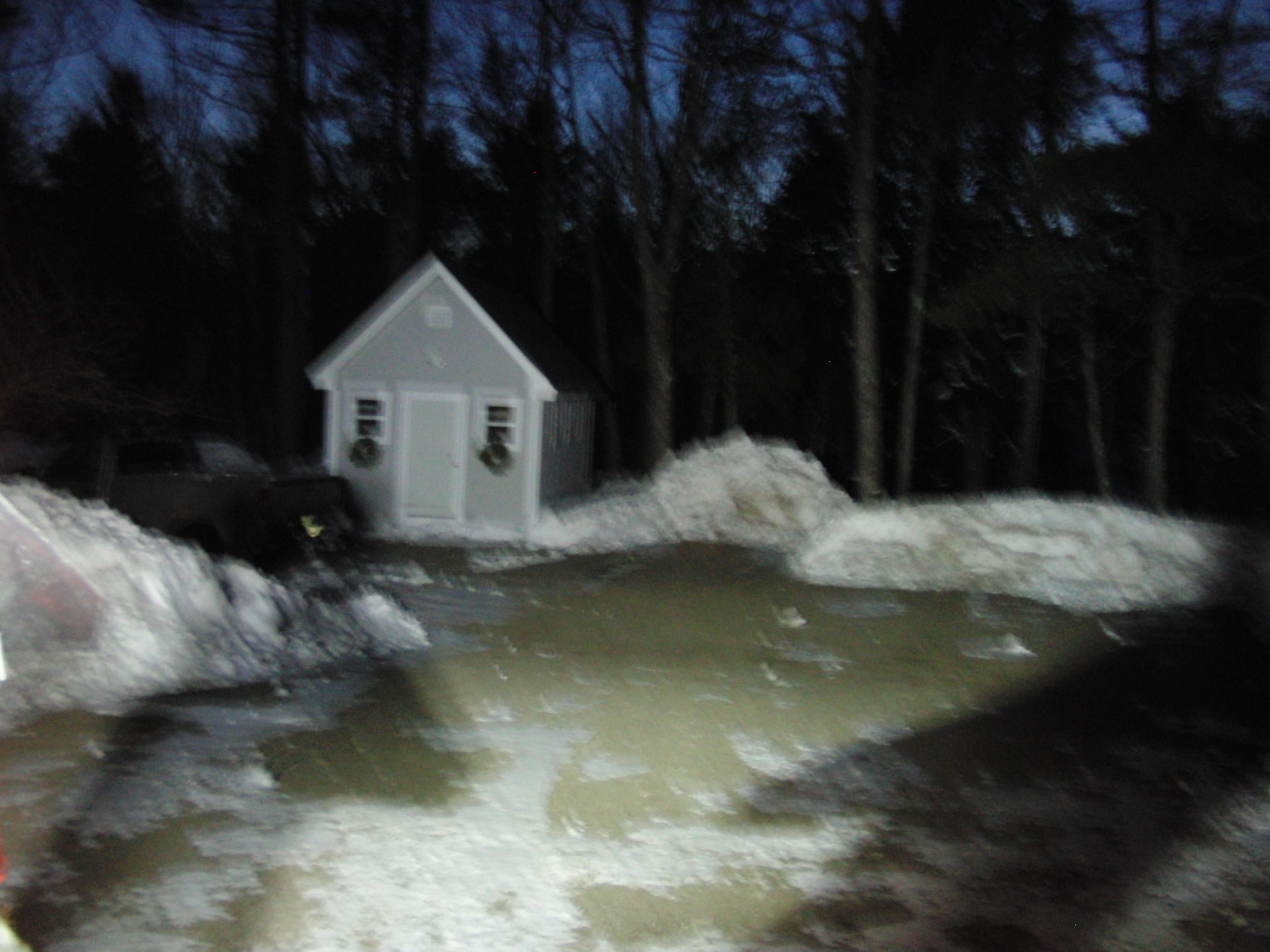

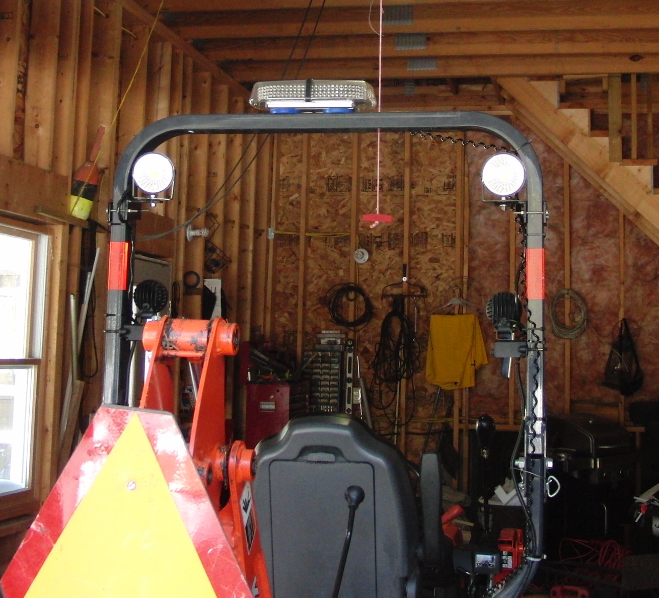

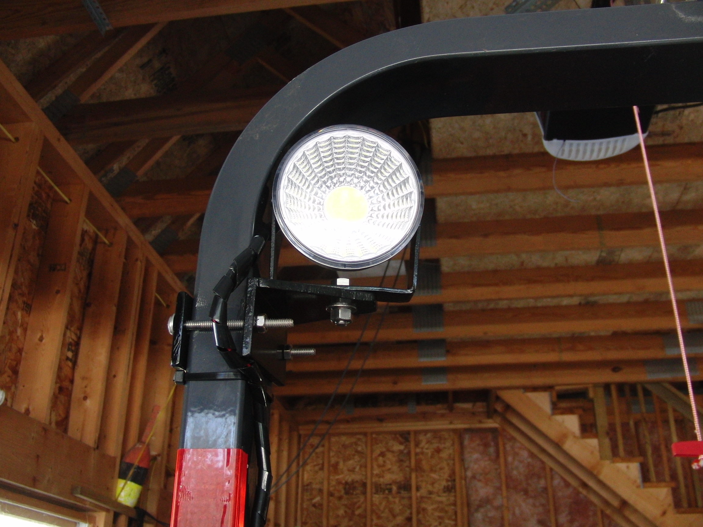

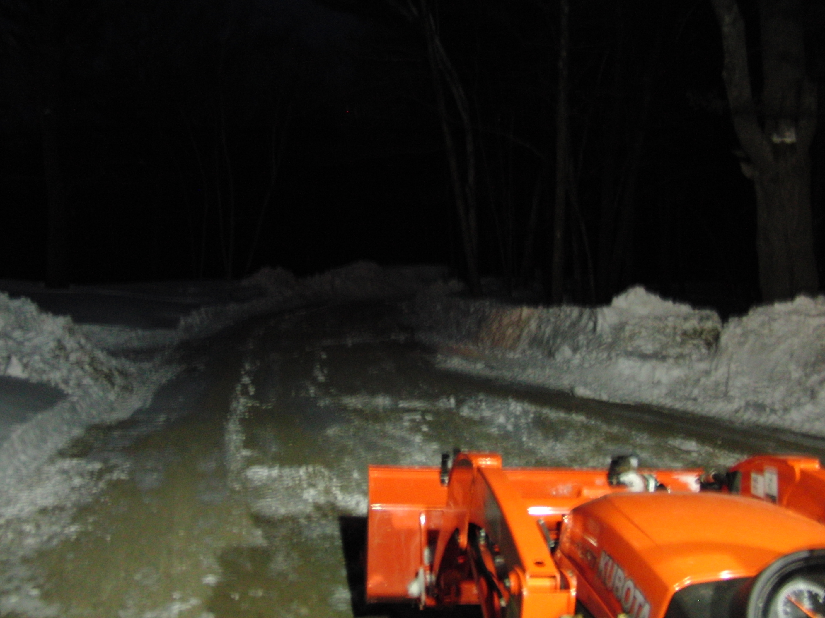

Just finished up a project I've been working on off and on this winter. I have the factory LED work lights on the ROPS but I wanted to keep them aimed forward and add some additional ones pointed to the rear. I picked up some LED "Off Road" lights at wally world and made some brackets out of scrap 1/4 aluminum angle stock I had around. A few SS srews and bolts, and I wired them into the factory work light switches and I'm all set. Thought others might like to see this.
/ BX25D Work Lights - DIY project
I had them pointed front, and the factory lights pointed back when I took this. The shed is lit by the factory lights. They are not as bright as the factory ones but bright enough! :thumbsup:
