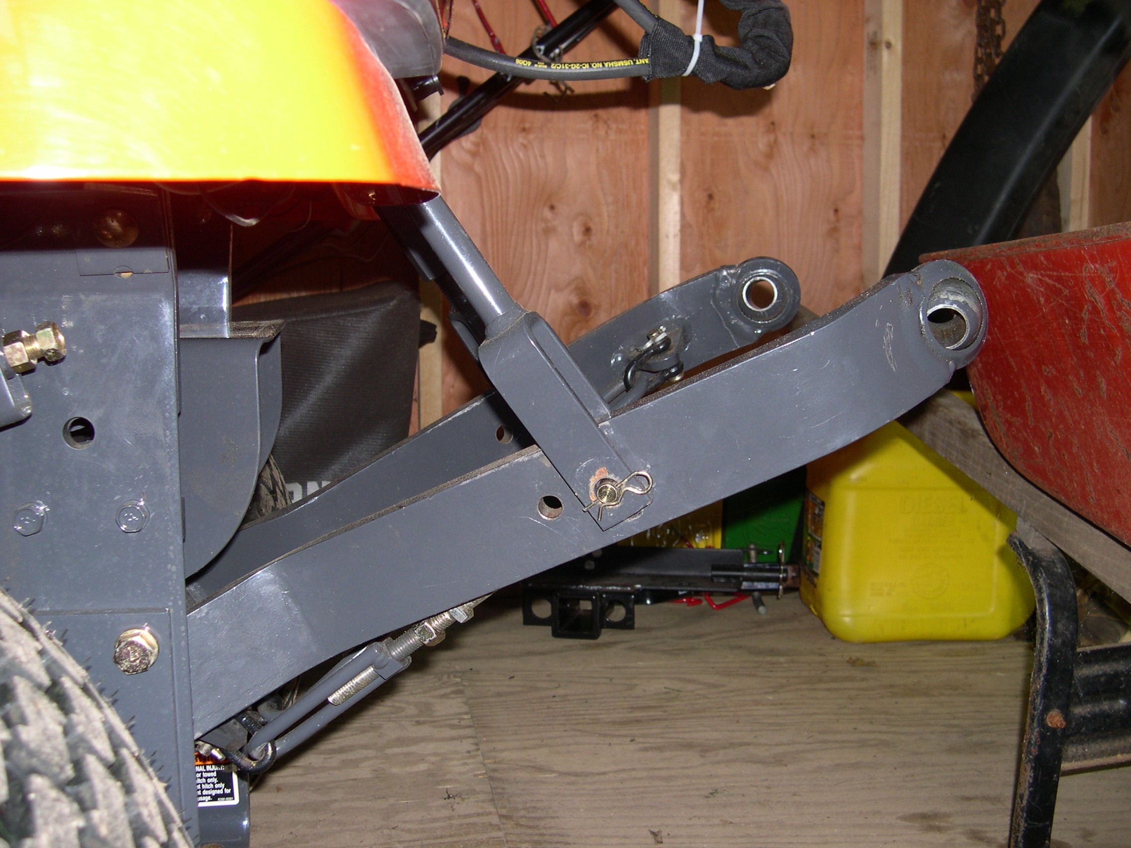

I don't believe the upper 3PH arms are designed to be rotated as you're asking. Make sure your 3PH rate of drop dial (between your legs under the seat) is open enough. Also, the 3PH doesn't always drop fully without weight on it, so you might have to step on it to get it to move fully down. If none of that works, you might consider drilling a second set of holes in the lower 3PH arms and moving the vertical lift links a inch or so closer in to the BX rear end. I had my dealer do this for me as part of the sales deal since a few of my implements require the 3PH to drop lower. Here's a pic of what I'm referring to - the inner holes allow the hitch to drop a few inches lower.

/ Bx2660 3PH & Taillight #3
I would not change the upper link arms, even if that can be done. Do like CHDinCT said 1st about drilling the extra holes.
You can make sure the front balls in the lower links turn real easy. The lower link arms have to twist when going up and down. When you go up you have hyd pis and it well twist the ball to one side, but going down no psi and the lower link well not twist and it well not go down.
I had to take the lower links off of mine and sand the heck out of them. They were locked up bad and that is why CHDinCT said you have to stand on them. Mine goes all the way down now by themself and I did drill the holes.

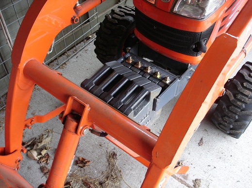

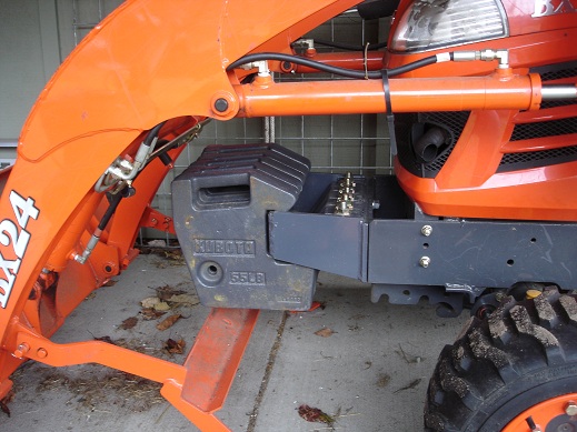

I also want to install some front weight. Can they be attached easy or do I need some brackets? p.s. I have a front guard
For what it's worth...
I went the factory route for front weights on my BX24. Mounting the weight bracket requires removing the guard. The supplied weight anchor bolts (actually the nuts w/welded "L" pieces) didn't fit the supplied bracket. Manufacturing change that didn't get applied to all parts, I guess. The dealer had to modify the bracket w/a grinder. The bracket has to come off to put the loader on. Etc, etc, etc...
Oh, and serious $$$$ All in all, a major PITA. And this was because I went factory to insure compatibility. Grrrr,
Z.
[edit] A couple of pix - note the loader is not attached.

thanx for the picture! didn't know they would take so much space!
Yeah, in hindsight, I should have kept the smaller suitcase weights from my Deere 425 (that I gave away) and just hung them off the frame. They don't have the long "tails" that the Kubota weights have.
OTOH, the Deere-style weights are a little lighter, and without the tails, don't have the same leverage.
As to length and tight spaces: the Kubota weights are shorter than my loader :) That's why I got weights - so I could run a tiller with the loader off.
Z.

BTW, if the 3 pt is working properly, for what usage or attachment did you find it necessary to drill those holes in the lower arms to get a lower position? So far, my plow and rear blade function okay without lowering them further.
Two of my attachments use the inner holes. One is my Wallenstein BX42 chipper. It's a know issue with the pins on this chipper being too low for BX hitches. I've read other BX owners with this chipper add wood blocking to the bottom of the chipper frame so they can hook it up. The other implement is an old Woods 5' rear blade that will work with the standard holes, but if I shorten the top link at all to make the blade angle more aggressive, it comes off the ground making it useless. I think this issue has to do with the geometry of the old blade which is noticeably shorter in length than newer versions.
Back to the OP's 3PH issue, 12" minimum height seems very high. I want to say mine will drop to about 5"-6" using the standard holes. Something seems wrong here. If your hitch is not bound up somewhere (from overpaint??) and it won't go any lower than 12" with weight on it, I suppose the upper arms may have been miss-indexed at the factory, or the prior owner messed it up somehow. Did you buy it from a dealer? Might be worth having them look at it if you did.
It is true you would loose some lifting power using holes closer in to the tractor, but I can't imagine it would be much.
