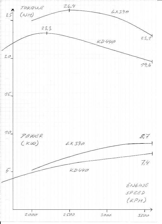

In order to properly describe the characteristics of an engine, a number of engine performance parameters are necessary. The two best ones, being the torque curve and the power curve. Sadly, these important torque and power characteristics are not always easy to find, and often an engine is simply marketed with its rated power only. This is the peak power that the engine is capable of delivering, when running at wide open throttle and with the maximum torque load that will allow the engine to maintain rated speed. Rated speed is the maximum engine speed that the governor will allow, and is the maximum speed, at witch the engine is designed to operate continuously.
More interesting for many tasks however, is how the engine perform in the medium to low speed range and at part-load, and that is best seen on the torque/power curves. Sadly, there have been so many different standards for measuring small engine performance over the years, that it can be difficult/impossible to compare two or more engines directly. I am not familiar with these standards, but please note that these two engines were tested using different standards (GX390 used SAE J1349, and Kohler KD440 used ISO 3046/1), which might give values that are difficult to compare directly, but the shape of the curves still represent the two different engine types well, I think.
To be able to compare the performance curves of the two engines more directly and in the same scale, I have drawn a figure of the curves on top of one-another, using the NB and MB curves for the diesel engine:
As can be seen from the 2 pair of performance curves, the gasoline engine is not just more powerful at peak power as advertised, it is more powerful than the diesel engine at any speed from peak down to its lowest recommended operating speed of 2000 rpm (see the 2 lower power curves)! This came as a surprise to me, as I expected the power curve for the diesel engine to cross the curve for the gasoline engine at some point, and get on top at lower speeds. How can a lower rated engine otherwise feel more powerful at medium to low speeds? As power is the product of torque - the twisting moment of an engine - multiplied by engine speed, and these two engines have the same speed range, it is no surprise that the gasoline engine have more torque than the diesel at any speed as well (see the 2 upper torque curves). As power is also the rate of doing work, i. e. work per unit of time, the gasoline engine will produce more work than the diesel at any given speed, so why is the diesel engine then often perceived as more powerful - especially at lower speeds?
This is due to engine elasticity I think, which is usually higher in a diesel engine than in a gasoline one. An engine is considered to be more elastic ("torquey"), if peak torque is produced at low engine speed, and increases significantly as engine speed drops below rated speed. Similarly, an engine is considered to be less elastic ("peaky"), if peak torque is produced at high engine speed, and torque only rises slightly as engine speed drops below rated speed.
As can be seen on the lower torque curve, the diesel engine has its peak torque (23.3 Nm) further to the left than the gasoline engine on the upper curve, primarily due to its higher volumetric efficiency at part-load. The torque curve for the KD440 also rises linear almost all the way from 3600 rpm down to peak torque, whereas the GX390 curve is steeper at 3600 rpm, but becomes more and more flat approaching peak torque. These curves enable the gasoline engine to cope better with increased load at high speeds (3600 rpm down to around 3000 rpm), but also to slowly run out of extra torque between around 3000 rpm down to 2500 rpm, if the load is not reduced. The diesel engine on the other hand, will lose more engine speed at high rpm as the torque curve is flatter, whereas it will be able to "lug" itself out of an overload situation approaching peak torque much better, as the torque curve rises all the way to peak. Below peak torque, the torque curve of the KD440 remains relative flat, whereas it drops relative steep for the GX390. It is probably no coincidence, that the torque and power curve for the Honda engine ends at 2000 rpm, whereas those for the Kohler continues down to 1600 rpm. I would expect the torque curve for the Honda engine to drop steeply below 2000 rpm, whereas the Kohler engine is able to produce useful torque, all the way down to 1600 rpm.
It might at first seem odd to talk about torque rise - also called torque backup, torque reserve or torque elasticity, when in fact the curves drops from peak torque to torque at rated engine speed. This is because the curves are read from right to left, i. e. from rated speed towards low idle. Torque rise is the difference between peak torque, and torque at rated speed, and indicates how well the engine will be able to handle an increased load. Torque rise is usually calculated as a percentage of the torque at rated speed.
The GX390 has a torque rise of 26.4-23.1 = 3.3 Nm (or 3.3/23.1x100 = 14.3%), whereas the KD440 has a torque rise of 23.3-19.6 = 3.7 Nm (or 3.7/19.6x100 = 18.9%).
For tractors, trucks and other heavy equipment, an elastic engine is desirable, as it better allows the engine to cope with an increased load, without the need for a downshift in gear, or the risk of stalling the engine. As the load increases, the engine speed will naturally drop, but as torque rises, an engine will only drop in speed until it reaches a stable condition, where the torque available matches the torque load. If the load increases beyond peak torque though, both engine types will stall unless a downshift is possible, as torque will drop with reduced engine speed. As peak torque is available at a lower engine speed in the KD440 engine, this engine has a better medium to low speed performance than the GX390.
At best, the power band is often the only way that engine elasticity is described. When comparing engines with the same speed range like in this example, the power band is useful when comparing the speed drop between peak torque and rated power of the two engines. These two engines both have a rated speed of 3600 rpm, and the gasoline engine produces its peak torque at 2500 rpm, the diesel at 2200 rpm. This gives the gasoline engine a narrower power band of 3600-2500 = 1100 rpm (giving an engine speed elasticity of 1100/2500x100 = 44.0%), compared to the diesel engines power band of 3600-2200 = 1400 rpm (giving an engine speed elasticity of 1400/2200x100 = 63.6%). On the other hand, the power band does not say anything about the difference in torque rise at all! If the power band is used as the only parameter to describe the elasticity of an engine, it gives a very incomplete picture. When taking the torque rise into account as well as the speed elasticity, much more information is available, and both parameters favours the diesel engine, as expected.
These two factors - the higher torque rise and the wider power band - both contributes to the higher elasticity of the diesel engine, and that again makes it more suitable for powering a tractor. By multiplying the two sorts of elasticity (the torque elasticity and the engine speed elasticity), an overall engine elasticity - the power index - is the result, as it combines the torque rise and the power band into a single value. The GX390 has a power index of 1.143x1.440 = 1.646 or 64.6%, and the KD440 has a power index of 1.189x1.636 = 1.945 or 94.5%. This gives the Kohler engine an engine elasticity which is (1.945-1.646)/1.646x100 = 18.2% higher than that of the Honda engine! [Floessel 1950; Lane 1966].
Although in this comparison the gasoline engine is the most powerful one with 11.7 hp compared to 10.1 hp for the diesel engine, the more elastic characteristic of the diesel engine (94.5% compared to 64.6%) might give the impression that it is more powerful when using it in real life in a tractor, as it copes better with an increased load; especially if the engines are not run at wide open throttle and at rated speed. In reality, the KD440 having "only" 10.1 hp, is of course less powerful than the GX390 having 11.7 hp, but its much higher elasticity makes it more suited for work in the medium to low-speed range and at part-load, where it will probably spend most of its time.

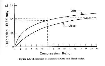

Since the early days of internal combustion engines, engineers have known that a high compression ration was the key to increasing the thermal efficiency of an engine. Due to the risk of knocking at high combustion chamber temperatures, the GX390 engine has been designed with a compression ratio of only 8.2:1, enabling the engine to run on regular grade gasoline with a Pump Octane Number of 86 PON or higher in for instance the US and Canada, or a Research Octane Number of 91 RON or higher, as sold in most of Europe and in Australia and New Zealand. As there is no fuel in the intake air of a diesel engine, there is also no risk of premature auto-ignition. A diesel engine need a compression ratio of around 14:1 or greater to auto-ignite, and the KD440 has been designed with a compression ratio of 20.3:1, which is 20.3/8.2 = 2.48 times that of the Honda engine!
The thermal efficiency of an engine is a measure of the amount of stored chemical energy contained in the fuel, that is converted to mechanical energy through combustion. In other words, it is a measure of how efficient the engine uses the fuel. The thermodynamics involved in an internal combustion engine are very complex, so often the cycles are split up and simplified, to make them easier to handle. With these simplifications, an engine is often called theoretical or ideal, which basically mean, that all processes are "best case scenarios" that follows the basic laws of thermodynamics. In an ideal engine, there is no friction for instance, and there is no heat lost to the surroundings through cooling or hot exhaust. As we all know, there are friction and heat losses in a real engine, and the efficiencies of an ideal engine will therefore always be higher as might be expected in a real engine.
As seen on the figure below, the Diesel-cycle has a lower theoretical thermal efficiency than the Otto-cycle, if they have the same compression ratio! In the real world though, the diesel engine has a much higher compression ration - as seen above, and therefore a higher theoretical thermal efficiency than the gasoline one, leading to a lower fuel consumption. [Goering & Hansen, 2008]

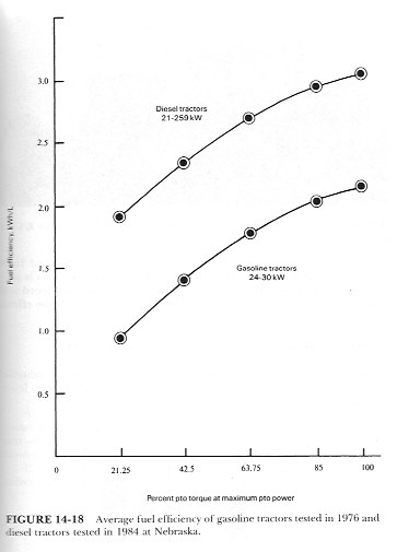

There are not many data available for small engines, but the figure below illustrates this issue for farm tractors tested at NTTL [Liljedahl et al., 1989]:
Note that the unit for fuel efficiency in the figure above is the inverse of the one used for the GX390 and KD440 in my examples above! At 100% load, the average gasoline tractor produced around 2.1 kWh/L in 1976, and the diesel tractors tested in 1984 around 3.0 kWh/L - or (3.0-2.1)/2.1x100 = 42.9% more for the same amount of fuel. At 21.25% load, the numbers are around 0.9 kWh/L for the gasoline tractors and 1.9 kWh/L for the diesel tractors. Now the diesel engine produces (1.9-0.9)/0.9x100 = 111.1% more - or more than twice the amount of work for the same amount of fuel!!! In other words, the diesel engine consumes 0.9/1.9 = 0.47 - or less than 1/2 that of the gasoline one. As expected, both tractor types are less efficient at reduced load - the gasoline ones are just more than twice as bad as the diesel. The same trend can be expected for the Honda and Kohler engines.
If, for comparison, we take the inverse/reciprocal of the specific fuel consumption for the GX390 and KD440 engines, we get 1/0.4023 = 2.5 kWh/L, and 1/0.3078 = 3.2 kWh/L respectively, which is better than for the farm tractors above for both types of fuel! As specific fuel consumption tends to increase with increasing engine size, this indicates that both these engines are very fuel efficient, although they are much smaller than the average farm tractor engines of 1976 and 1984.
