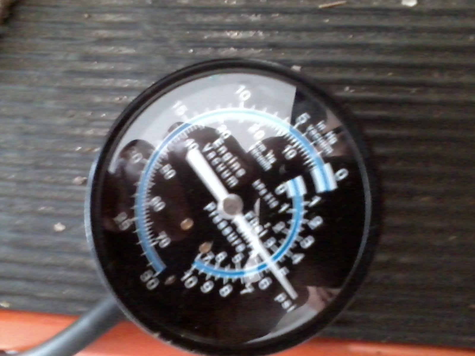

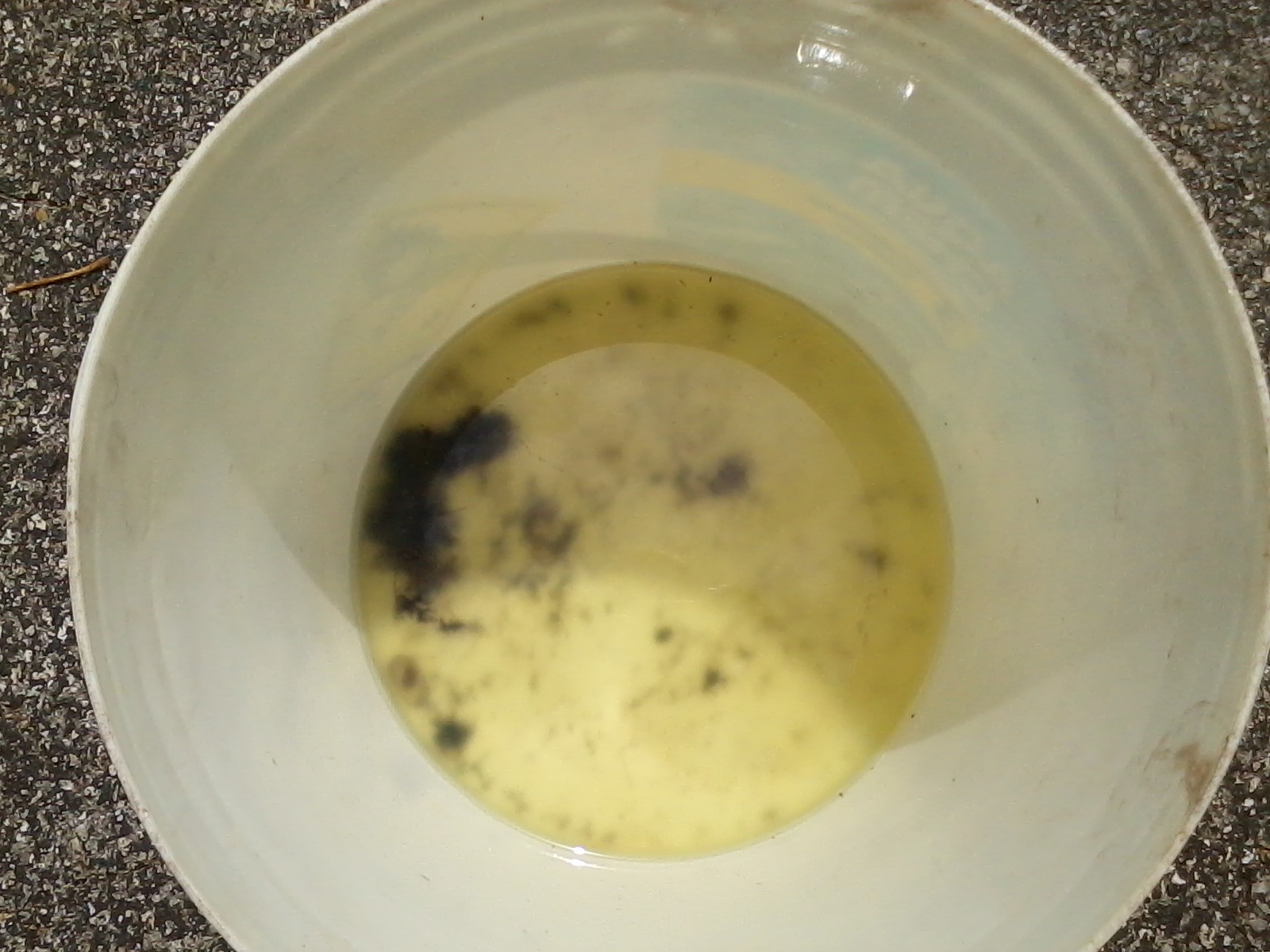

I drained the tank and got a lot of junk out of it so I thought that I was good to go. Even put a vacuum on the fuel line to see if I could get more trash out. Ran some more diesel through just to be sure. Put her back together and started mowing and again in about 15 minutes she started losing power.
Took the deck off again and tested the fuel pump. Pumped good stream of fuel and tested the pressure and it was about 5 psi. Put that back together and went to the last hose before the injector and got good flow there and again about 5 psi. Ran the engine for about 20 minutes and it ran fine.
Next I will blow out the return line as I had a similar problem with a diesel in a sailboat that had a bad return line.
And ideas would be appreciated before I haul her to the dealer? Thanks.
