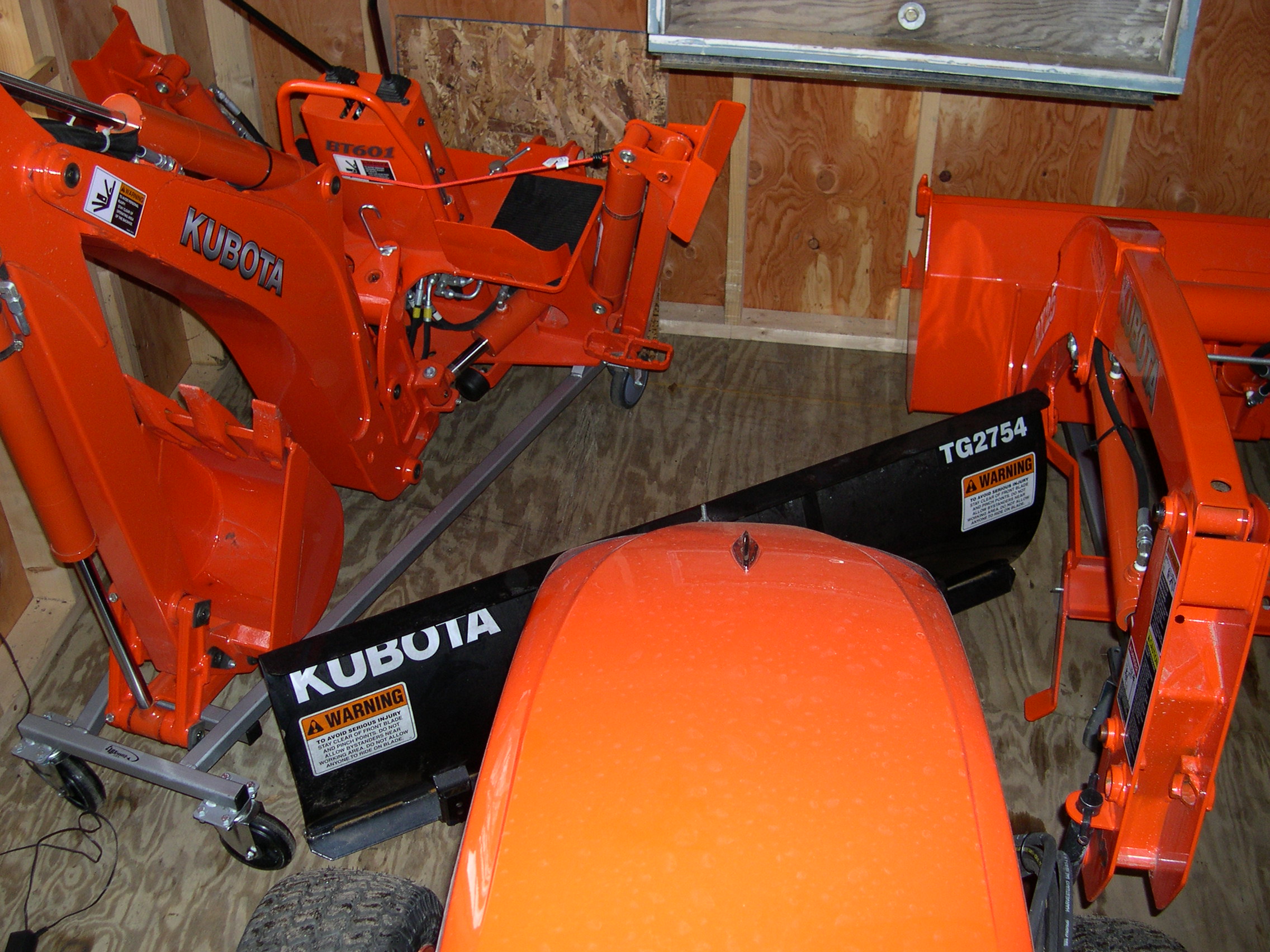

I made a backhoe dolly for my bx24 out of a left-over length of lam-beam & 3 tool chest casters. Cut the beam & bolted it together in a T shape, & put the 3 wheels on the bottom. Was one of those rare projects where everything worked out just right the 1st time, took all of about 30 min & works perfect. Fast on & off, small footprint, & sturdy too.
All wheels need to swivel to make it easy to reinstall, or else you'll need a lot of swing room to line it up.

Could you please post a picture and a couple of measurements? I would like to know the dimensions of the T. I would also like to know the distance from the floor to the top of the dolly. I tried to make a dolly for my BX23. It looks like the one for the BX25 but it does not work very well so I went back to just letting the backhoe set on the floor when I take it off. It would be nice to be able to move it around.

I'm out of town for the weekend, I'll be sure to post the dimensions when I get back. Not sure about pictures though, I've got everything packed in for the winter. If I can make a path to roll it out, I'll get some pics up.

Thanks for the response. Don't go to any extra work to get it out for the pictures. I'm sure if you just give me the dimensions I should be able to figure it out. I have some laminated beam left over from when we built our house in 2008 and a lot of castors from over the years. I am thinking I might be able to put something together that works better than what I already did. I am hoping the BX23 hoe comes off more like your BX24 hoe than the BX25 hoe.

Sorry about the delay; I made the T out of a lam-beam I had that measured 1 3/4"x 9 1/4", 7 1/2 feet long. I cut 3' for the width & that left 4' 6" for the length. If you have something slightly shorter around, you could get by with less length if you stack some 2x boards to reach the bucket in the higher position. Bolted it into a "T" with 4 carriage bolts.
The front casters are from a tool chest, 5" wheels with a overall height of 6 1/4". The rear is slightly smaller, but that works out because the rear board is bolted underneath the cross. All 3 swivel for easy installation. The height of the wheels added to the thickness of the lumber gives the dolley an overall height of 8". Seems to be just about right for my bx24, not sure how those dimensions will work out for your machine.
The stiffness of the lam-beam, combined with the large diameter of the wheels makes it much more stable & easy rolling than some of the other options mentioned, especially if you have a rough floor.
Hope this helps, let me know if you need any other info.

Thank you for your response. I am going to try and make this one when I have a chance. The rough floor part is especially appealing to me as our barn is an old tobacco barn with a dirt floor.
