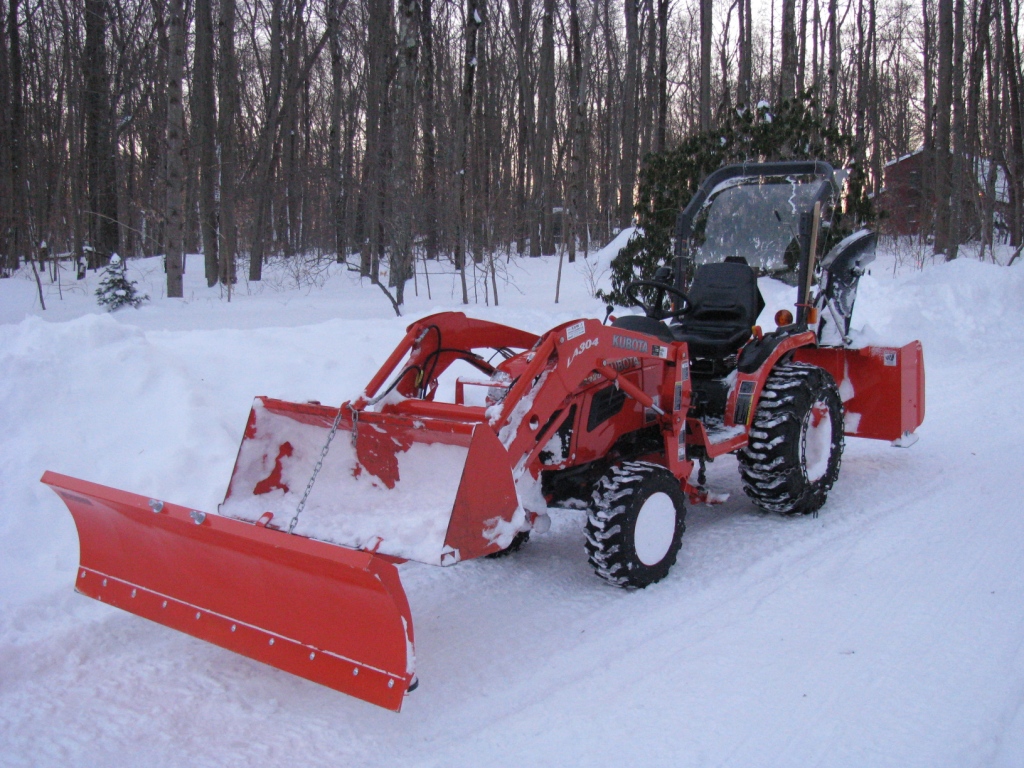

I have a bxpanded plow and I really like it. I use it for the typical 6" snowfalls that we have. It is quick and convenient.
For the 12"+ snowfalls I use the Kubota PTO Snowblower. It is slow but awesome.
The plow gets a workout on my 1/4 mile driveway. I do have the shoes to keep it from digging into the gravel. I like the way that I can quickly and easily take it off when I get to the end, clear out around the mailbox, put it back on and then head back home.
I think it is a good product with good customer service. I did have to modify the bracket that attaches at the top of the bucket. I also added a safety cable to keep it from "nosediving" if the chain that allows it to follow the terrain comes loose.
