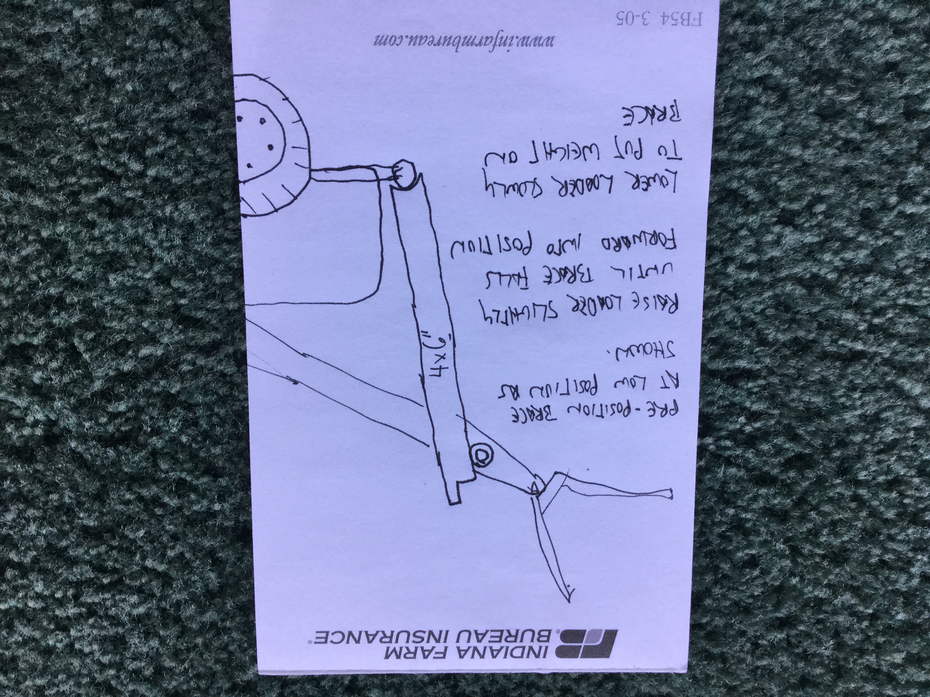

Another way to do that is to use a 4x6" timber as a brace between the tractor's front "bumper" and the FEL's cross tube. No scratching or concentrated load. Centered under loader's weight.

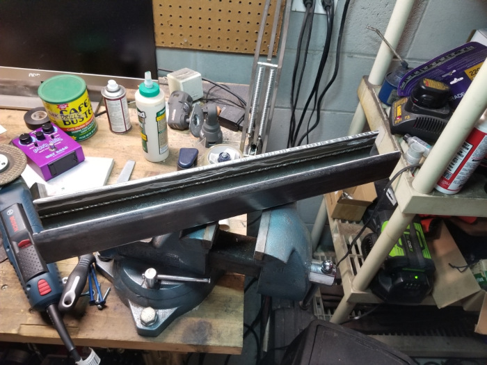

Use a rectangular tube that, with one narrow side removed, will fit over your cylinder rod.
Bruce
   / C Channel for Bracing FEL in Up Position?
That is exactly what I'm working on. The metal place didn't have any channel deep enough, so I cut one side out of a tube using plasma. Unfortunately, I had not used the plasma cutter in over two years, so there was a lot of bubbafication before I got the settings right.
