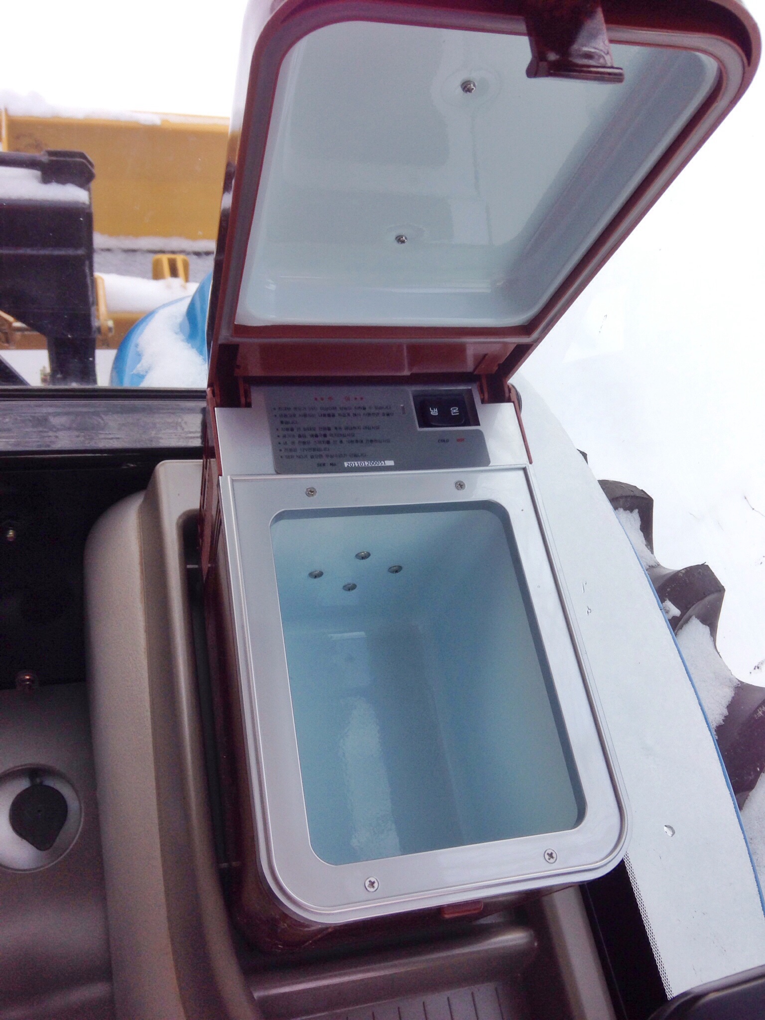

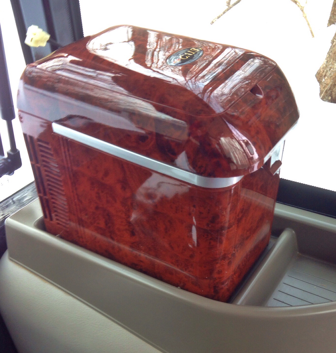

How about a cooler/heater. LS makes one for the P series and it works very well but carbonated beverages are problematic. They get shaken AND stirred on a tractor!
