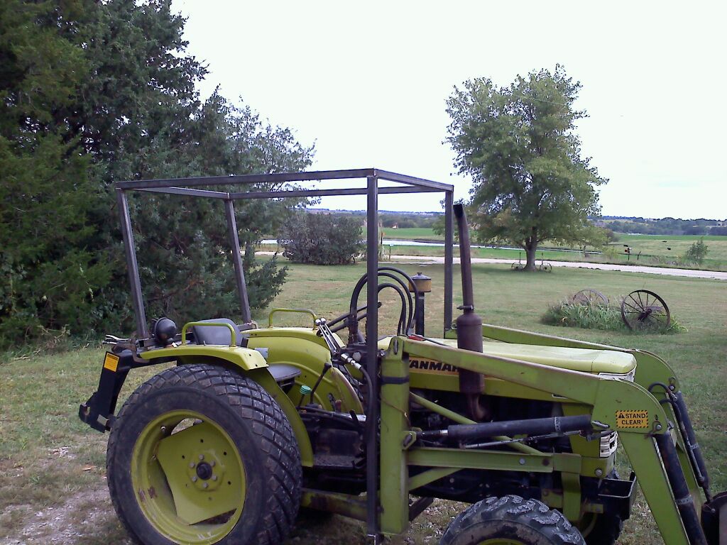

Its been a while since I've gotten a chance to work on it, but I have the major frame work done. I used 1 1/2" square tubing (it actually didn't cost as much as I thought it would). Later this week I plan to add the door on the left side and frame in the right side. Can't wait to test this baby out this winter!
I am having troubles uploading the photos that I have. I will try to get them posted later tonight.

Couple pictures. I hope to get more tomorrow night.

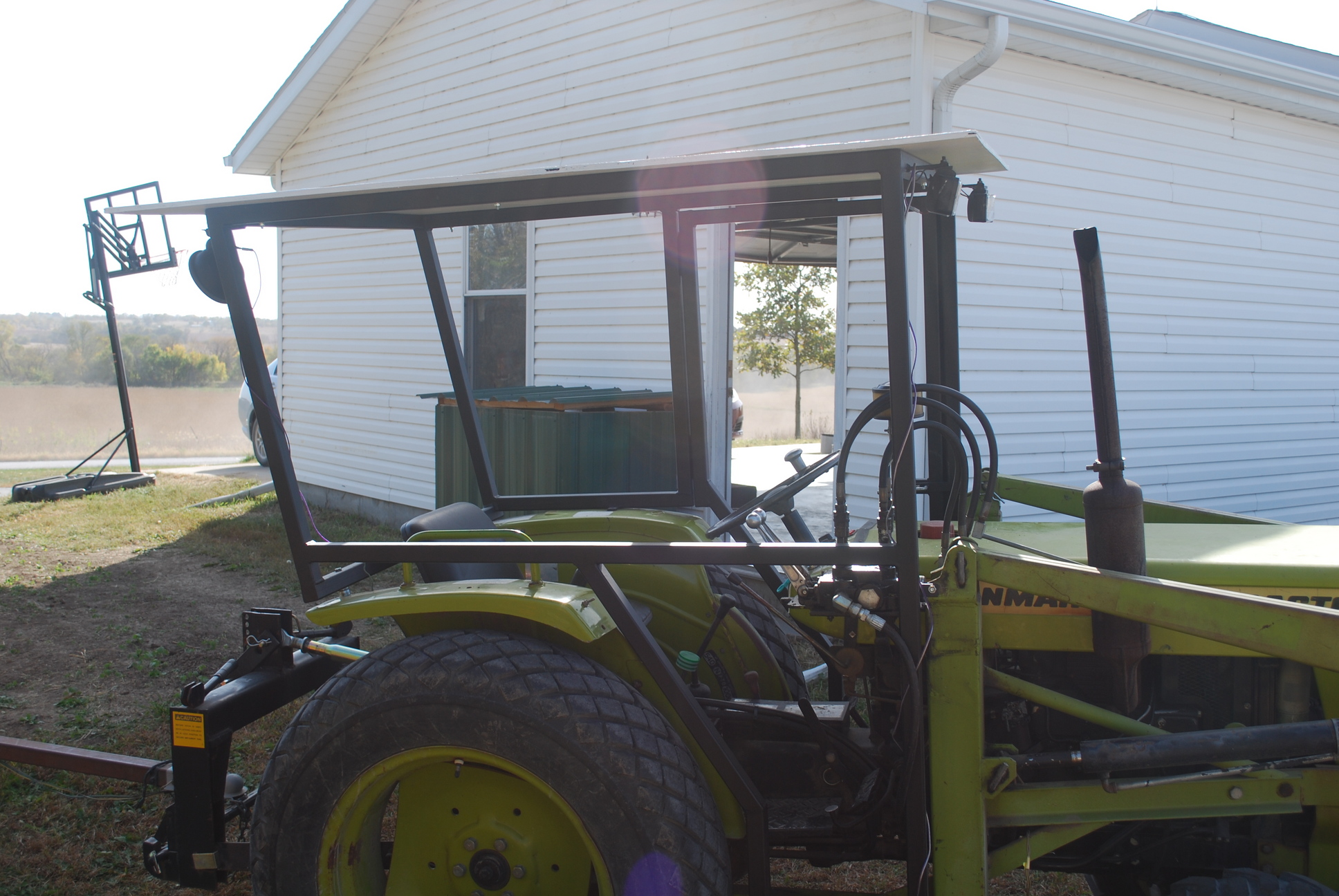

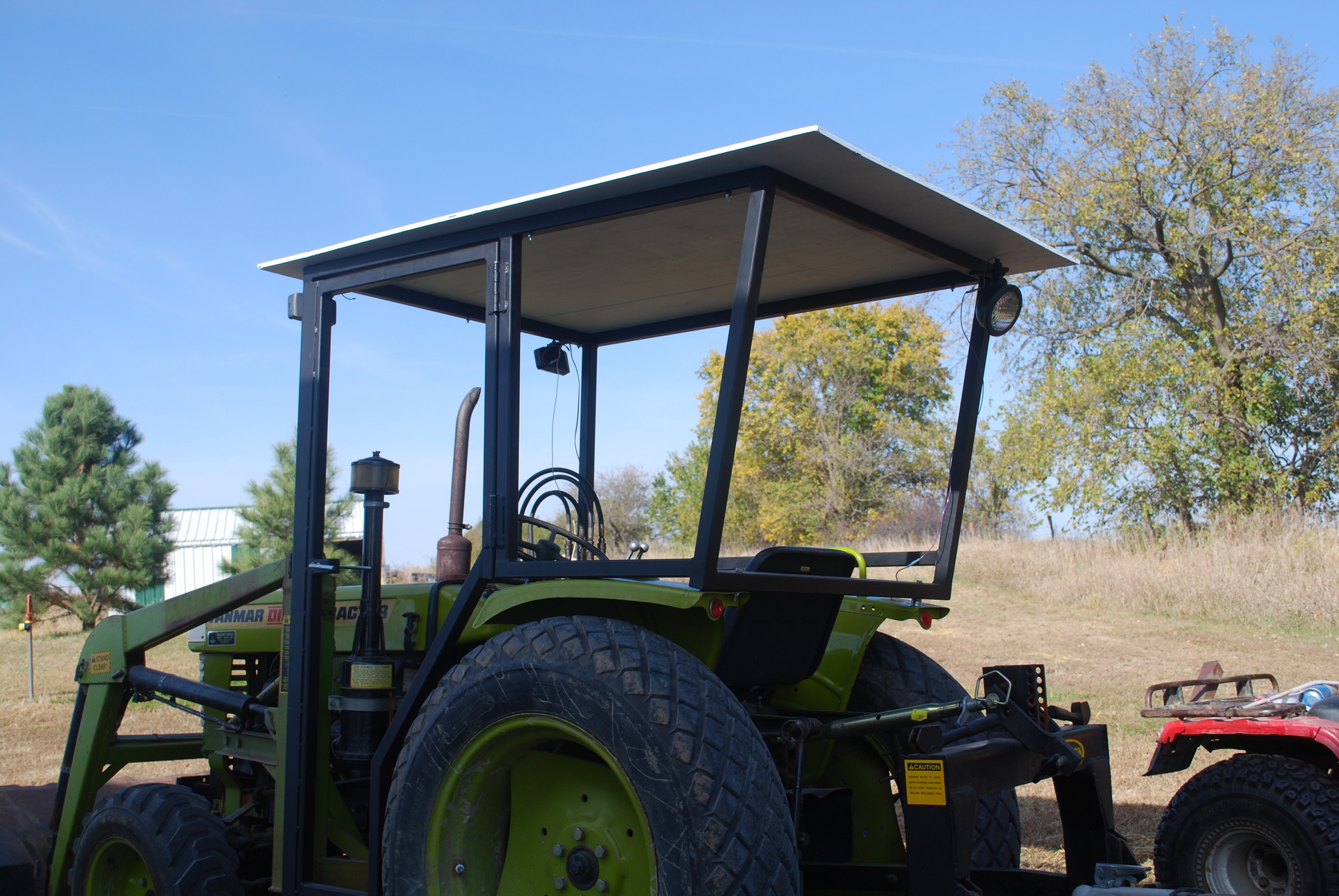

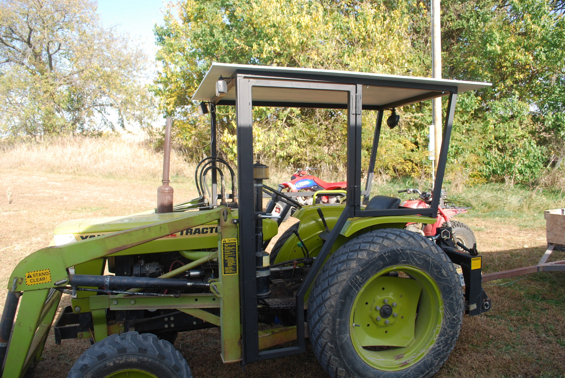

Well, its been a while since I've been on here (sorry), but I have the frame work for my cab all welded up, painted and put on! For the roof, I just used some 3/8" plywood seeings how it will be parked inside all year round. I did put two coats of thick white paint on the plywood to resist whatever moisture does make it on there. I still need to get some Lexan for the windows, but its an hour drive to where I'm going to buy it from so I'm dragging my feet! I found out that a supplier 60 miles away is $30 cheaper a sheet, so if I need 4 sheets its worth my time to save $120!
All in all, I think its turning out pretty good. I hope to get some action pics this winter to post for everyone to see! Thanks everyone for the great feedback!
