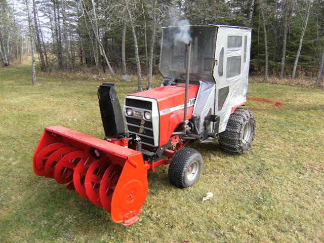

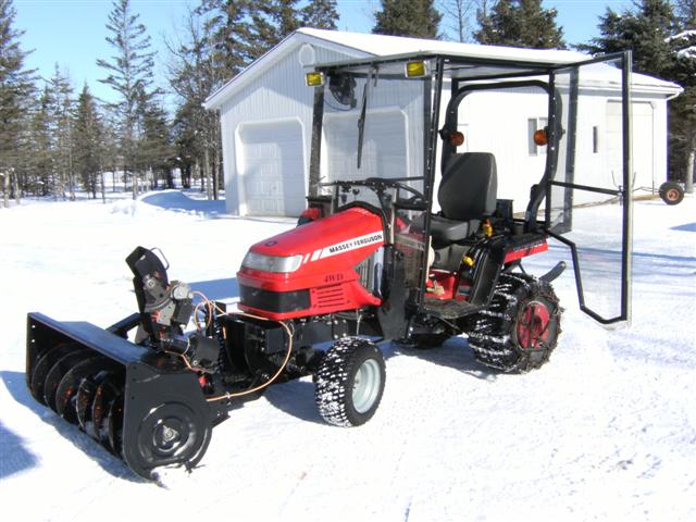

I guess the cheapest is to build your own.The one is built with 1/2" square tubing with tarp for the sides and lexan sewn in for windows[the frt is screwed in place and the other is built with a 1" sq tubing frame with lexan screwed onto the tubing.Larry
