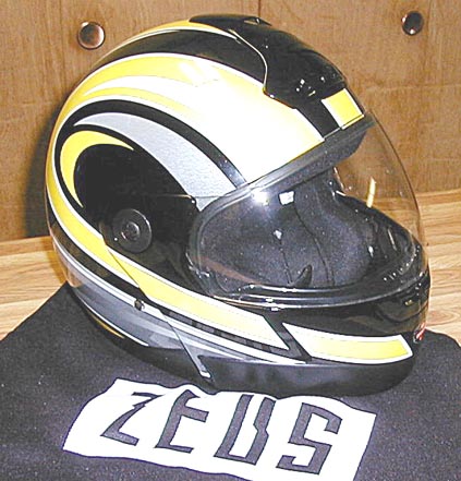

I don't like the confines of a cab when it isn't snow season, and have found this snowmobile helmet to be the best of both worlds for me.
