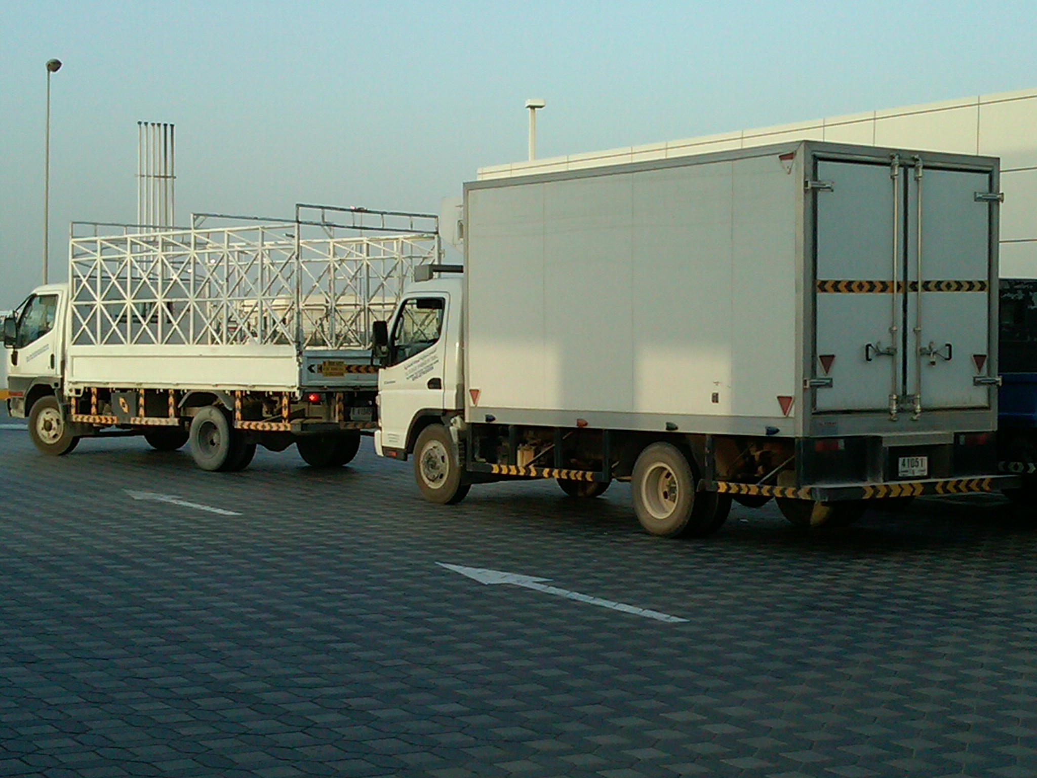

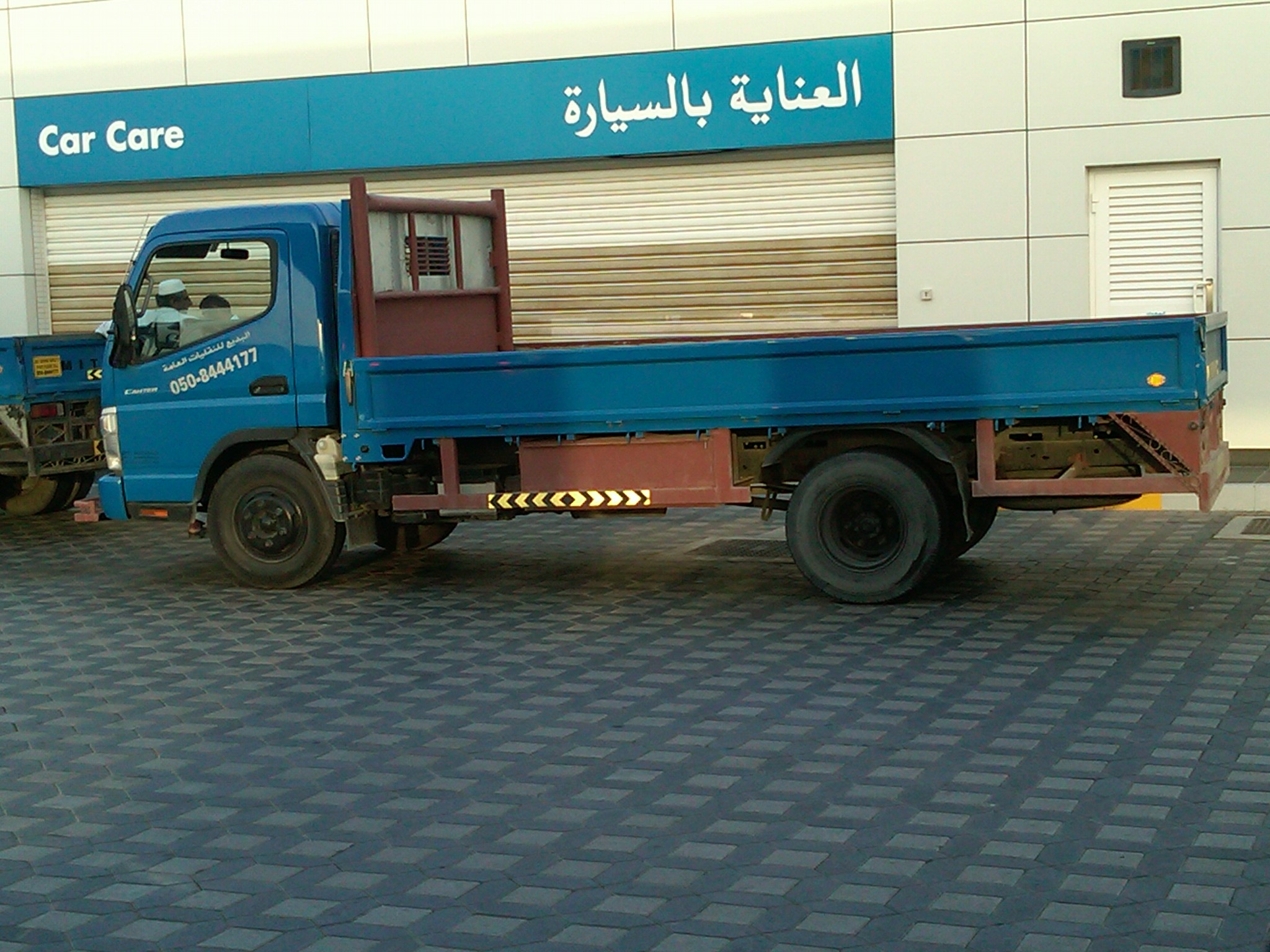

Anyone know why Europe and the Middle East use 99% cab forward trucks and the US is the opposite. Here are a few pics I took last month in the UAE. These trucks come in every size imaginable all the way to semi. They appear very utilitarian in that the bed sides all fold down or are designed for racks to set in. I saw many different ways they cover the bed depending on the load. American style PU's were only driven privately never commercially.
Also their semis appear to be of a higher weight rating than ours. All dump trucks use the cylinder to push off the front of the bed rather than underneath like ours.

Yeah. From what I gather, cab forward makes for a shorter truck, which makes maneuvering in towns much easier, which is more common in Europe.

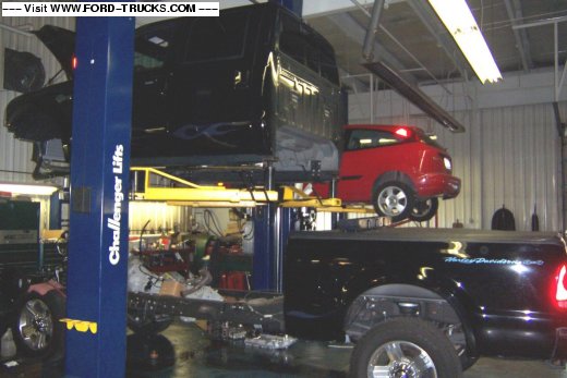

Cab forward is really nice for engine servicing--especially when you consider that some U.S. pickups require the cab to be moved out of the way for things like replacing engine heads.
Maybe something like a Isuzu cab forward commercial cab-chassis with a pickup box installed is the way to go. I frequently see Isuzu cab forward tow trucks offered on eBay. Don't recall seeing any Isuzu cab forwards with pickup boxes on eBay. There's quite of bit of Isuzu input to the GMC/Chevy Duramax diesels so getting service on an Isuzu cab forward probably isn't a big problem.
