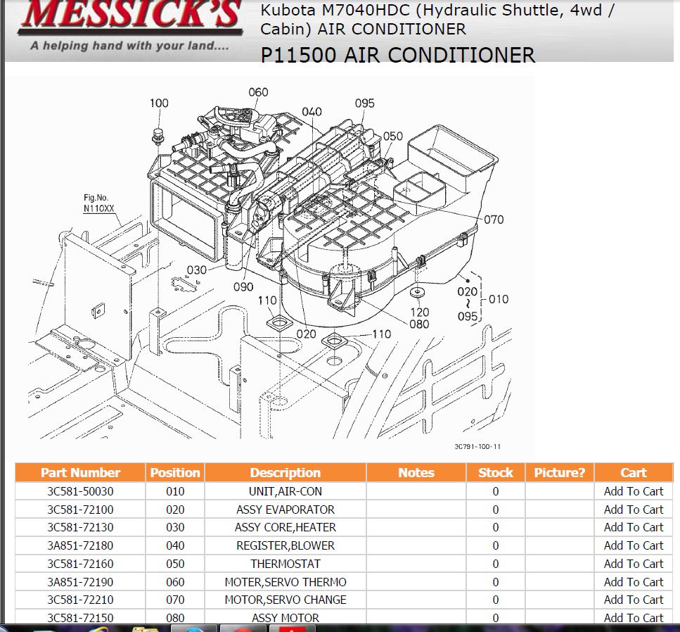

Kubota M7040 heater is controlled electronically IE no cable.
ah, thanks.
i figured it would be like autos. Now he can have issues with servos and electronics. I think id rather have a cable

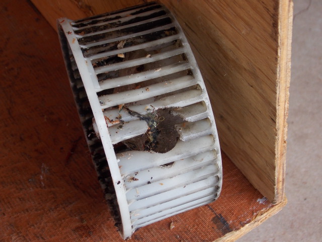

I mentioned mice earlier in this post, because my neighbor just had an issue with the heater in his Ram 2500 pick up. The mice built a nest in his heater fan and also chewed it up. Here's a pic.
The power of mice:

Any help please? My. M7040 kubota. Is not pushing out heat in cab, has been flushed and thermostat replaced engine temp is normal blower works but only cold air.:(
I wrote the piece on the Orange Tractor Forum dealing with the M7040 heating/AC system Take the time to look at it with the pictures. In simple terms there is a air flow management system under the driver's seat. A flap in the cab air flow is controlled by an electric motor to direct the air flow over either the heating coil or the AC coil. The temp knob controls this motor's position and hence the temp of the air delivered to the cab.
Look at the last post in this link M7040 Cab heater ??? - OrangeTractorTalks - Everything Kubota
