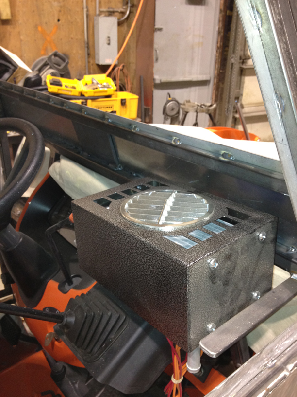

I bought a heater that runs on the engine coolant. An electric heater sized to match the advertised output of 20,000 BTU's would take approximately 488 amps at 12 volts if I did all the conversions correctly.
Cost was only around $150 and it was a snap to get into the lines at the t-stat bypass. There is a small rubber hose 90 degree bypass fitting with a 5/8" connection on one end and something smaller on the other. It worked well to leave the 90 connected to the block and spin it around and use a double ended 5/8" coupling for the one hose to the heater. The other 5/8" heater hose is connected to where the 90 was disconnected. Since flow needs to be maintained through the bypass, I installed a bypass line with valve in the cab below the heater. If it gets too warm I can close the heater valves and open the bypass valve. Google "AH454 heater" if you want to see who sells them in your area.
I'm still anxious for a blizzard to give it a real test drive. The best test so far was one night when the temp went down to 17*F. After a little running around the cab was comfy with the two-speed blower on low. The picture shows the heater sitting roughly in its final resting place during the cab build.

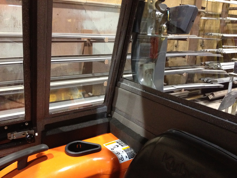

For insulation I used an Armaflex material fastened with contact cement. The cab has a lot of glass and isn't completely airtight so the little bit of insulation is more for aesthetics than function. It's better looking than the back side of the sheet metal panels.
