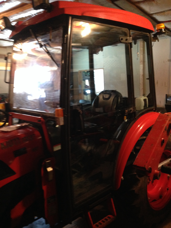

Hello,
I just bought my first tractor ck27h with cab....625 hours.
It's a little beat up cab wise and I'm just wondering if anyone has had luck getting it to quiet down.
I think the cab was put on by inexperienced dealer when it was new and previous owner didn't care....but man it seems louder in than out!
Also no real high on fan so windows are fogging up...actually I don't think there's much heat coming from vents.
Is the front/rear suppose to be plastic or glass?
It was a good deal and tractor seems solid just cab is very afterthought looking.

Is it a factory cab? Not sure if the CK had a factory cab Can you post some pictures?
   / Cab question.....
Yes Kioti cab.... I don't think these are factory installed but dealer installed.
Will get a few pics today.

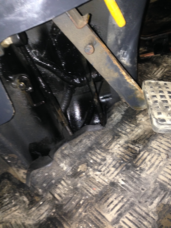

Glue or otherwise attach some cheap carpeting to the inside of the cab roof.
That will kill a whole lot of noise as much is either echo and also perhaps drumming caused by vibration of the larger flat roof area.

Jc8, the cab is most likely a 'Kioti cab' mounted by the dealer. I know my cab was mounted by the dealer. He told me so.
Have you turned the blend valve to the heat position?
Yes they are loud!
All the clear stuff is glass.
Be very careful of the bolts that hold the glass in the doors, they have a tendency to come loose. Trouble is that you cannot tighten them up too much or you will explode the glass. A candidate for red loctite if I ever saw one.

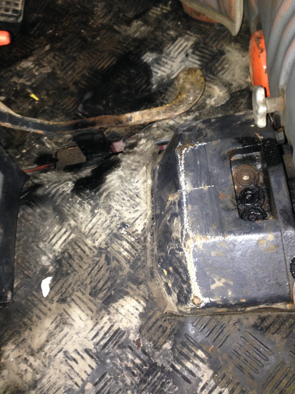

First time posting pics so I hope it works!
Seems like there's a gap everywhere!
I think the echoing might be a large part as well.
The carpet idea should work great.
I think the unit I bought had a rough life, the front and back windows are plexi glass.( did a good job so I thought it was factory!) The front and back I thought that might be from factory until above post.
I knew the left door was broken when I bought it and the owner made a plexi glass wood panel that didn't open.
I got a good deal on it and everything seems cosmetic.

I did quite a bit of soundproofing on my cab. My tractor is pretty much the same as yours with the bobcat brand on it but my cab is made by cozy cab. I have a soundproof liner in the ceiling that helps tremendously it was a factory standard feature. I also added half inch thick by about 1 inch wide weatherstripping everywhere I could. One of the largest helps that I did was spraying sound deadening undercoating under all the fenders and under the seat area. I also purchased some sound deadening flexible denim panels from Menards. I put about six or seven of them throughout the tractor screwed one to the back of the seat couple more along the sides of the seat and so on. I also added memory foam that I took from an old pillow and stuff that in all the small openings. I tried using some of the soundproofing rubber adhesive panels didn't notice much of an improvement from them. It is still louder than I expected inside but it's not bad. I remove my doors in the summertime and sound is no longer an issue.
