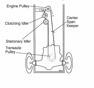

Like this eh?

by the time you get the manual clutch working IMO, use a electric clutch, watch on craigslist or ebay and if need buy a junk riding mower, with a blow engine there nearly a give away item,
I have built a number fo things and have "saved money" and spent a lot of time saving that money, and one of my creations, at times when disengaging it the belts will jump off the pulleys, and at times depending on the resistance, (powered wheel barrow) it releases but still wants to move, (this is a modified lawn tractor drive clutch), so I did not design the clutch system,
on my gas powered air compressor I did use a centrifugal clutch to help it start, and works well, (few engines one can not vary the throttle),
   / Cable or electric clutch for a small engine? #14
The way the Honda Harmony mower prevented the belt jumping off the driving pulley when disengaged was to have a couple brackets (i.e. guides, bent metal rods) that almost rub against the outside circumference of the driving pulley. They're maybe 1/4"'-1/2" away from the pulley, close enough you have to bend them to get the belt on, but enough free space that belt comes out of the "V" of the pulley when disengaged, but cant come off the pulley.
I can't find a good picture, but works well.
