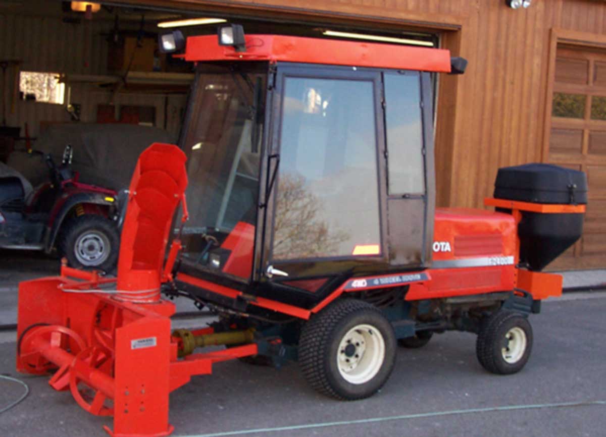

   / cabs and cab heaters questions #5
</font><font color="blue" class="small">( Also if you have a cab heater, how well do they work? Do they keep the windshield reasonably clear? Can you explain how it's connected into the cooling system? Are there adapters that connect into the large upper/lower radiator hoses, or are there other smaller connections off the water pump and engine? How difficult is it to remove the cab heater in summer (quick disconnects)?)</font>
I have a Curtis Cab with the heater installed. I only got it last March so I don't have a lot of experience with keeping the windshield clear but it does throw pretty good heat. Mine hooks into the gooseneck on the engine block and somewhere underneath that escapes me at the moment. It has an in-line shut off for the water for summer use. I'm sure it could be modified for quick disconnect but it doesn't come that way. My cab stays on all the time, it would be a lot of work to remove and reinstall it every year. Hope this is helpful! Let me know if you have more questions of wowld like more pictures.
Bob,
Thanks for the info and great picture of your Curtis Cab. If you've got more pixs available, please post them. A picture of how it mounts on to your tractor as well as the engine-heater hook-up would be great.
If it wouldn't be too much trouble to answer a few questions I'd sure appreciate it. How difficult was the installation? Were any holes needed to be drilled? How sturdy is the frame and does the cab rattle much? Does the cab amplify the noise? Did your existing alternator have sufficient capacity or did you need to upgrade? I guess I've used up my quota of questions... /forums/images/graemlins/blush.gif

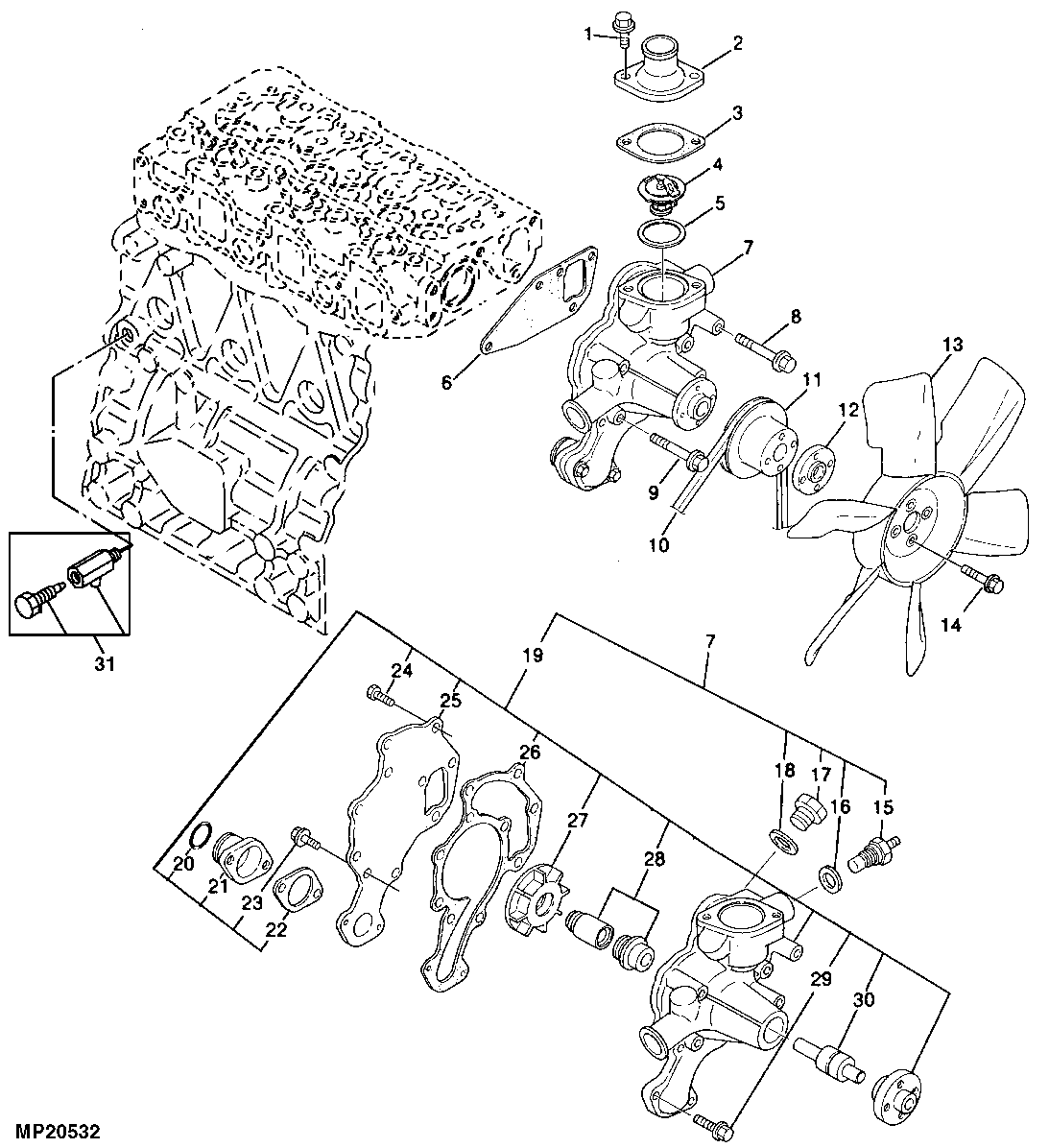

RCH - That's a great idea /forums/images/graemlins/smile.gif. I'm OK with plumbing, electrical and general mechanical stuff (no welding tho...). I was looking at the JC Whitney Auxiliary Heater for $137+shipping, but your solution is sure a lot less expensive.
Did you tap into the large upper/lower radiator hoses with parts from Carquest or somewhere else on the water pump and engine? The reason for my question is my JD790 engine (Yanmar 3TNE84) has an unused auxiliary plug (about 5/8" or so) coming off the top of the water pump (next to the temp sensor/output to the radiator), as well as a drain connection at the back of the engine block (#17 & #31 on attachment). I'm trying to decide which heater connection method to use. /forums/images/graemlins/confused.gif

   / cabs and cab heaters questions #9
Mountian Man,I would plumb into the auxillary water jacket/water pump cast iron ports and avoid tapping into a radiator hose. Almost all engines these days have these ports. Sometimes they are inaccessble tho because of the way the motor is obstructed by other equipment.
That JC Whitney heater takes up a lota space that tractor cabs don't have. /forums/images/graemlins/crazy.gif
I'd put in ball valves on both hoses to the heater so you can completely shut it off in the summer and isolate the heater for repairs etc /forums/images/graemlins/wink.gif Pay attention to the valve for controlling flow- some are on the heater itself, some are seperate in the motor compartment. With a ball valve installed anyway to isolate the heater for repairs or catastrophe you can use that to control flow and go for a compact package /forums/images/graemlins/laugh.gif
