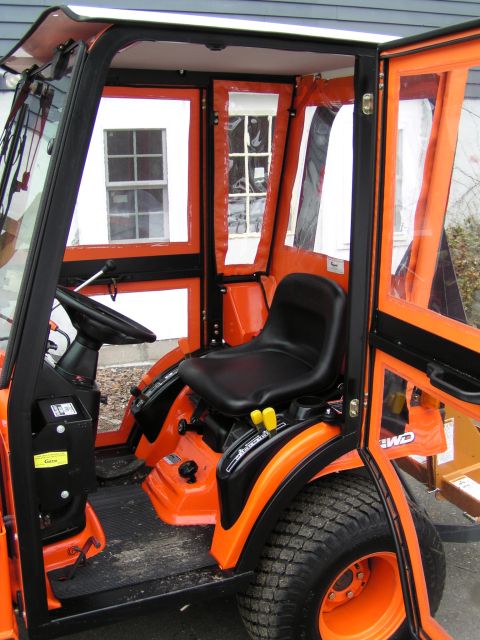

I have a Curtis Cab with the heater installed. I only got it last March so I don't have a lot of experience with keeping the windshield clear but it does throw pretty good heat. Mine hooks into the gooseneck on the engine block and somewhere underneath that escapes me at the moment. It has an in-line shut off for the water for summer use. I'm sure it could be modified for quick disconnect but it doesn't come that way. My cab stays on all the time, it would be a lot of work to remove and reinstall it every year. Hope this is helpful! Let me know if you have more questions of wowld like more pictures.

I will take a couple of pictures of the heater hook up to the engine. Here's a side view of the whole cab.

The dealer installed it. He told me that his crew spends a lot of time on an installation.
</font><font color="blue" class="small">( How sturdy is the frame and does the cab rattle much? Does the cab amplify the noise? )</font>
Very sturdy, although it's not a ROPS cab. I do not notice any rattling but it definately amplifies the noise. I wear hearing protection and it doesn't bother me.
</font><font color="blue" class="small">( Did your existing alternator have sufficient capacity or did you need to upgrade? )</font>
I have the stock dymo on my tractor. It seems to handle the load fine. I have also added lights, though so I may upgrade to be on the safe side.
