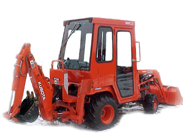

Laurin hasn't changed the cab for the BX series since introduction. The price last year before the steel price increase and the value of the US dollar declining was $3500 US. It is a nice cab and offers ROPS protection for the occupant. This is the only cab that is specifically built for the BX22/23 series tractors. One of the down sides of this cab is that if you ever break one of the glass panels, it is going to cost a fortune to replace it. The door glass is one piece from top to bottom. Lifting the rear glass window out to use the backhoe must be difficult to do also.
