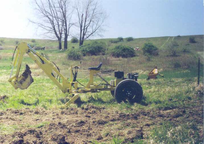

Here is a picture of my cadplans 710 I built a couple years ago.

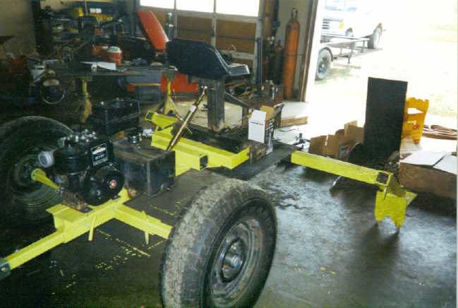

Caddigger during construction.

   / cadplans #14
The 710 model caddigger will separate behind the seat and go on a 3 point like the 708 model.
   / cadplans #15
Vince,
Could you not eliminate the engine and run the hoe off the tractor's hydraulics? Just always wondered about that one.
SHF
   / cadplans #16
Steven,
Yes ,there are 2 pins and a top link behind the seat.
I take them out and unhook the hydraulic quick couplers and the gas engine and axle section will detach.
Then I can hook up to the tractor 3 point and just plug the quick couplers into the tractors hydraulic remotes and run off the tractor.
   / cadplans #17
If you go with Cadplans the model 708 is for 3 point hicth.
The 728 runs off a gas motor,and the 710 like the one I made will run off the gas motor or it can separate to work off the 3 point.
