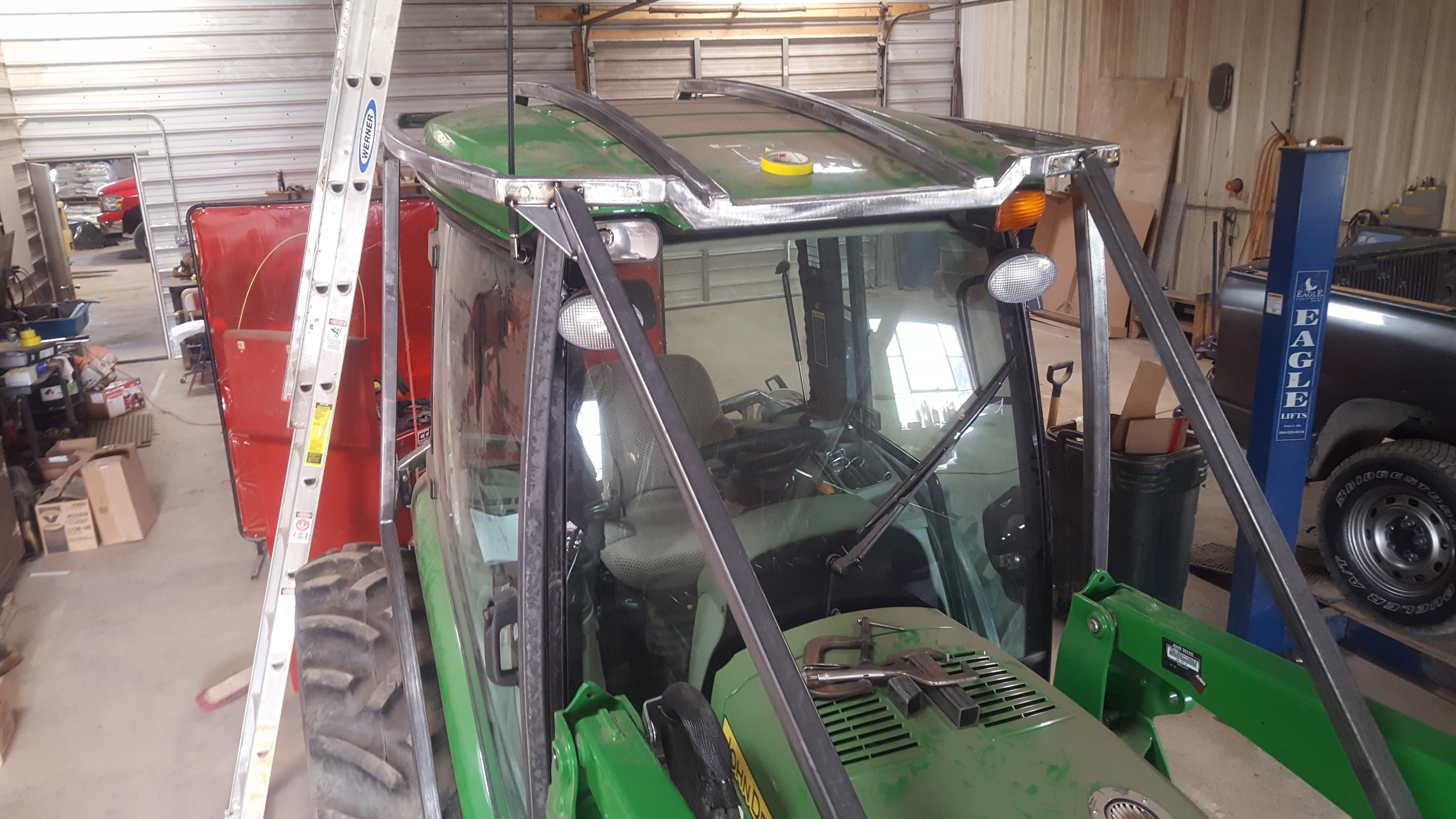

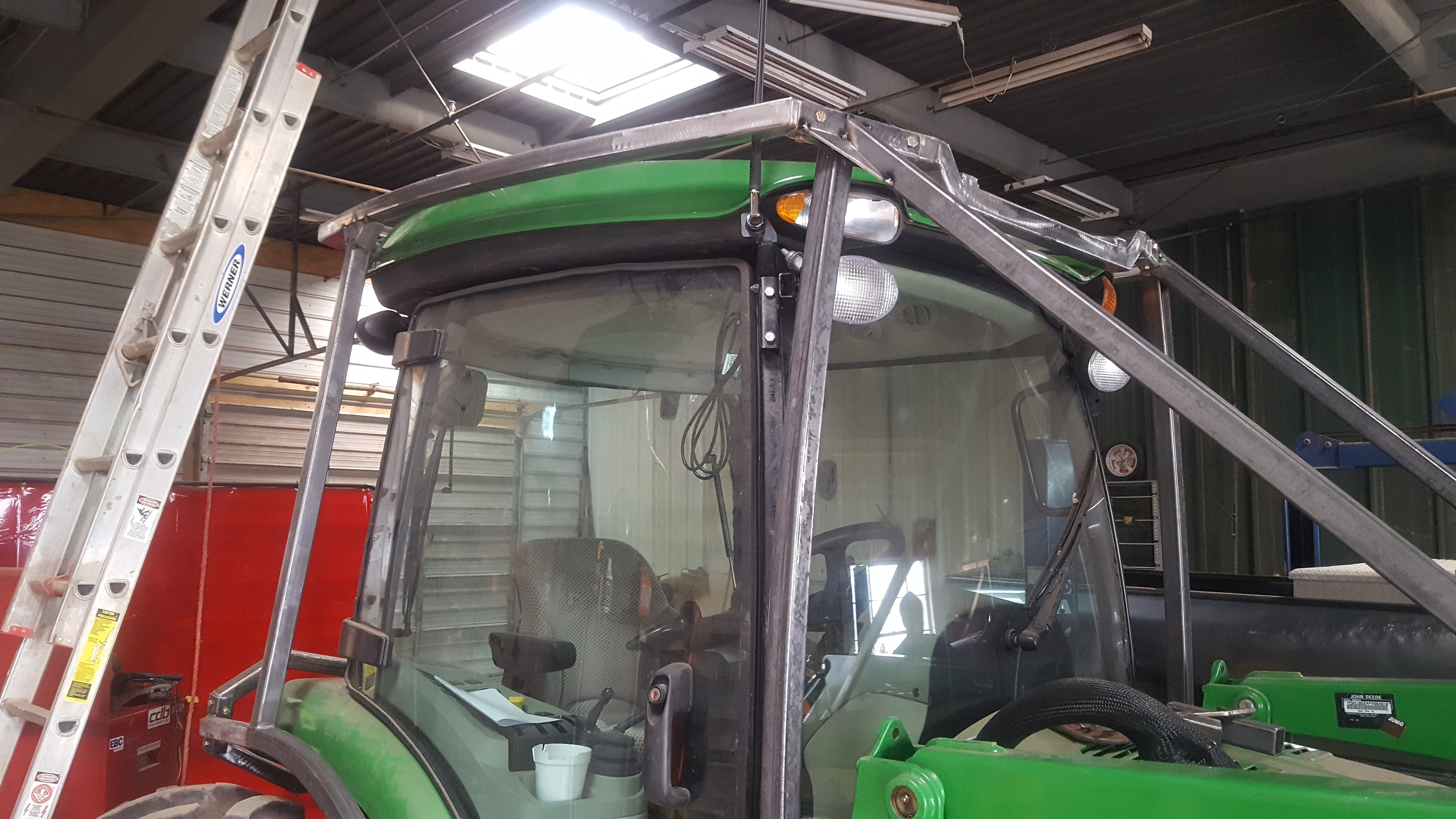

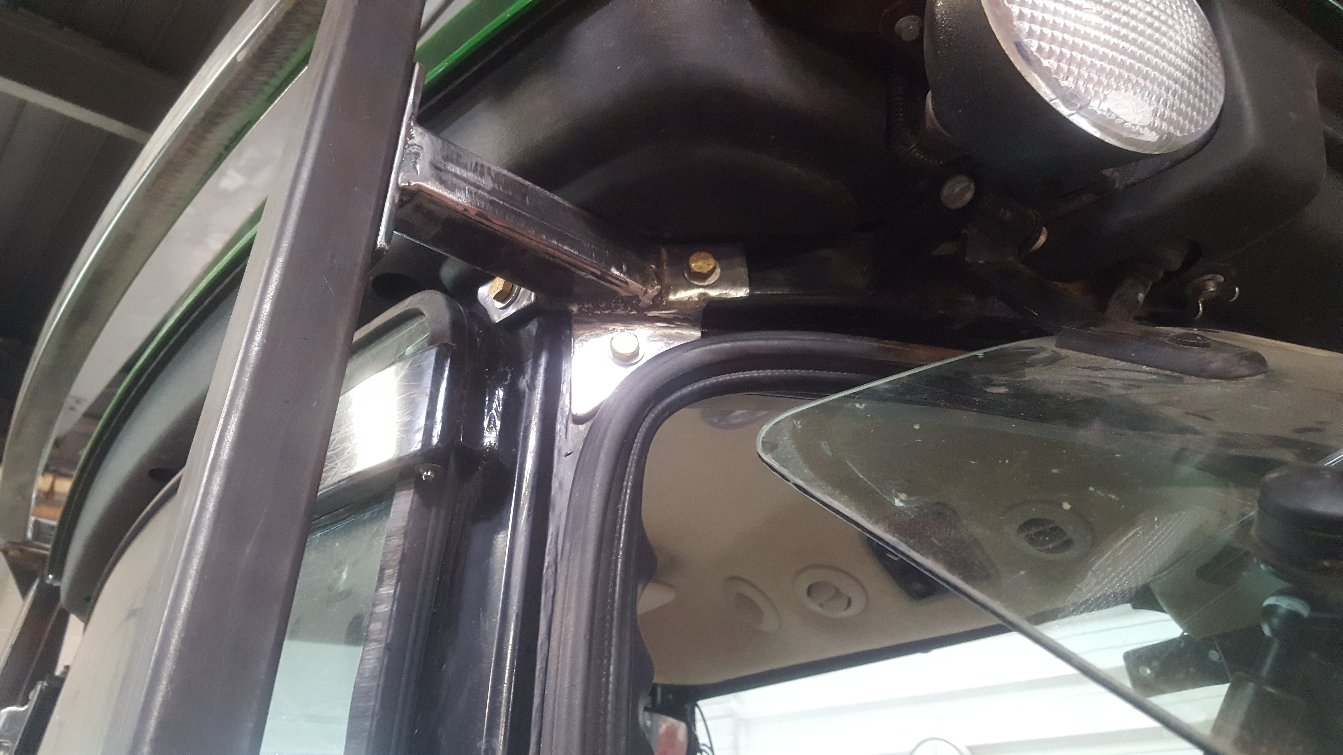

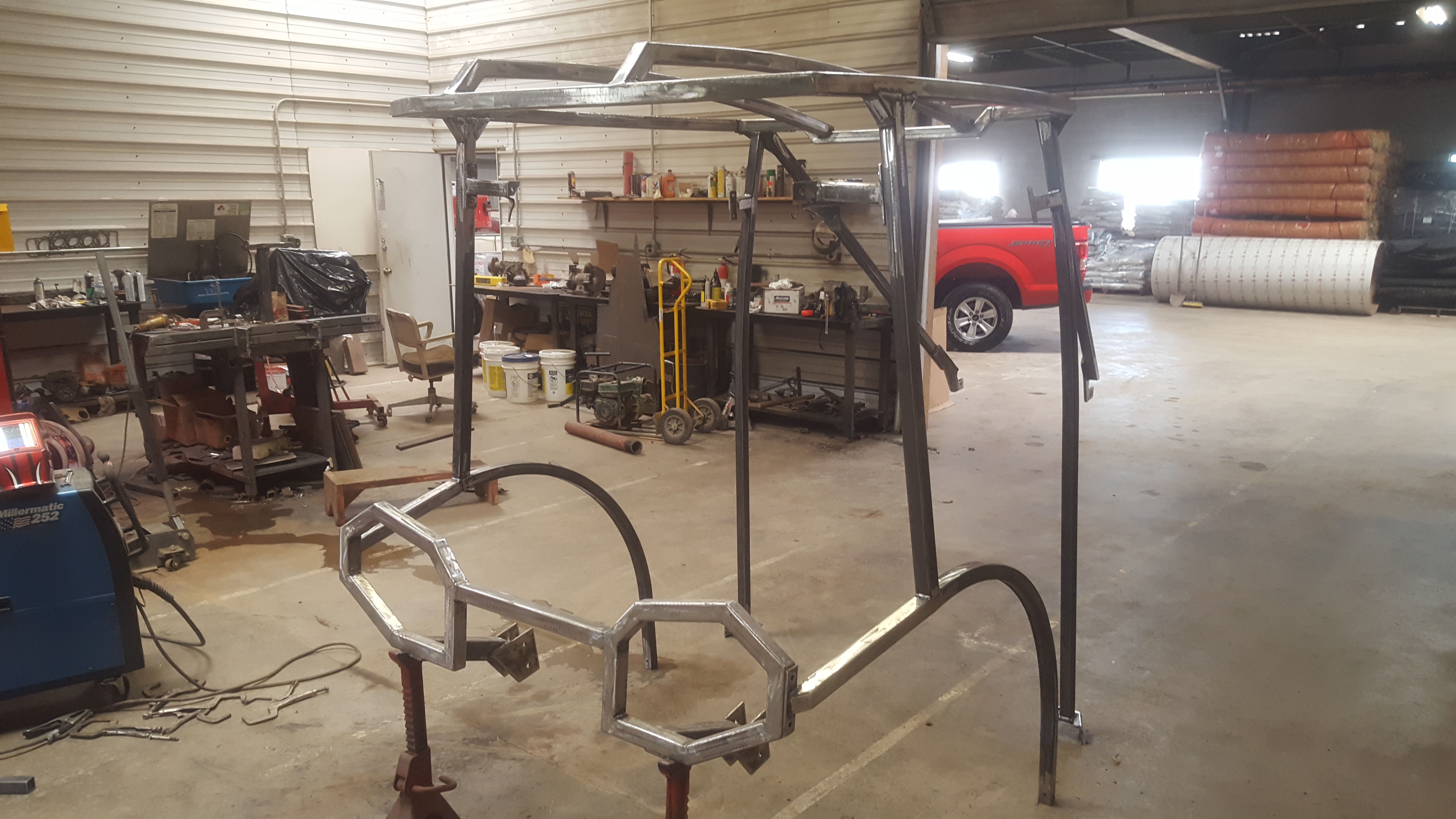

The cage is built for brush protection, and tied into the top of the cab ROPS structure near the roof. I used as many existing mounting holes as possible, but did drill/tap 3/8" bolts into the ROPS at the direction of the tractor owner/my boss. All other points are factory holes. The cage is made in sections as needed to allow installation and removal by 2 people with no ladders. The front risers/cab legs are mounted first, then the main cab cage with rear tail light/fender hoops.
