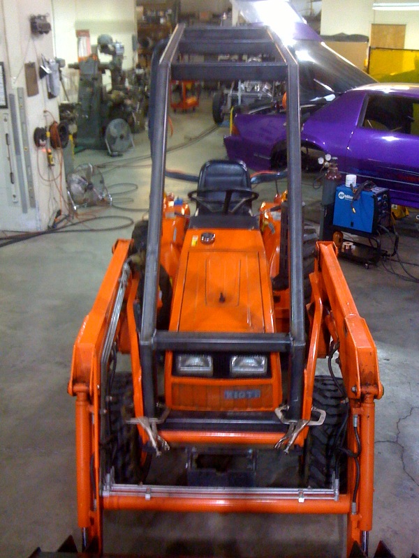

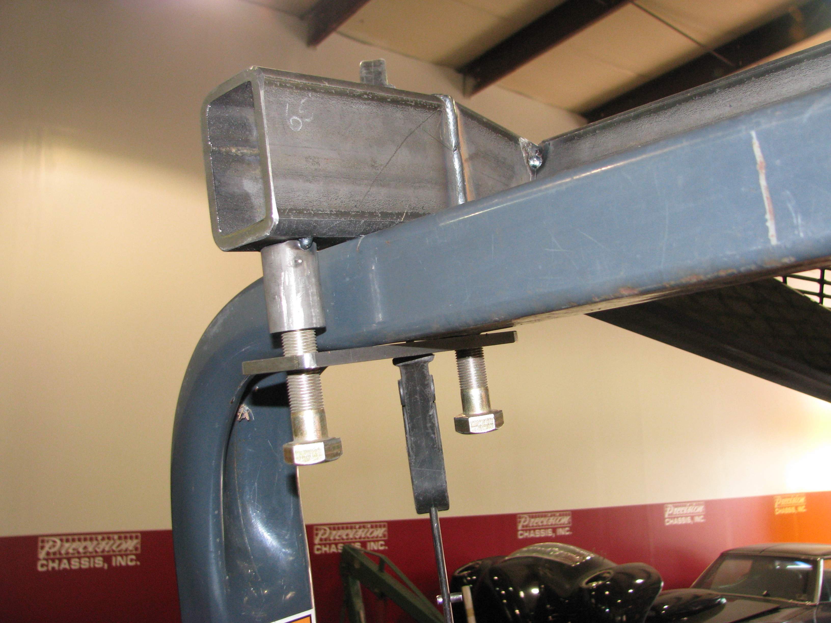

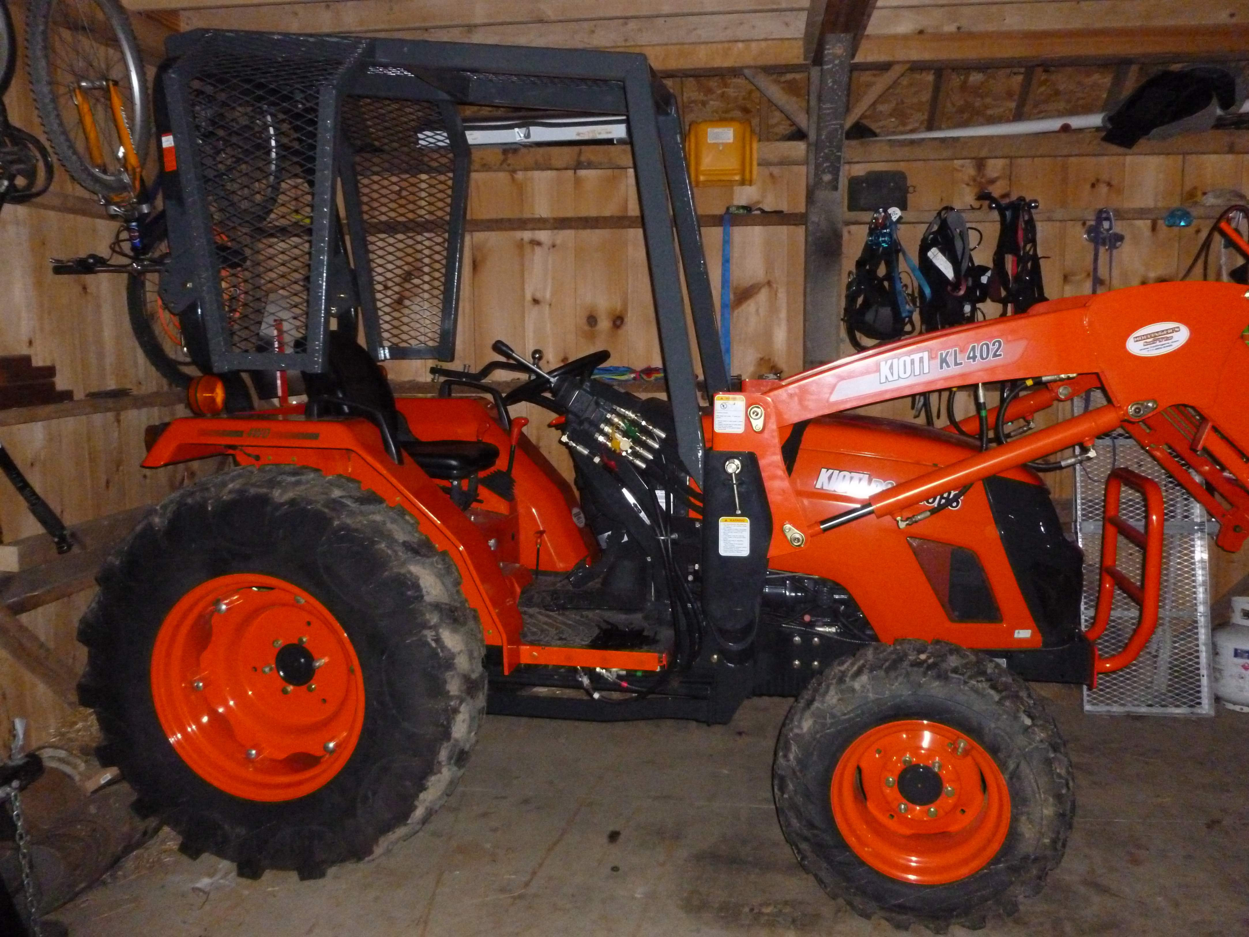

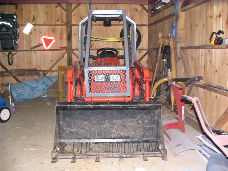

Got some pictures from the shop this morning! side sheilds, rear shield and expanded metal still to come.

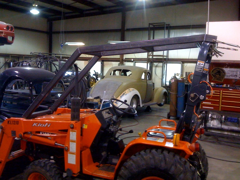

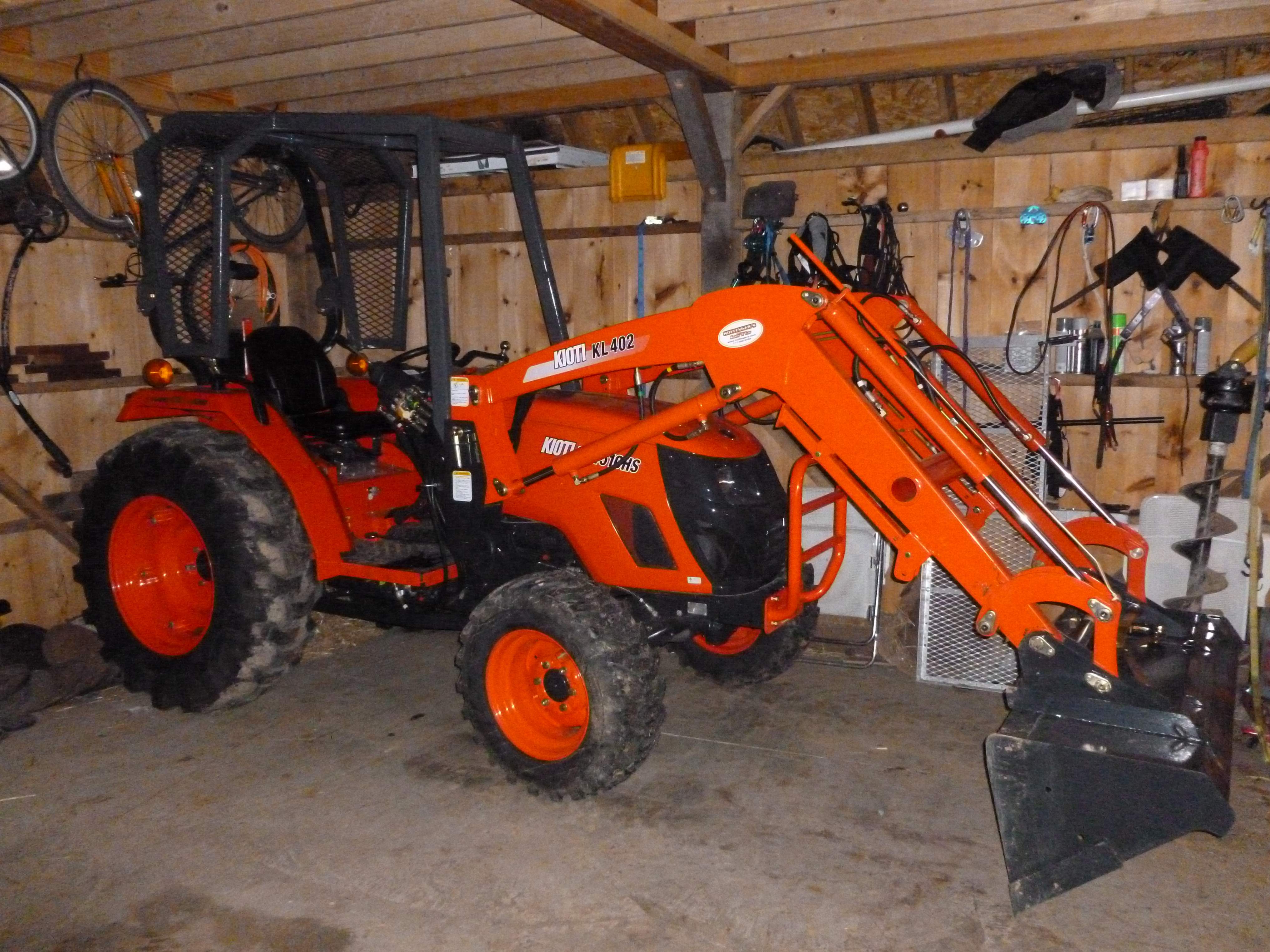

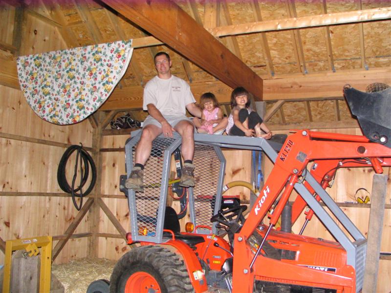

A little more progress and some more pictures!
   / Cage for Kioti LB1914 #14
That's a stout cage. A couple of gussets where the 'A' pillar meets the roof would go a long way towards taking the place of the posts I suggested in an earlier post.
I like the Willy's coupe on the lift in one of the shop photos you posted.
#15
Are you talking about gussets to keep it from racking sideways or gussets to keep it from crushing downward?

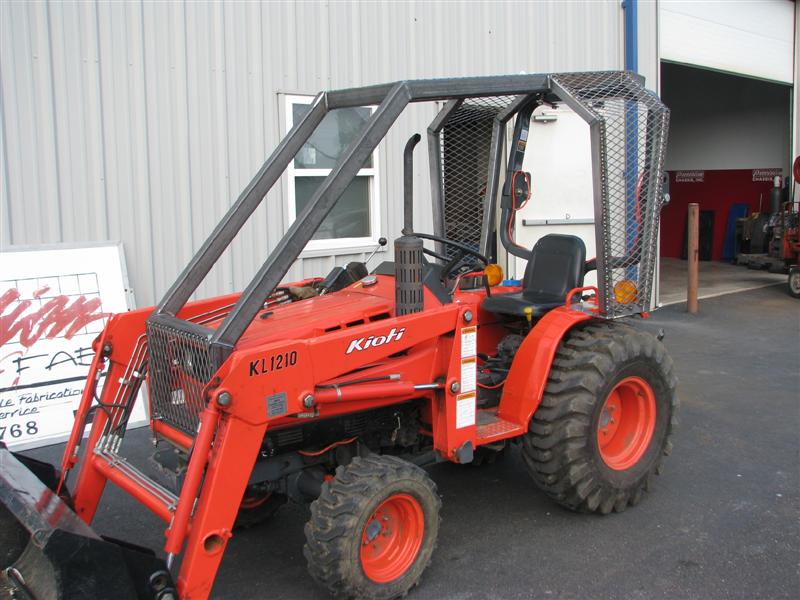

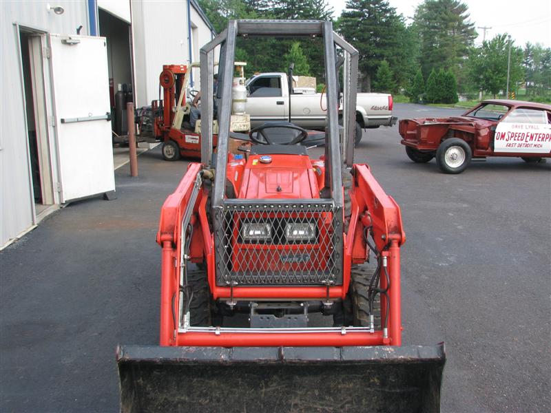

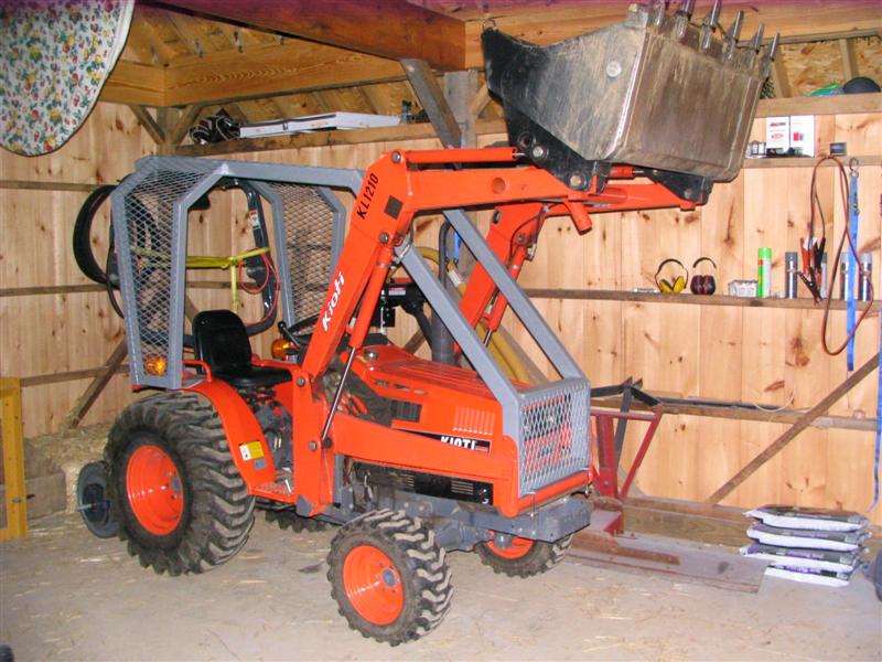

Here are the final pictures (for now). I do want to add side supports from the loader uprights and rear mesh but that is for another time.
