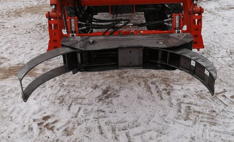

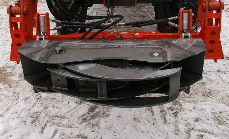

Jerry has not said much about it. Just this from his site.
THIS IS A NEW GRAPPLE WE HAVE BEEN WORKING ON, FOR LIFTING ONLY SEEN WITH OUR PROTOTYPE "AUTOMATIC" TACH-N-GO
