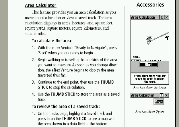

If it is in the open most GPS recievers can calculate the area by just walking around the pond.

As Panache said, using a GPSr is one of the easiest and most accurate ways to calculate area. I have attached a page from the Garmin eTrex Venture (about $130-$140 online) manual that discusses the procedure. Very simple and certainly accurate enough for your purposes.
To my knowledge Magellan units do not include this functionality, while most Garmins do. You can always use a freeware program to calculate area once you record the trackpoints on a Magellan (what I do), but if that's what you want it for, I'd get a Garmin. You'll find lots of other uses for it, too. A great tool for the money.

</font><font color="blue" class="small">( If it is in the open most GPS recievers can calculate the area by just walking around the pond. )</font>
Hey, thanks for the tip. I don't have a pond but I have a very odd shaped horse pasture that I've always guess the acreage and never really knew the actual. I just pulled my Garmin GPS72 that I use for hunting and fishing and walked around the pasture and saved the track. Changed it to acreage and there it is, 2.83546 acres of Kentucky Tall for them two horses to eat.
Thanks again for the tip.
