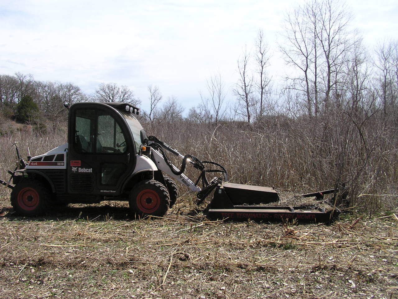

My way of figuring it is: "It's CAN be less than you think it is !"
( Qualifications: Member of the "rolled a tractor while running a bushhog and lived to tell about it" club....and on ground with a very slight slope. )

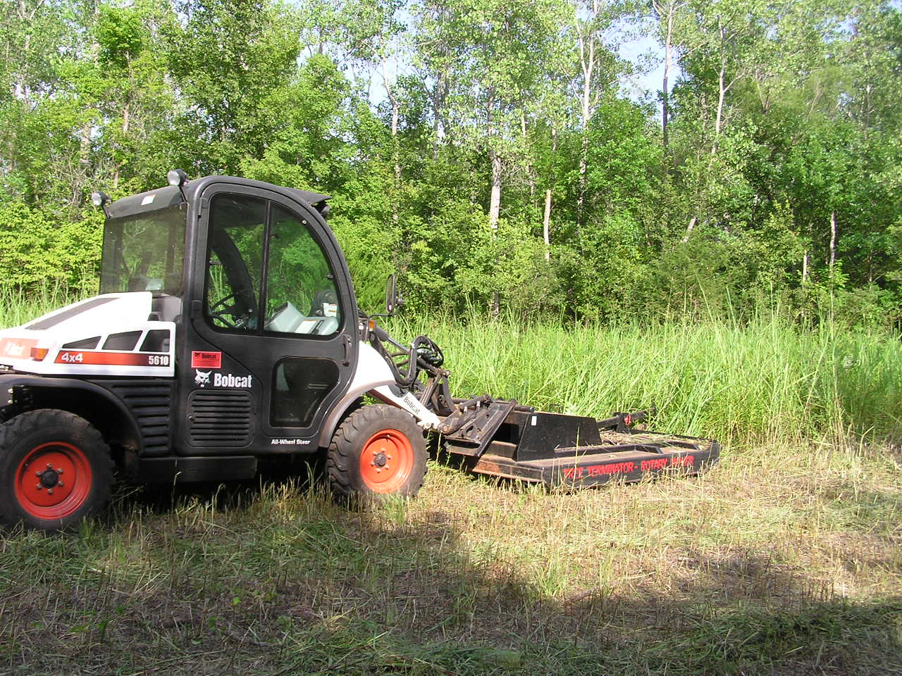

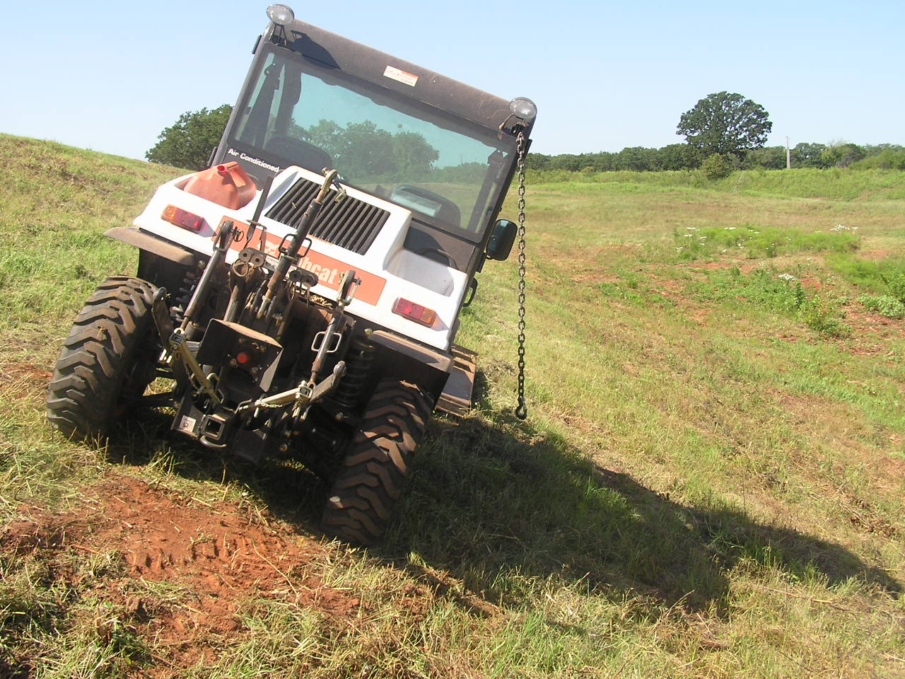

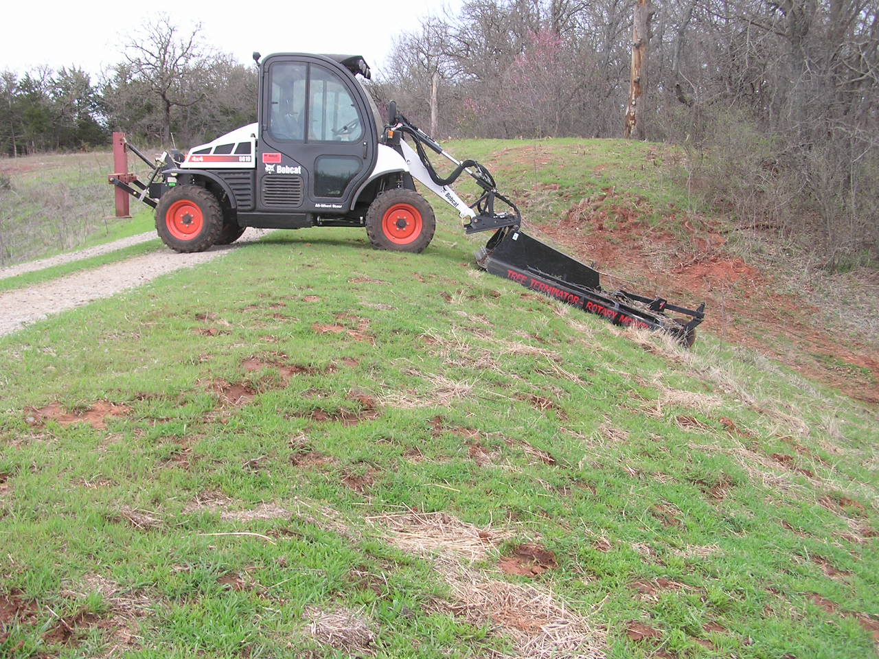

/ Calculating Your Predicted Rollover Angle #4
Some visual reference. The chain shows true vertical.
The 7' brush hog is on the front.
18 degree slope.
26.6 degree slope.
I went there with the Ranger EV. Took the protractor to get a reading of the angle. The straight edge is too short to work on the uneven ground, so I measured the back of the Ranger.
It has a lot of body lean, so the angle is steeper than the 26.6 degree slope.
With eight batteries under the seat it felt very stable. :thumbsup:

After this I reversed the wheels, to make it wider and added 75 pound wheel weights.
Wider tread and wheel weights, from July 2009, with the brush fork.
From last month, to show that it is still running! :D

Just examining the picture after "righting", it looks like you might have just driven out from under the CoG.
High chain and all. The slope didn't help, but from the photo, it does not appear to be sufficient to cause over turning.
Looks nasty too, you are fortunate not to have been mained or drownd!
