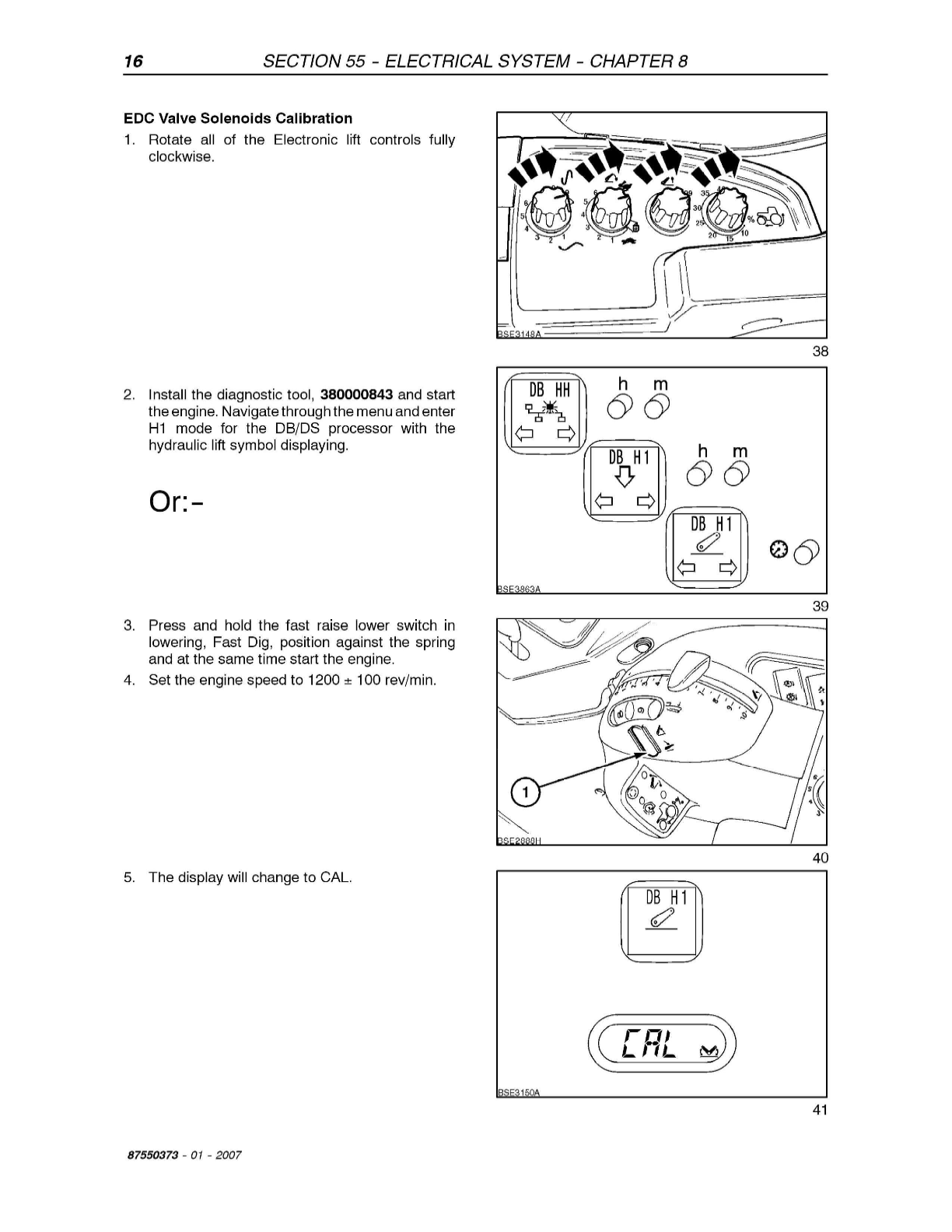

Calibration rear Lift New Holland T7530 2007 mod
   / Calibration rear Lift New Holland T7530 2007 mod #1
Bjørn
Mar 25, 2023
12
New Holland T7530 2007 model
How can I calibrate rear Hitch on my New Holland T 7530 ?

I have the Service manual and the operator manual but its not explaned how to calibrate.. I hope there is someone could send me the procedure😊
   / Calibration rear Lift New Holland T7530 2007 mod #5

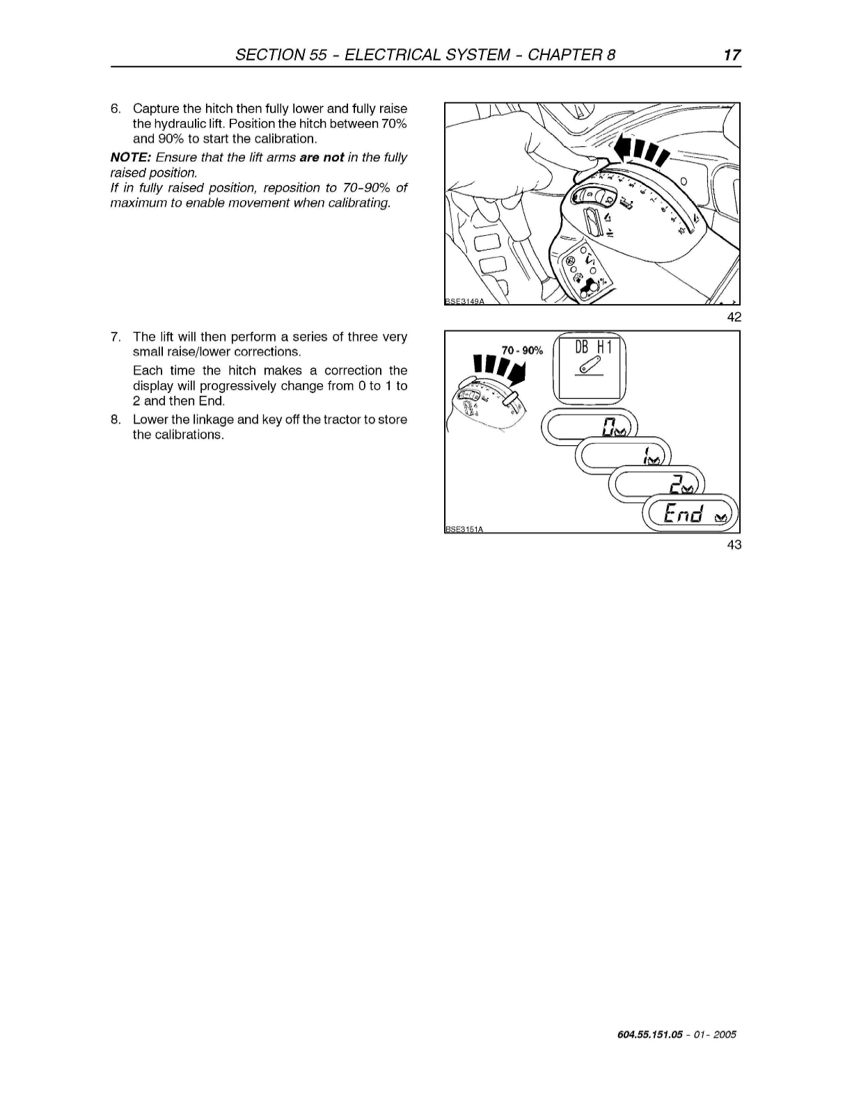

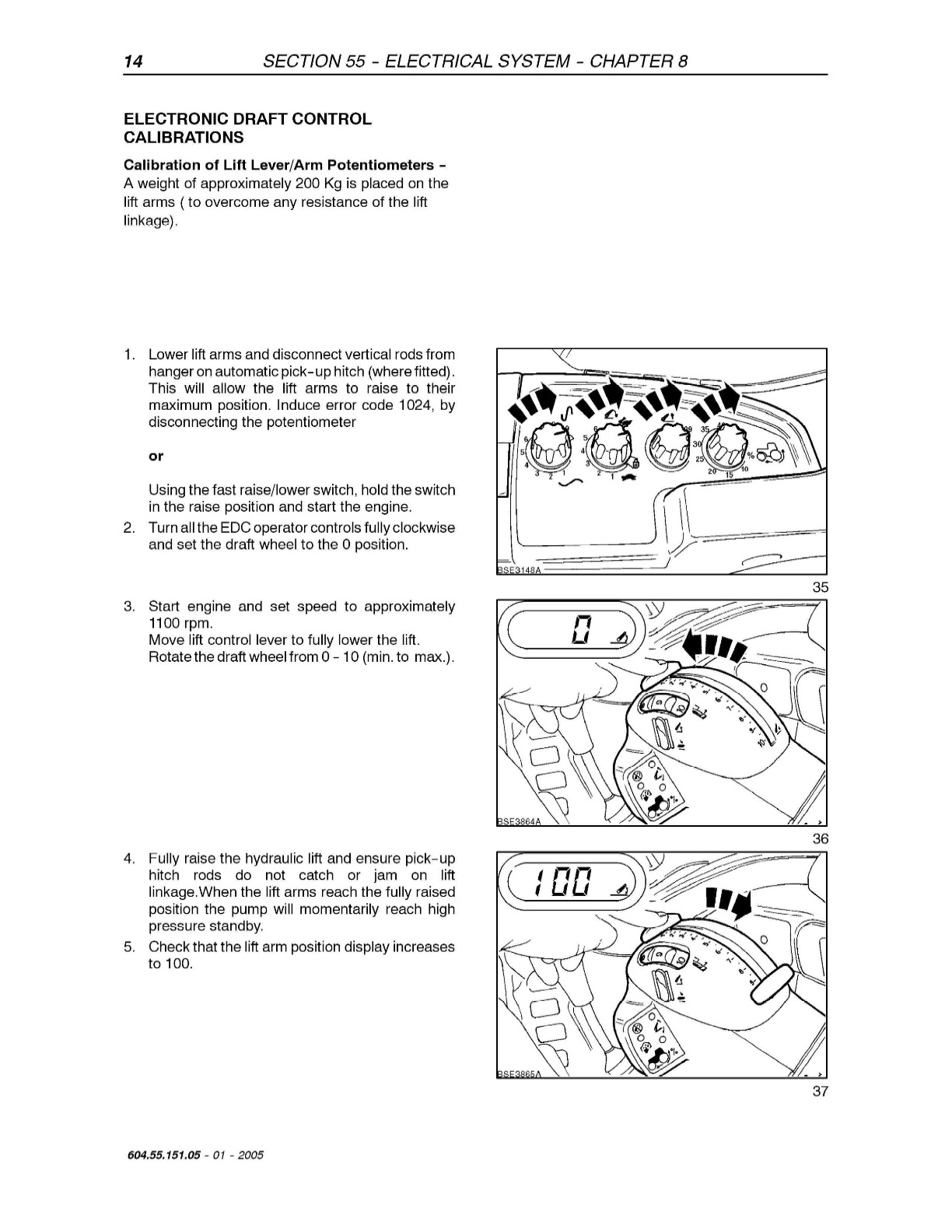

This is from the T6050 manual, it may help? The calibration procedure was buried in the back of the electrical section

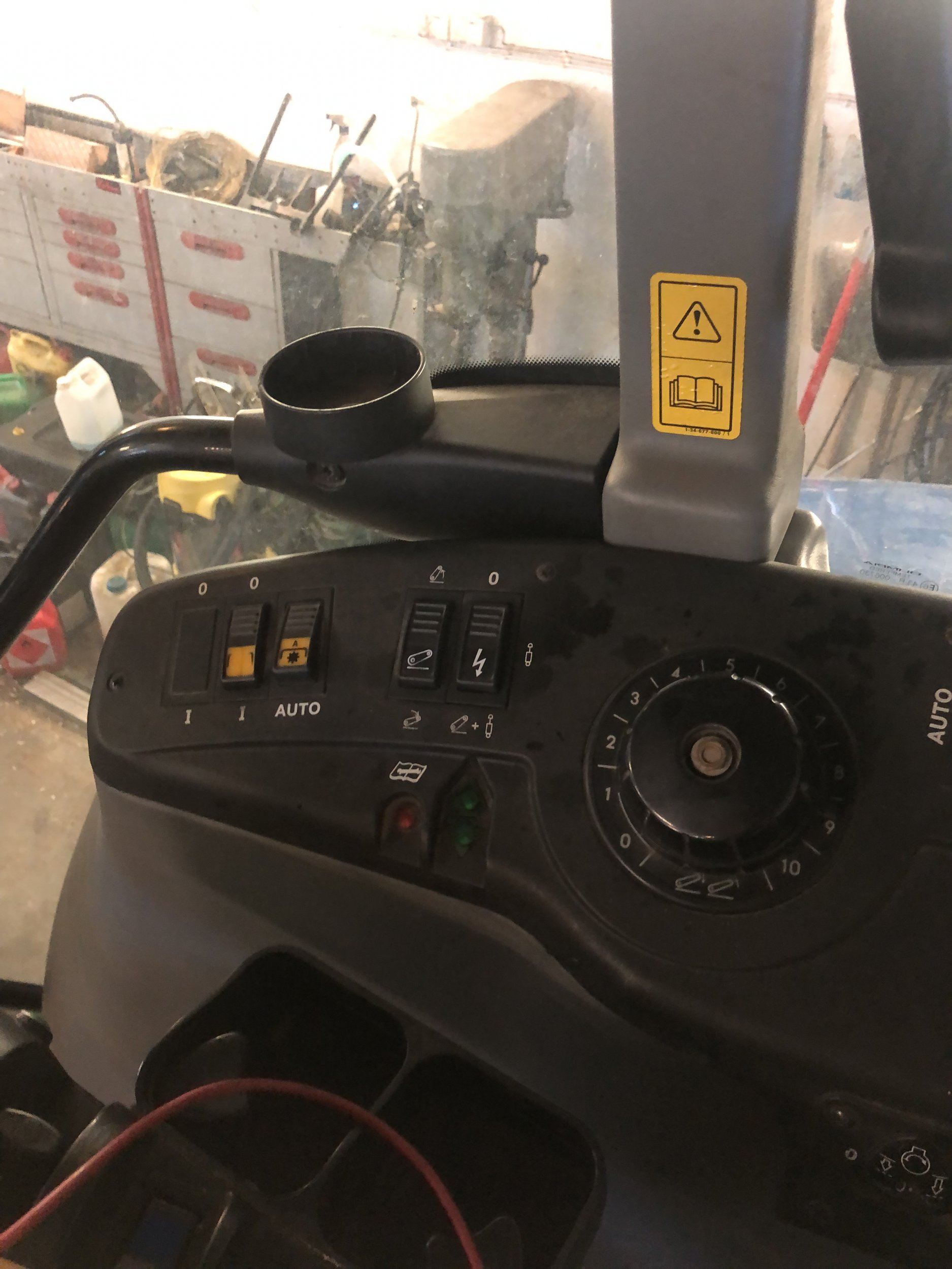

Hi Again :) I tried to calibrate when using yours procedure but it will not came up with this Cal mode.
It is a bit different from yours Tractor . Do you think it can be done by using Diagnostic tool ? Thx for your help :)
   / Calibration rear Lift New Holland T7530 2007 mod #8
Should be but the steps and procedure may be different.
