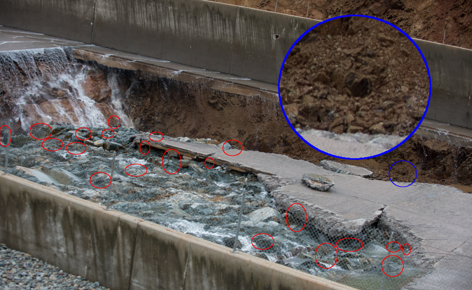

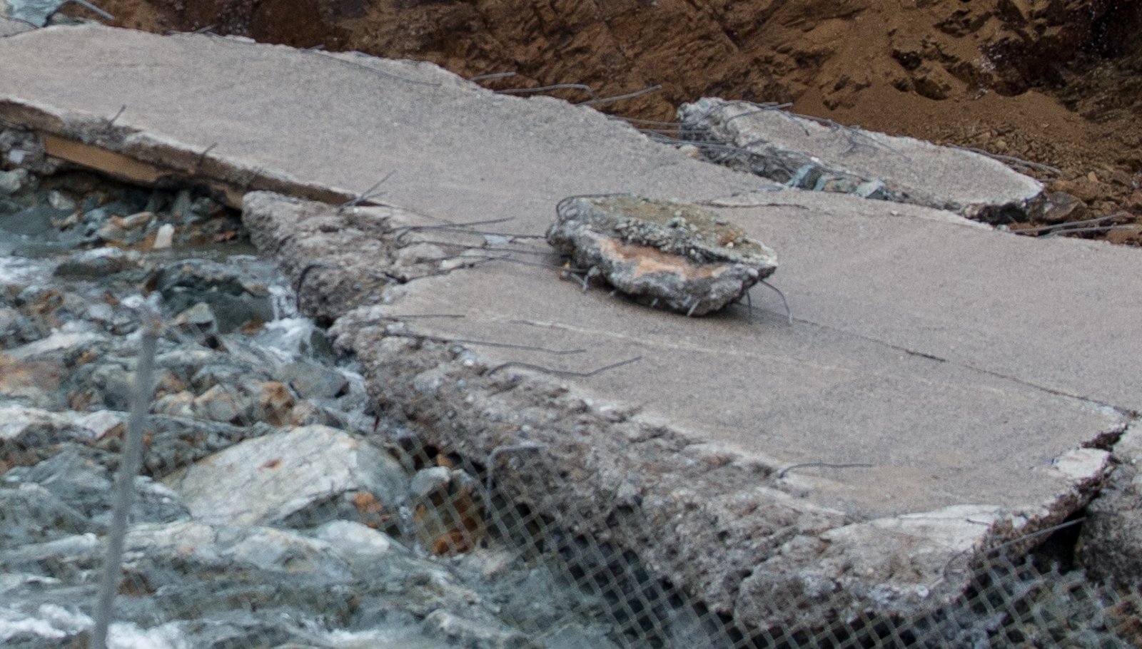

BTW I asserted earlier on that I did not see any reinforcement used in the spillway floor but others said it was there. With these new pics I still do not see any rebar or other reinforcement in that concrete. Which is why I contend that it failed and touched this whole fiasco off. I'm no civil engineer but I'd think reinforcing that spill way would be mandatory in order to prevent a failure just like this.
Remember, these are ~15" thick slabs in a spillway that is close to 200' wide.
Most of the pictures posted are not close enough to see the rebar.
Edit: Here is one which is close enough to show the rebar, red circles are the anchors going into the rock:
Original source: Pixel - California Department of Water Resources
Marked up version source: Oroville Dam Spillway Failure | Page 25 | Metabunk

There was rebar in the photos is saw. I did expect that there would be ALOT more. I am also used to house construction.
