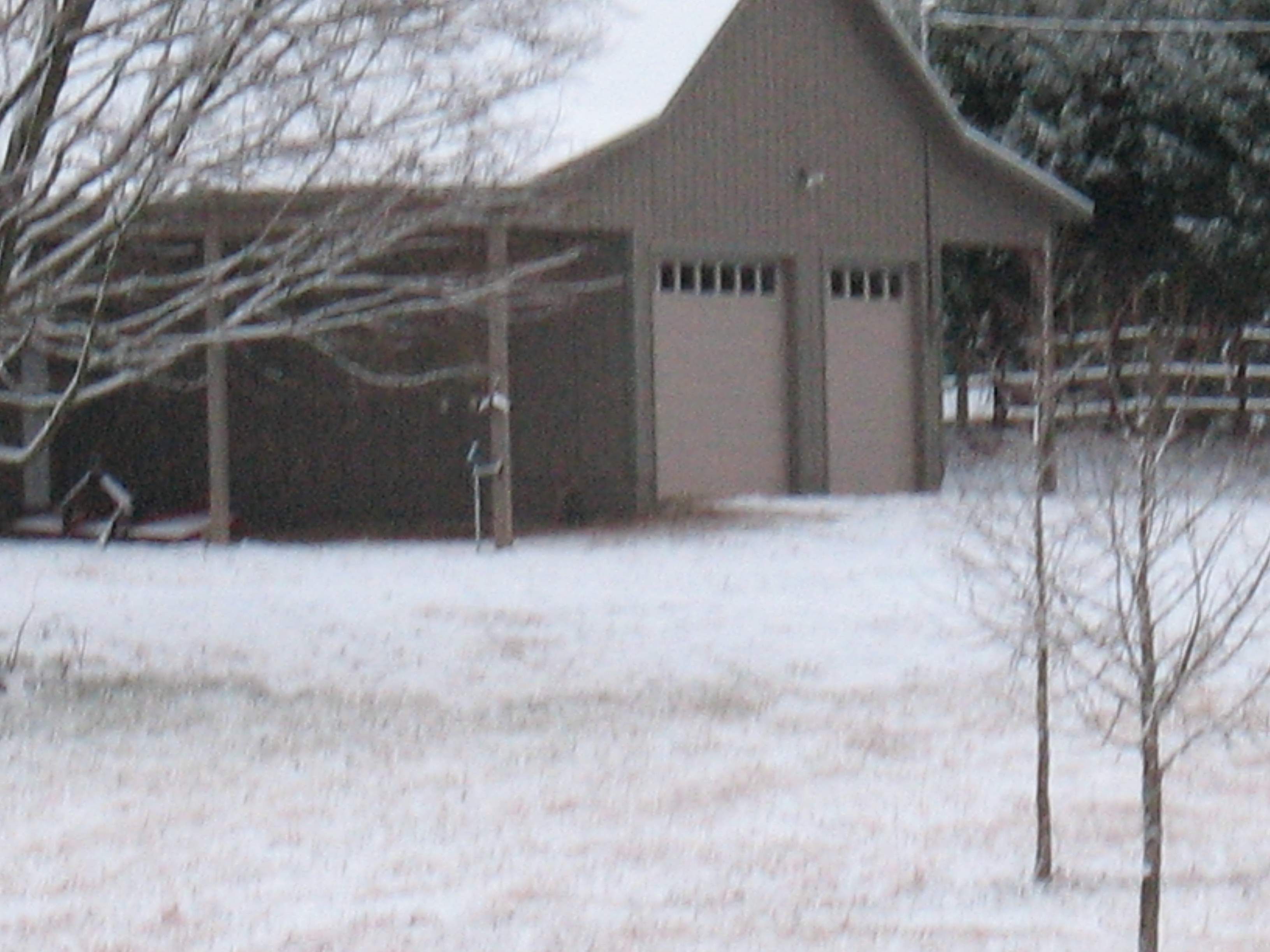

12_11_09 4.jpgI was really into building an all metal building 4 years ago and got prices both online and from local fabrication companies. What it boiled down to was the price of the material alone (not including slab, wiring, insulation or interior sealing) was more than it cost me to build a wooden structure. I was pricing a 30x40 steel and it was between $30-35K for material only and I had to pay more for erection, put in the slab, wiring, lighting etc. I got a contractor to build a 30x52 (30x30 slab with 12 foot wing sheds on each side) wooden structure with 9' 8" interior ceilings with 12 x8 bathroom on one side of the lean to, concrete floor on the 980 sq ft structure, full 100 amp electrical services complete with lights and receptacles, plumbed for the cold water bathroom, 6" bat insulation walls and ceiling, Attic floored in the middle 12 foot section for additional storage with pull down ladder, 1/2" exterior grade plywood sheathing on the outside and 3/8" plywood sealing on the inside walls and ceiling with exterior painted, galvalume roofing, 8 foot tall insulated garage doors with electric openers (one 16' wide and one 10' ) all for $25,500. Granted the price of everything has increased a lot now but I got a much better building than what I would have gotten with the steel especially the electrical and insulation. I can keep it warm in winter with a 1500 watt heater and cool in summer with a 14000 BTU window air conditioner. I did sacrifice ceiling height but I could have gotten it higher if I wanted for just a few dollars more. Hindsight tells me I should have went with a 12 foot ceiling but other than my 70 HP tractor, I have no trouble getting all my smaller stuff inside.
I thought this would be large enough, but 3 years later I added another 14 x 30 shed on to the back for my boat and lawnmowers. Good advise on building as big as you can afford and then some because it is always too small "eventually". Attached photo is about the best I can do at the moment for showing how it looks upon completion.

View attachment 328662I was really into building an all metal building 4 years ago and got prices both online and from local fabrication companies. What it boiled down to was the price of the material alone (not including slab, wiring, insulation or interior sealing) was more than it cost me to build a wooden structure. I was pricing a 30x40 steel and it was between $30-35K for material only and I had to pay more for erection, put in the slab, wiring, lighting etc. I got a contractor to build a 30x52 (30x30 slab with 12 foot wing sheds on each side) wooden structure with 9' 8" interior ceilings with 12 x8 bathroom on one side of the lean to, concrete floor on the 980 sq ft structure, full 100 amp electrical services complete with lights and receptacles, plumbed for the cold water bathroom, 6" bat insulation walls and ceiling, Attic floored in the middle 12 foot section for additional storage with pull down ladder, 1/2" exterior grade plywood sheathing on the outside and 3/8" plywood sealing on the inside walls and ceiling with exterior painted, galvalume roofing, 8 foot tall insulated garage doors with electric openers (one 16' wide and one 10' ) all for $25,500. Granted the price of everything has increased a lot now but I got a much better building than what I would have gotten with the steel especially the electrical and insulation. I can keep it warm in winter with a 1500 watt heater and cool in summer with a 14000 BTU window air conditioner. I did sacrifice ceiling height but I could have gotten it higher if I wanted for just a few dollars more. Hindsight tells me I should have went with a 12 foot ceiling but other than my 70 HP tractor, I have no trouble getting all my smaller stuff inside.
