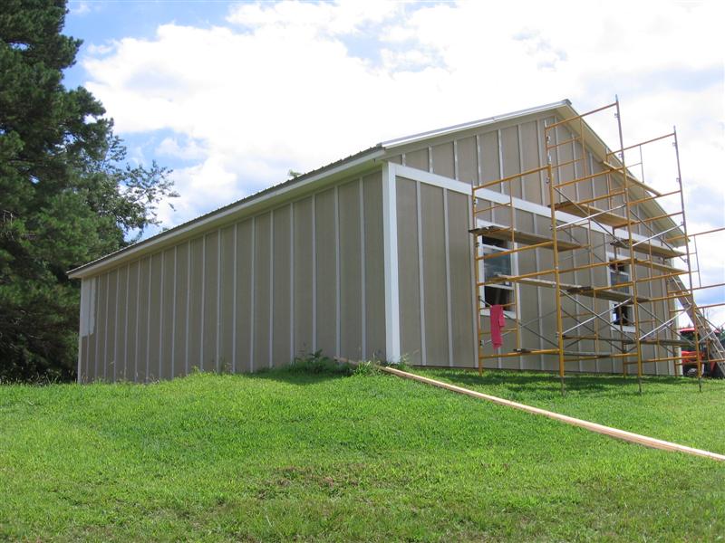

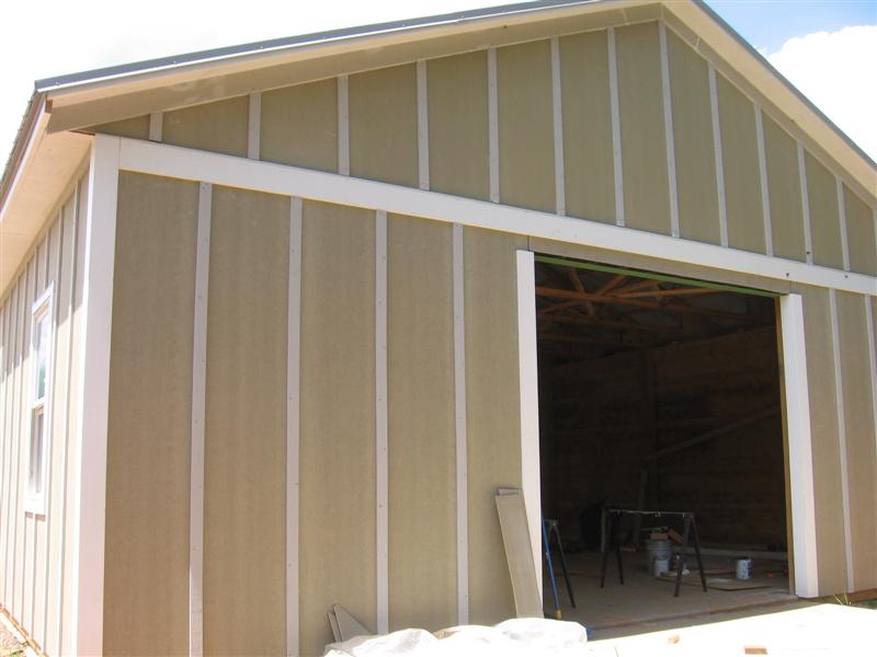

I am nearing completion of my 30 x 40 pole barn. I have been doing most all of the work myself. My building has a metal roof, trusses on four foot centers, OSB sheathing with 4 x10' Hardie panels as siding, 5 windows, a man door and a garage door and a concrete floor with radiant tubing and rebar in it. At this point I have spent $21,800.
Building permit $270
Building 30x 40 on concrete slab.
Concrete Floor
Rebar $805
Gravel 21 A 35 tons $800
Tubing for future radiant heat $461
Plastic vapor barrier $ 106
2 inch foam insulation board $1000
Concrete 4.5 inches thick $2440
Concrete finisher 2 guys $1150
Concrete floor expense sub total $ $6762
Metal roofing $2441
Five Windows $1280
Hardie panels siding $1835
Osb zip sheathing, lumber $ 1523
Miratek 1x3 for battens $390
Azek for corners $ 455
Man door $ 218
other lumber nails trim boards,bolts, $6026
and Misc items
two carpenters to help put trusses $600
and roof on.
Total for everything $21800
Rick

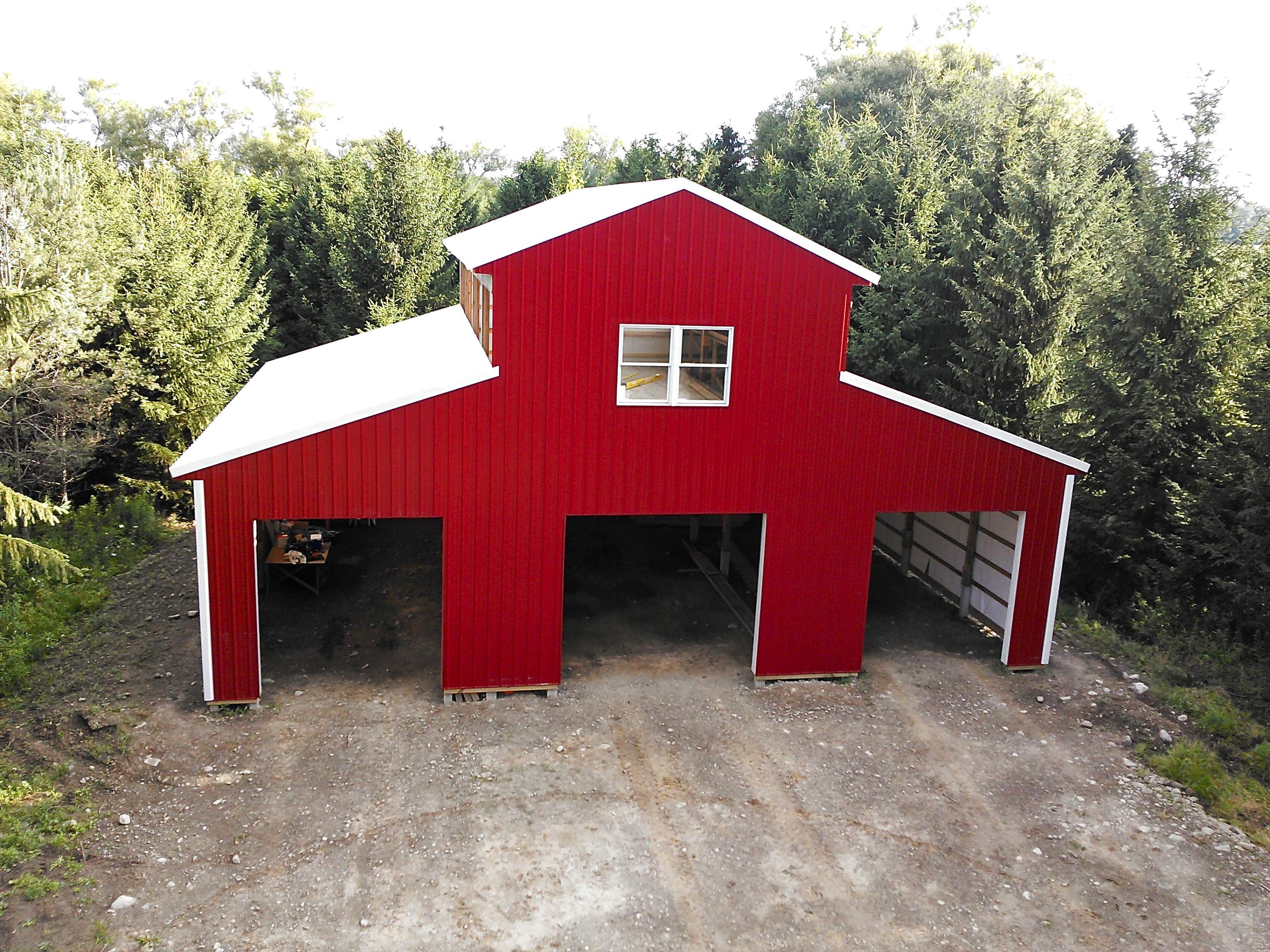

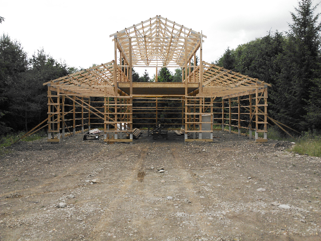

If you are thinking of doing it yourself I can add to your comparison info. Myself and a cousin have been putting up a 50x40 monitor style pole barn since the end of May. That may sound like a long time but we have not worked on it full time. I have keep track of actual working days and we have around 15-16 into it. about half of those I was by myself. Also, the monitor style is a lot more labor then a standard pole barn. Including the second floor I have 2800 sq.ft. of space inside. Now for the good part, cost. I did this barn for $11/sq.ft., that INCLUDES the added cost of using Perma-Columns! Total cash out for materials and equipment rental comes to 31,000. Here are some details of my barn:
50x40 Monitor style, 20x40 second floor
24"diameter by 10" thick footers, ready-mix conveyor truck
Perma Column posts, (14) 17' PC6300s, (13) 27' PC6400s, shipped preassembled from factory
(22) 15' 4/12 Mono trusses, 4'o.c.
(11) 20' 5/12 Standard trusses, 4'o.c.
2x12 truss headers inside and out
14" LVL's and Ijoists for second floor, Includes hangers
3/4" Dryguard T&G subfloor
(8) 4'x2' vinyl sliding windows, (4) each in second floor side walls
(2) 3'x4'6" dbl hung windows, second floor front wall
Interior stairs
Bubble insulation walls and roof, between metal and purlins
Vented ridge
Full vent soffits
(2) 10x10 overhead doors, carriage house style with glass
(1) 12x10 overhead door, carriage house style with glass
(1) 36" fiberglass raised panel man door, no glass
Skidsteer & 24" auger for 24hrs
40' manlift for 7 days
Air nails, joist hangers, etc.
Although I am not 100% complete, all materials have been purchased at this point so the 31,000 is a good number. This does not include a concrete floor though, just the shell. If you have any questions feel free to send me a message, there is also a more detailed write up/pictures on my thread, the link to it is below in my signature line. Hope this helps.
