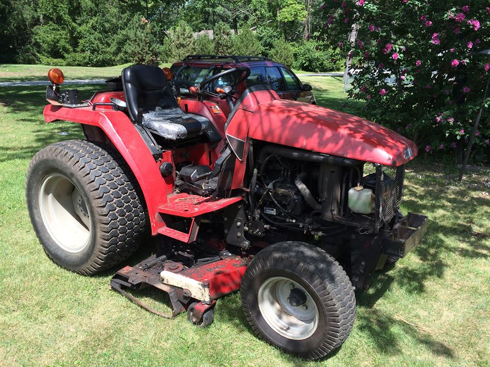

Hello,
New member here, saw your post so I joined. Picked up a slightly well used 1130 the other day. Been researching it, working on getting it looking like a tractor again. I appreciate the information you guys shared, helps a lot.
Mechanically it's fine, has high hours (3400). Only issue I found so far is the power steering line has a small leak, ignition is a little quirky. Sheet metal is beat though. Somebody smacked a tree pretty good. Good enough to dent the weight bracket and bust the grille. I pounded out some of the dents, welded the cracks back together in the hood. Need to fabricate a new grille or find an inexpensive used one. Been touching up the paint as I go. Took the woods deck off and cleaned it up. Sounds like a hammer mill while running, mows ok though. Guy I bought it off of said it had sealed bearings which I suspected was incorrect. Well, I found the grease zerks for those sealed bearings after I cleaned the grime off. LOL Bearings should be easy enough, going to pack them with grease first, just to see.
Should have it ready to do some work in the near future.

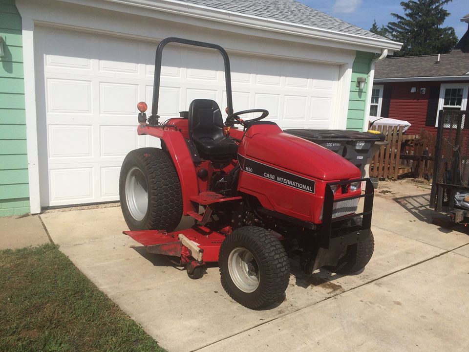

Wanted to share the updated version of the tractor I posted above. I'm pretty happy with how it turned out. I had to repair some of the sheet metal and fabricate new tabs. New seat. New Grille. Used headlights, new hydraulic line. Lot of new paint.
