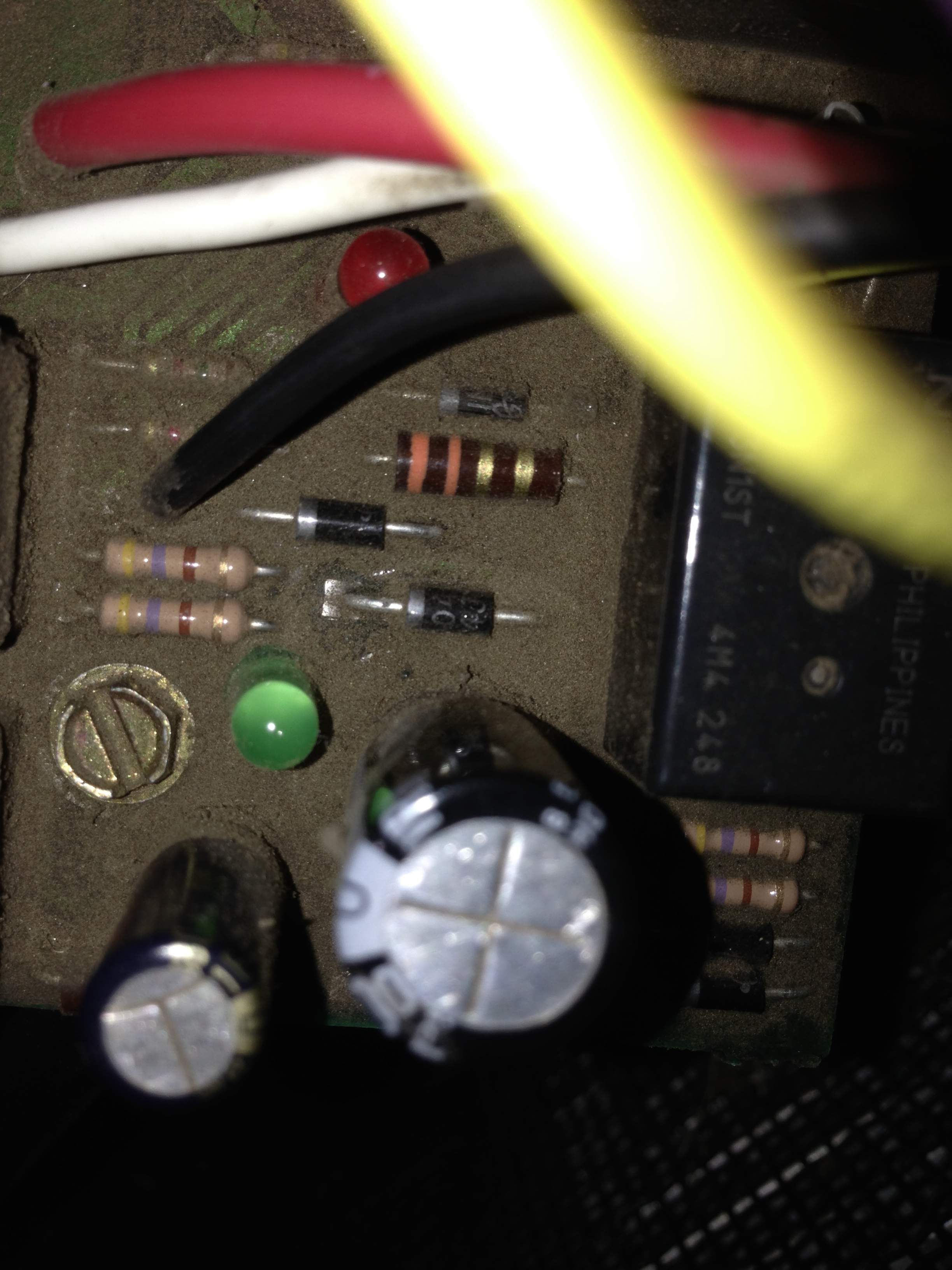

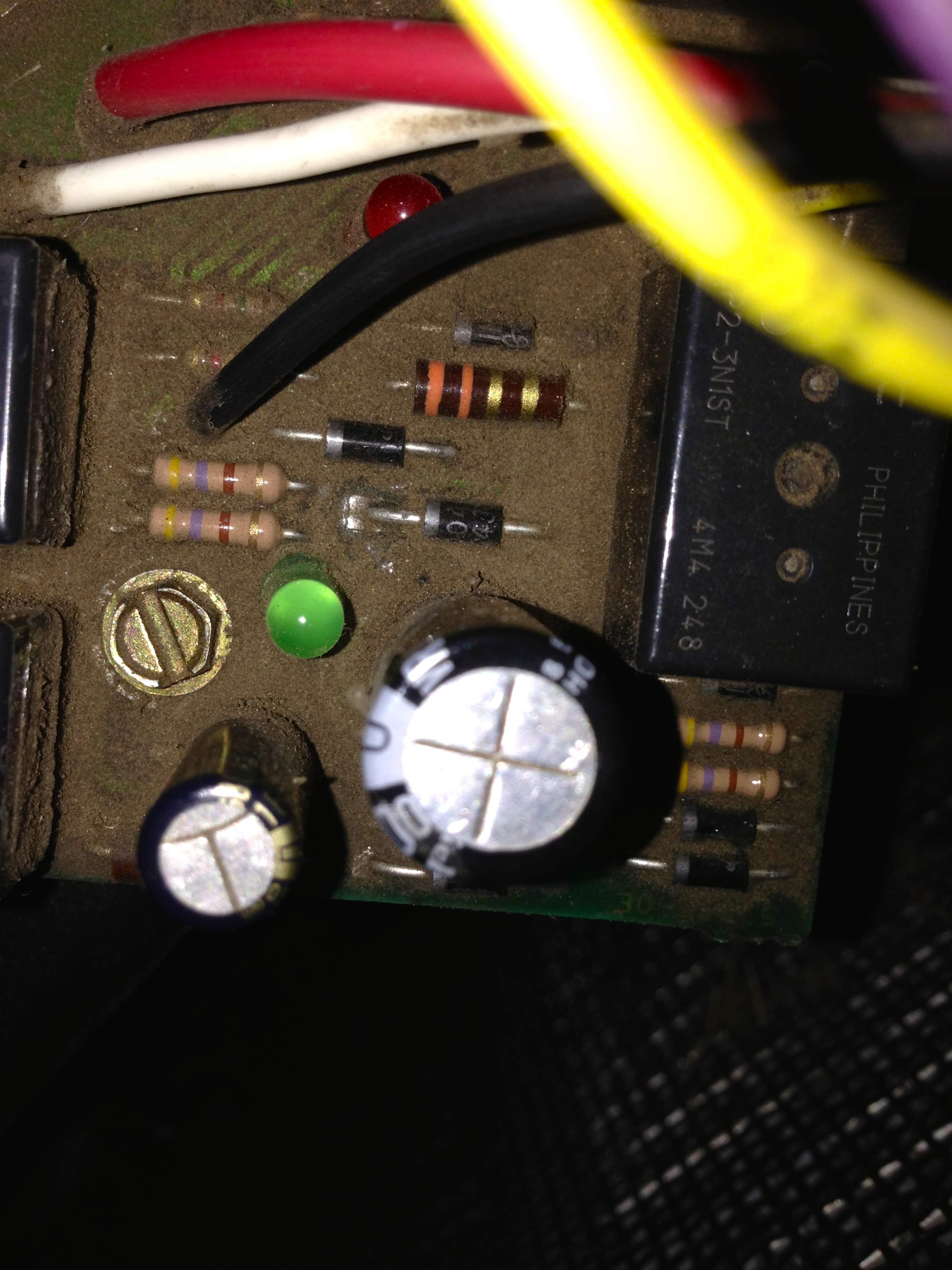

Yup looks to be the same! I need the colors of the bands on the resistor with the brown body on the right side above the larger capacitor. It appears as though they are Orange Orange Gold Gold. Is that right? Thanks a million my friend! BTW I have two brothers serving in the USAF - thanks for your service!
   / Calling all x595 (diesel 4x4) owners - HELP! #12
Try these two photos. As I remember it, Blk, B, R, O, Y, G, B, V, G, W, gold 5%, silver 10%, none 20% Am I right?
More on the USAF after we fix your John Deere, thanks!

You are correct, good memory! That OOGG means it's a 3.3 ohm resistor, not a 33 like the other. I had soldered on a 33 to match the other on the board since I had gotten no replies previously - I'll desolder and replace that and let you know the result! Thanks again!
