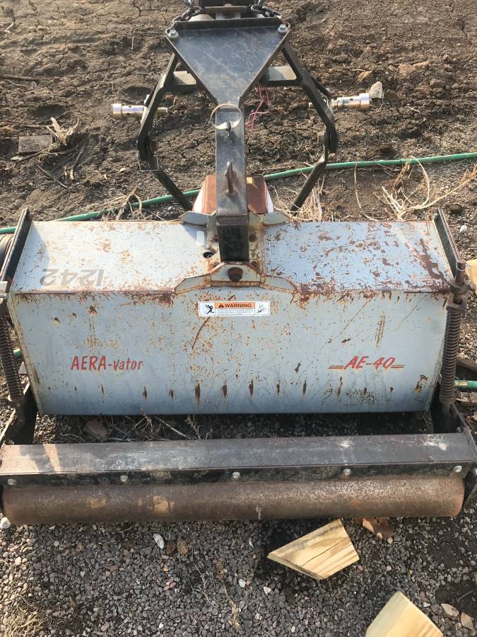

You are right about it not working on dense clay and black soil if it’s wet, but if it is dry it will work excellent. Like I said in my earlier post it will break up the hardest soil

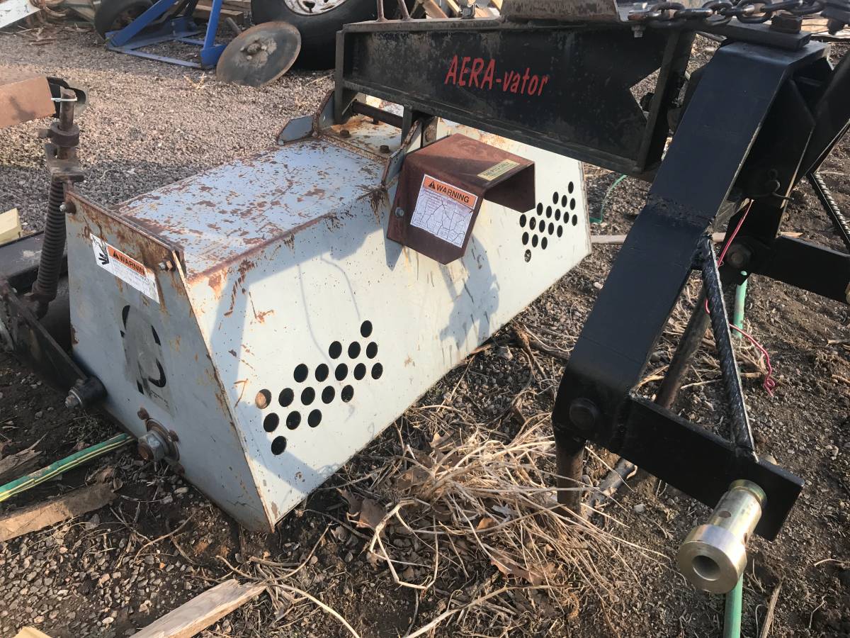

If you look real close you can see that machine as it rolls forward also elongates the hole. Which really isn’t a big deal. That horizontal action actually can help with loosening the soil below the surface. You will also notice that it is a solid time which does help open the soil more than the latest hype would leave you to believe. These machines are great at breaking up hardpan if they have deeper penetration than the other aerators that were previously used. That machine is also extremely slow. I know that I am biased because I do love the aeravator but it is the only aerator that doesn’t creat hardpan because it fractures the soil horizontally and downward. I have used it and it creates great results. This is almost a pointless discussion really except for the mental exercise because unless you can make money with this machine very few homeowners/landowners can afford either of these machines
