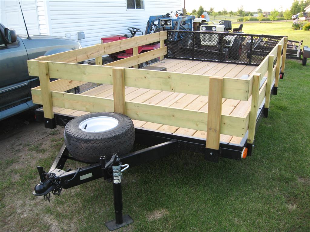

Looks real good :thumbsup:
What did you use for decking? Can't tell if 5/4 or 2x, need some closeup pictures.

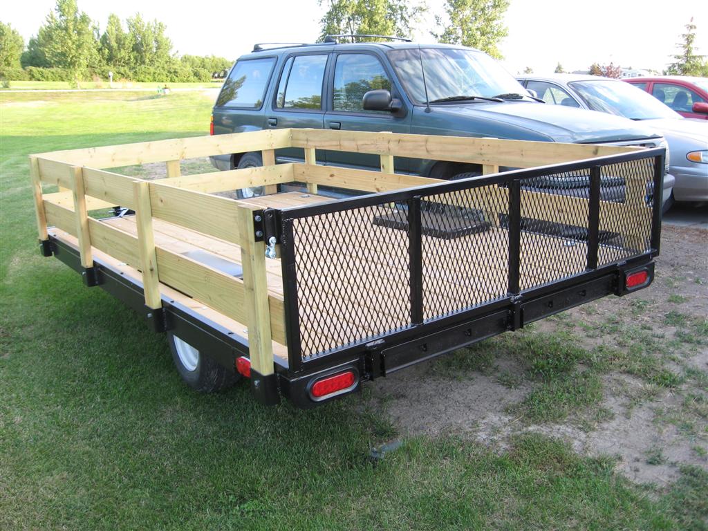

This is what I ended up with. Still need to stop by TSC to get some chain for the tail-gate, beyond that it is pretty much done. Had it inspected and licensed as a homemade trailer (didn't have to but will be easier to claim if ever stolen and found again). Should come in handy for our light-duty hauling needs.
Oh, I used 5/4 pressure treated deck boards on it.
