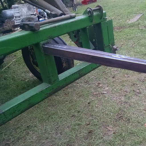

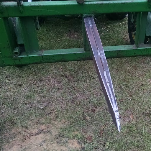

the answer is YES. I split one down the middle with a torch then put both sides together and weld together. the butt end will be a hair over 2" wide so I ground it down so it was 2" square and it will fit a 2" receiver hitch . it helps to blow out the pin hole before you weld them together . I will try and find the pics of it.
   / Can a Forklift Fork be cut down to make a round bale spear? #7
