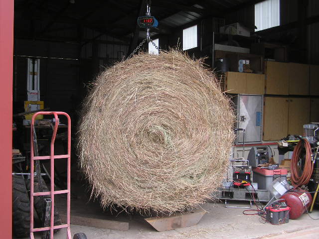

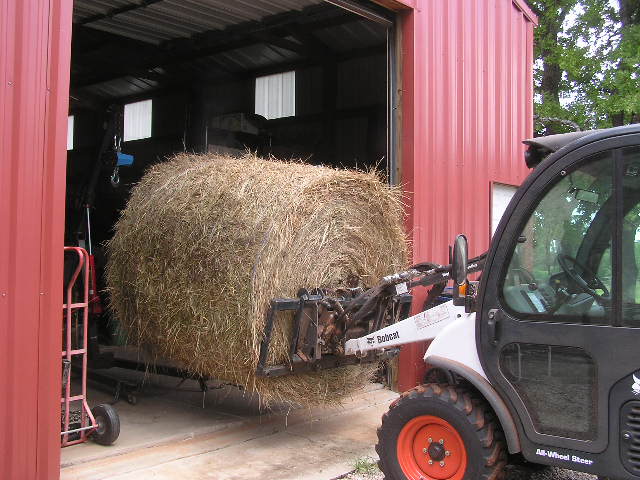

The OP didn't say what size round bales. The 5x6 bales that came off of our Blue Stem field were close to 1500 pounds. I know because I pulled the trailer across the scales at the feed store.
Now I can weigh the bale myself. This one is 5x5 and 1132 pounds:

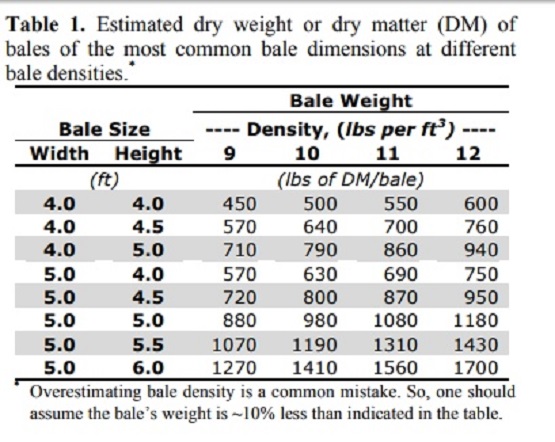

Here is a handy chart:

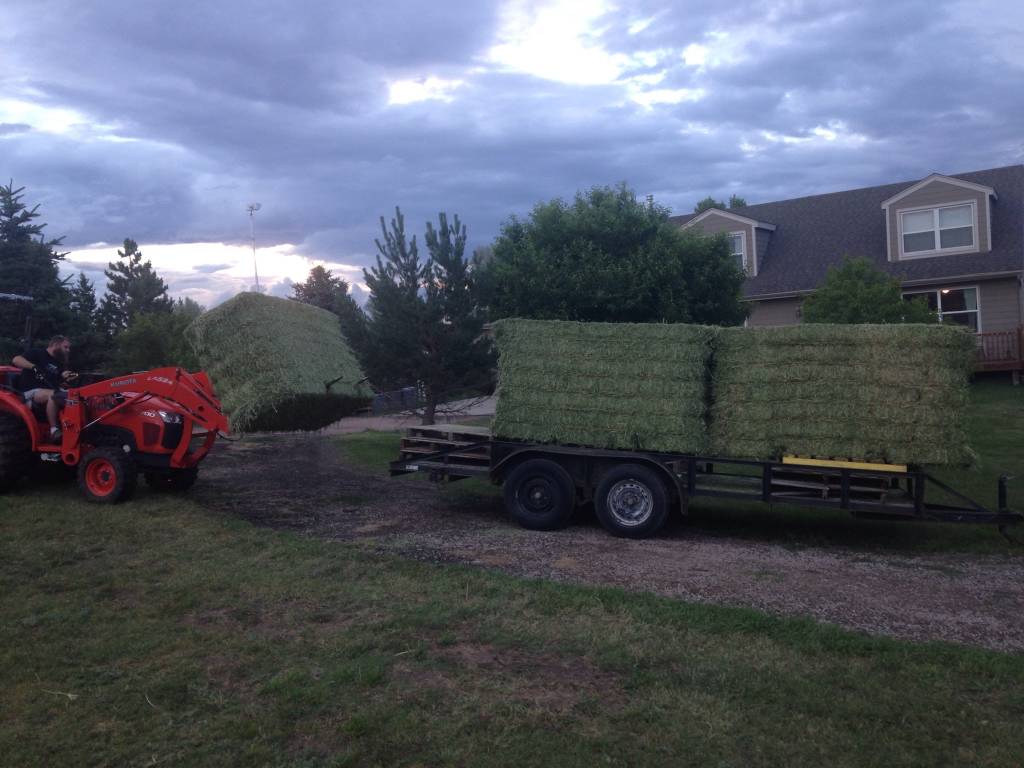

I had a L3200, same loader & frame as the L2501. I helped a friend move a small barn full of "1,200lbs" big square bales. I got the job done, but it was sketchy as ****. If I recall the loader is rated to 1,200lbs at the pins. Add in a couple hundred lbs for the forks & a decent bit for the load being well in front of the pins & I was well past the OEM rating.
I had a 5' rotary cutter on the back & a small pile of 50lbs bags of stuff on the back of that. Loaded R4 tires too. Lots of ballast & it was located a lot further back than normal for better performance. It still really wasnt enough. The back end was really light & pretty much came off the ground at least once.
The lack if ballast is guaranteed to be the weak point on the economy L 2 & 3 thousands, possibly the "frame". My new L4060 on the other hand is rock solid at max loader lift with just loaded tires (I keep ballast on the 3pt pther than that one time). So hydraulics & loader design are the weak spot there. Probably closely followed by the front axle, but that's just a guess. Everything has a weak spot, so that's not a complaint against either machine. Just s matter of where that weak spot is. Hopefully it's a power or ballast weak spot, not a structural issue.
I was lucky if I could lift a bale high enough to stack it on another bale. It depended on how lucky we were with the weight of a given bale.
In short, a L2501 might be able to lift your bales. But it wont be able to do it safely. You can probably get away with an occasional bale, as I did. But plan on getting a bigger machine if you plan on moving big square or round bales.
Found a photo of moving those bales with the L3200. That's likely as high as I could lift that bale. I still pucker up remember doing that.
I couldn't use my 3pt bale spear (cheap impulse garage sale score I really dont need or use much) as it would just tear out the top of the bale. A round bale wouldnt have that problem as they dont have the vertical flakes that are really weak against vertical pressure.IMG_8896-1.jpeg
I couldn't use my 3pt bale spear (cheap impulse garage sale score I really dont need or use much) as it would just tear out the top of the bale. A round bale wouldnt have that problem as they dont have the vertical flakes that are really weak against vertical pressure.View attachment 570497
Great picture! Thanks
