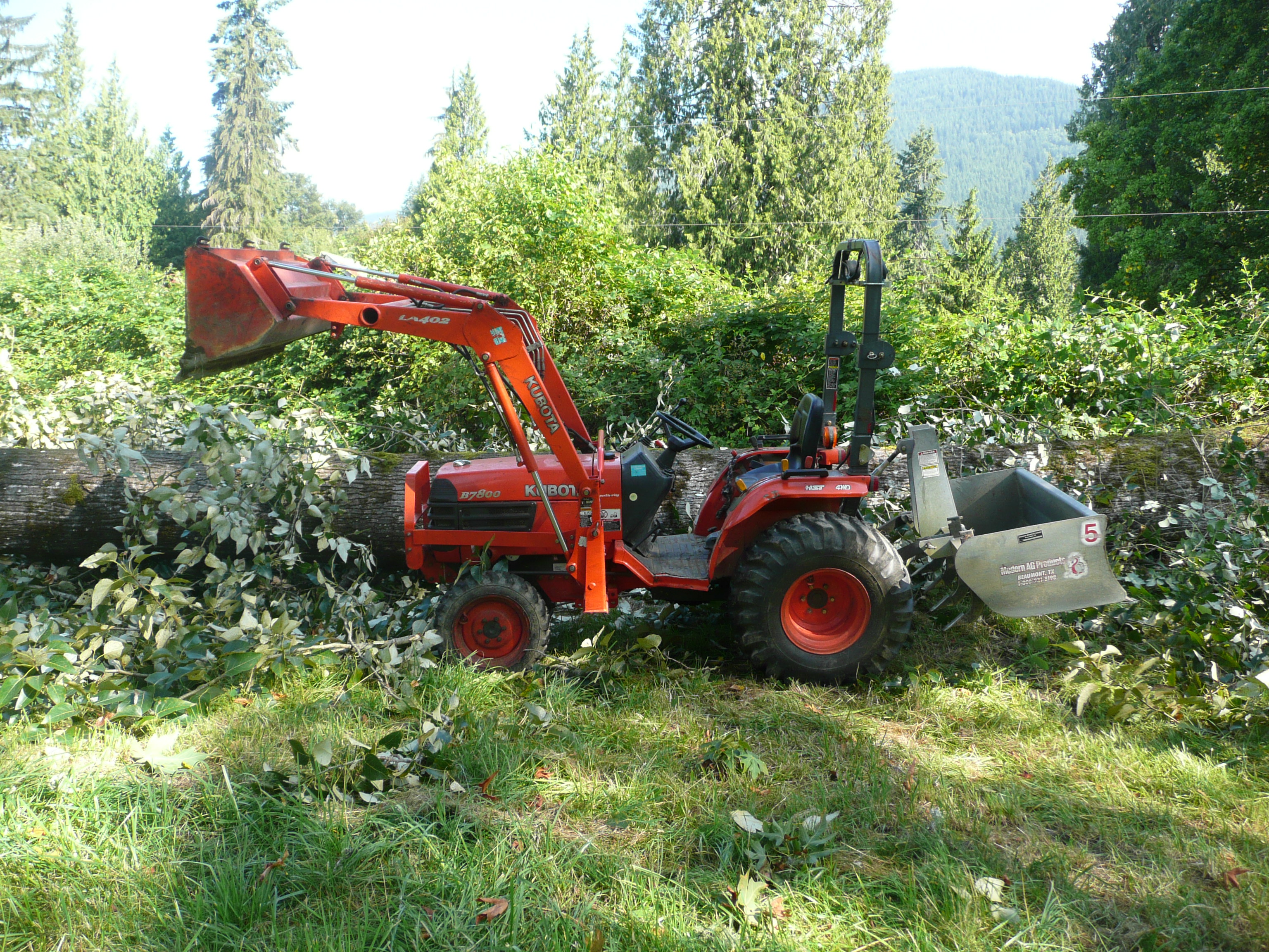

I've pushed my B7800 head first into a lot of heavy brush. Not because I'm a idiot, but because IN that brush are logs and stumps. Over the years I've had to push out stuff like that before I can run the mower. And, I also don't know how soft the ground is: I find it easier to push myself out with the loader than pull myself out with it.
900+ hours and I've broken or maimed:
- broke radiator/cooling system petcock
- broke a tie rod end
- knocked off the hydraulic return hose (ONLY time I was left stranded- had to tow out of the brush after running chainsaws to clear a path forward)
- loosened a loader arm hydraulic hose line fitting (thought I'd blown out the cylinder- I had done that, though not in brush [breaking tire beads off rims about 5 years ago)
- broke the lower plastic grill piece (new one was like $80)
- tore up the mesh that's behind the grill pieces (replaced with some stuff I found along the roadside! [but it too is getting hammered])

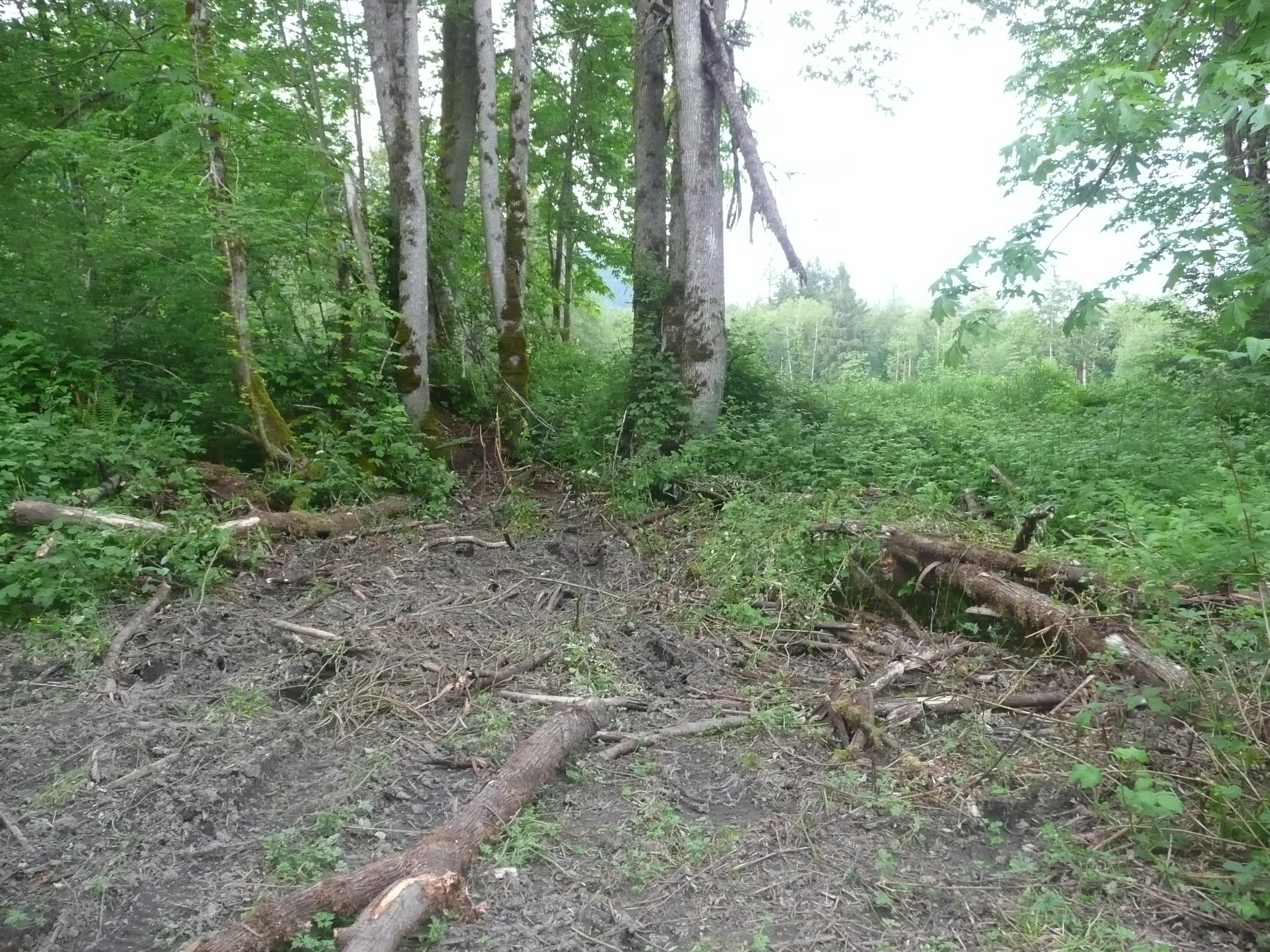

Here's an example of what I've dealt with (with just my B7800):
Before:

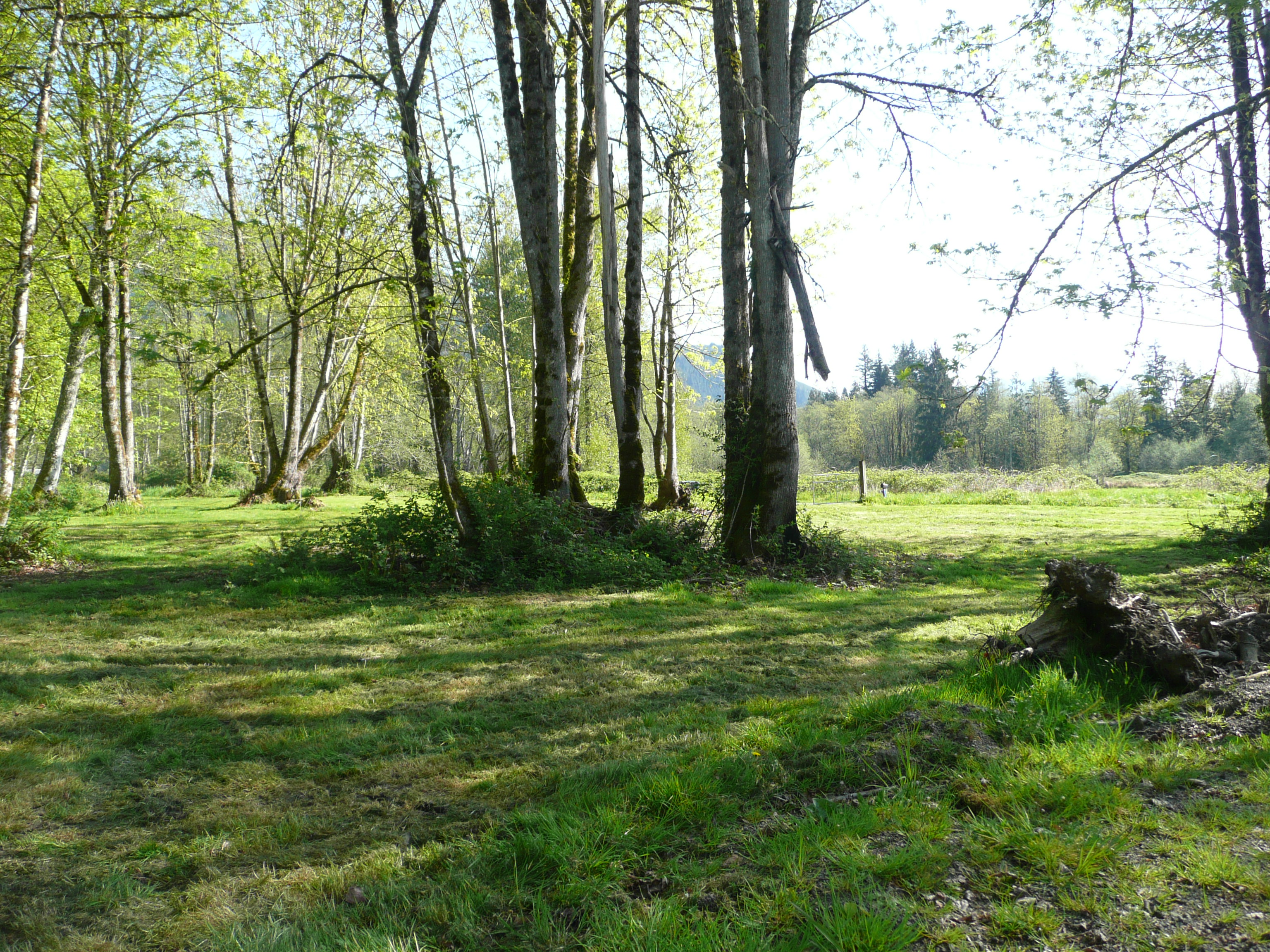

After [there's a small stump to the right which was from a clump that included a HUGE maple stump that I chipped away at and finally popped out with an excavator- buried in-place]:
