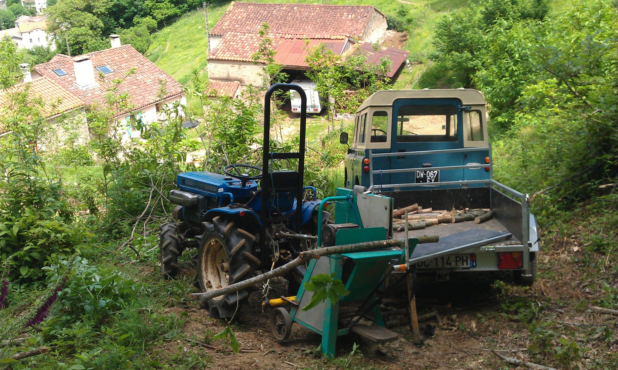

Be glad, it's your worst nightmare. I barely survived a sideways roll over before I had a ROPS cause I did not see a large pot hole in the grass. When I woke up, I looked up at the gearbox bottom of my Iseki ... The second slip in the mountains was when I entered wet grass that was hiding an edge, I slid downward front first, for 20M of height, banged into a fallen tree, jumped 3M through the air tractor and all. Was lucky that I got out undamaged, but I had enough of the mountains and sold our property. No more wood cutting and works on the mountain sides for me!
That Rover... đź’ś
Glad you're alright, that's not a game you want to play twice.
   / Can all tractors flip over easy? #140
That Rover... đź’ś
Yeah she's become a beauty indeed, after 3 years of restoring. She nearly took my toe off when the new chassis fell during rebuild, but hey life's a ***** ;-)
