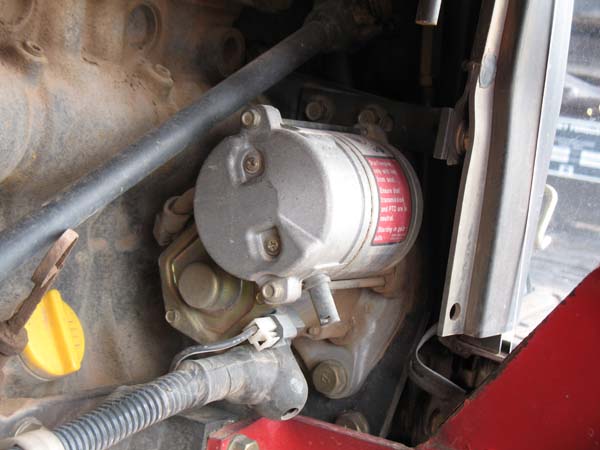

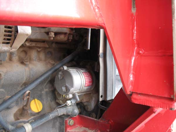

I don't know where/how to check the starter. Here's a couple of pictures to show it:

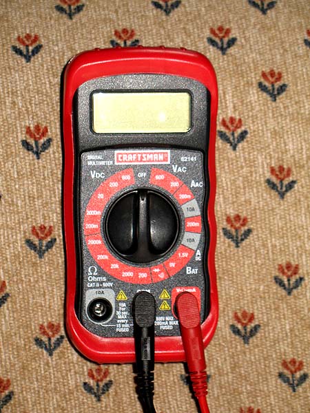

I'd like to test the starter, etc., but don't know which settings to use on the meter. Can someone guide me, please? Here's a photo:

Good, you have a digital meter. They will handle either polarity hookup. ... Take off the battery charger. Set the meter on the 20VDC scale and measure from the big sheathed wire shown - over to any good ground. - a clean bolt head will do. You should get the ~12.8 batt voltage. Leave the meter connected and then turn on the lights. Whats the meter say? -- Now energize glow plugs. Whats it say now?

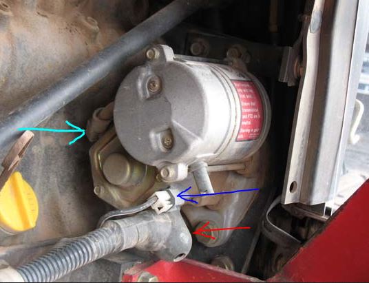

Good job Mare. I'm with Spyder, do as much as you can with the meter before ripping the battery out. Below is a doctored picture, I think this is correct per the picture. The cable with the red arrow pointing to it (big sheathed) should have 12volts on it all the time and should not drop much when the key is applied. The boot should pull back to reveal a nut that the big cable is held on by. The blue arrow points to the wire that comes from the key switch, this should have 12volts when you try and start it. This 12volts turns on the solenoid like a switch. The light blue arrow points to the output of the solenoid which powers the starter directly. It should have 12volts when the key is turned. I would think the clicking is coming from this area. Out of curiosity, does this tractor have a decompression lever?

So, the battery charged said "fully charged" so it is unplugged for now.
I did as SPYDER suggested:
Big sheathed bolt on started and clean frame bolt = 13.10 - 13.23 volts
Same test configuration with headlight (only one is connected) on = 12.63 volts
Same test configuration (headlight off) with key turned to glowplugs = 12.36

KubotainNH...what's a decompression lever? I don't think there is one. If my battery is reading over 13 volts, should the readings still be 12 volts at the arrows you showed?

Those numbers dont say the battery is bad. What V happens at those test points when you get the click?
