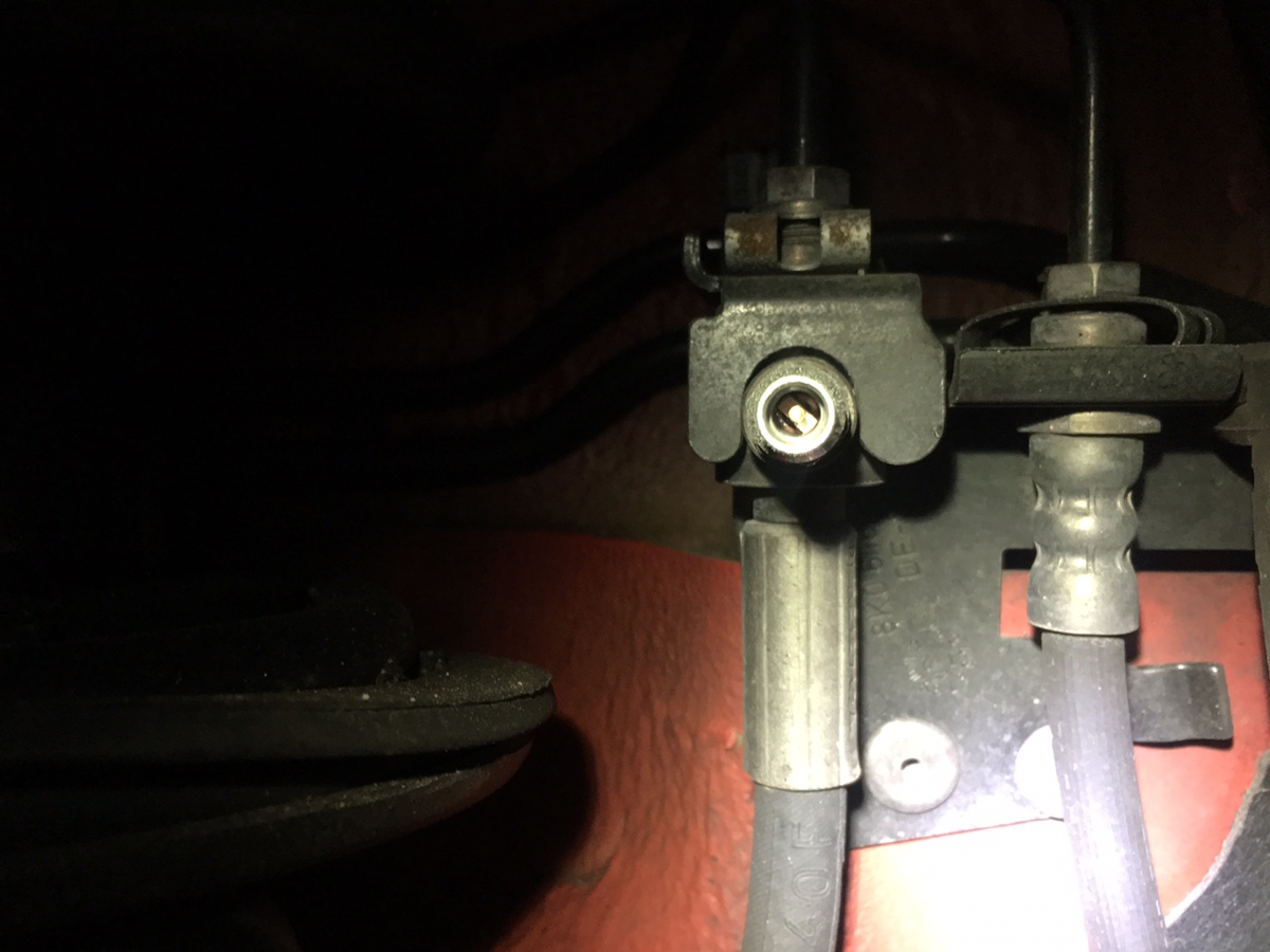

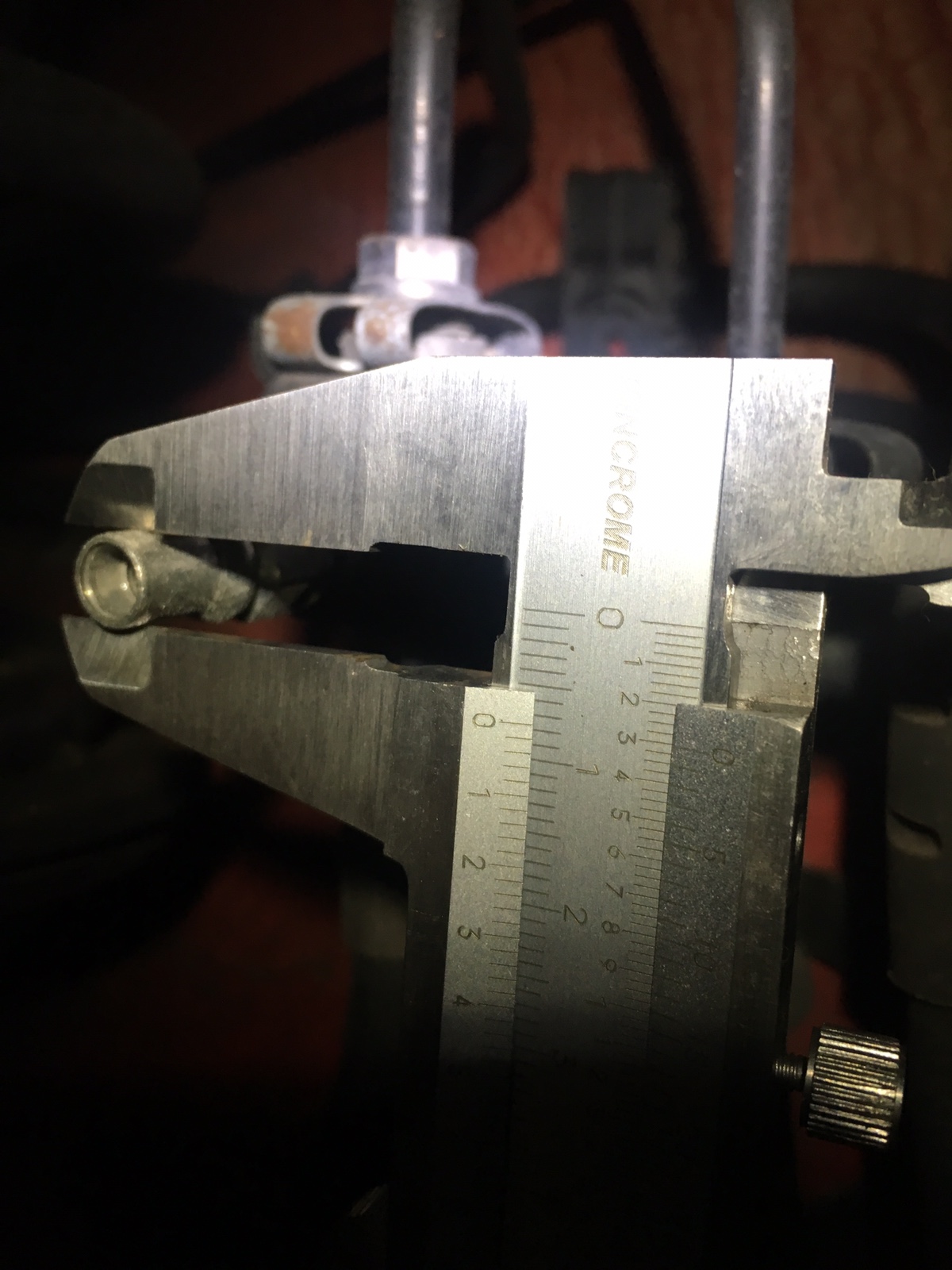

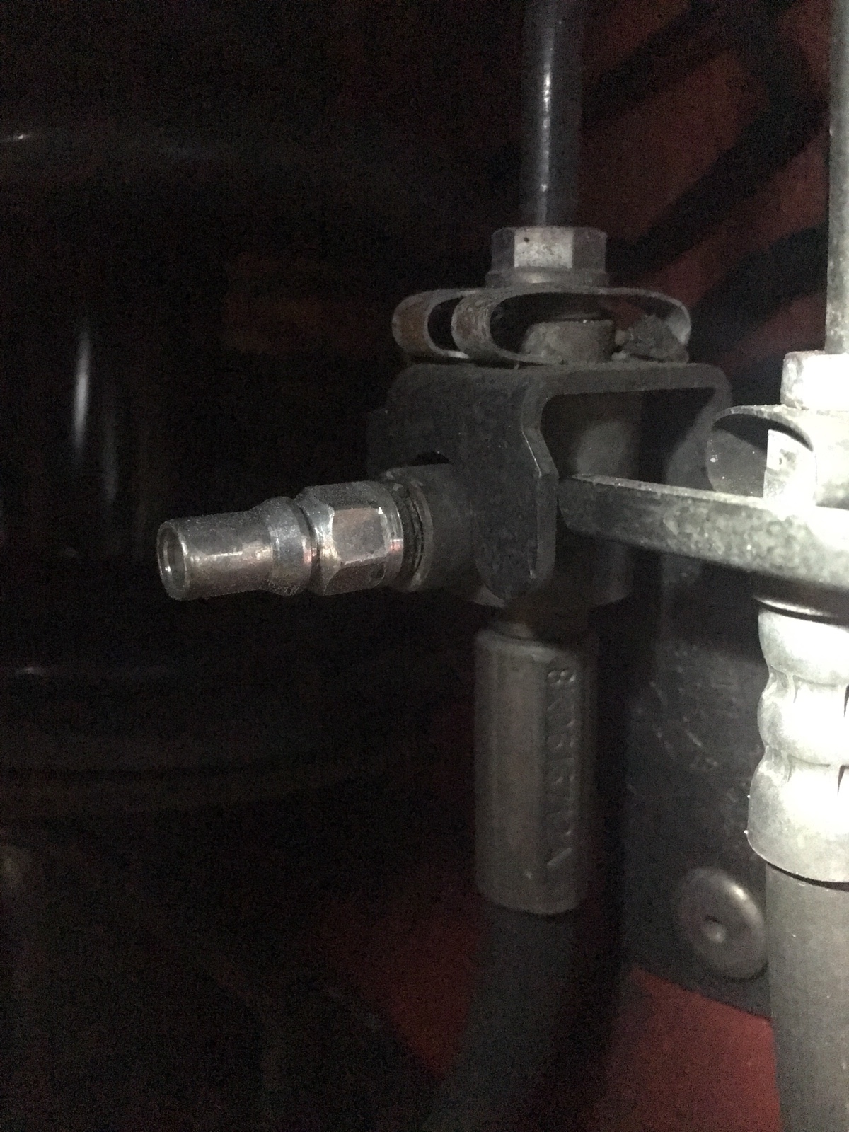

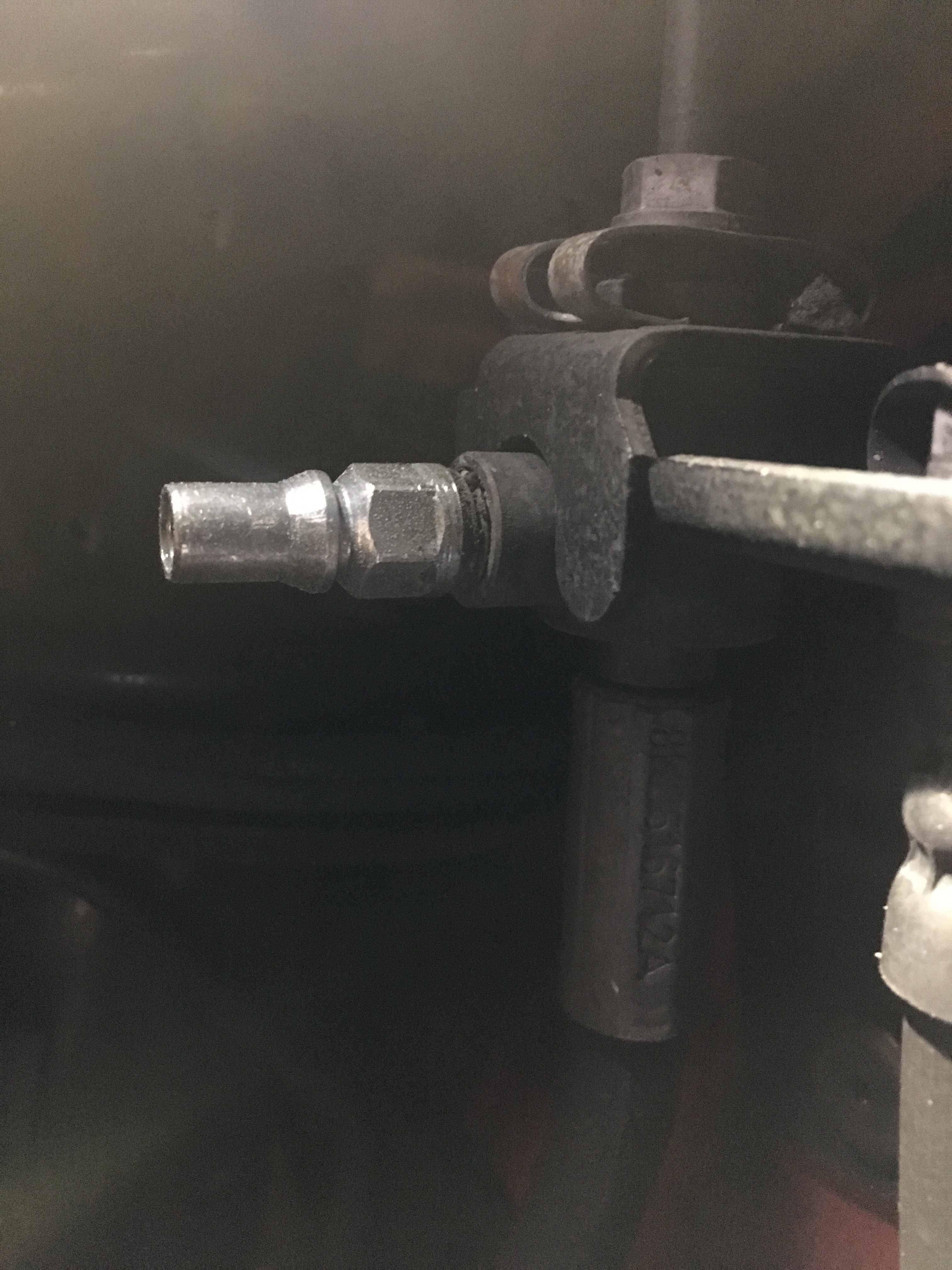

Been looking everywhere for this fitting
I need a coupling to fit this IMG_0602.JPGIMG_0613.JPGIMG_0604.JPGIMG_0590.JPGIMG_0933.JPG

Might wanna tell Audi that lol
Audi uses this fitting for the hydraulic suspension systems called dynamic ride control.
The system runs at 4 bar of pressure which isn’t really that much of pressure.
But your right on that it’s a air fitting because the closest thing I have found is fitting for air systems.
The problem I have is finding a coupler to connect to is being that snapon is the only manufacturer that makes the equipment and will cost over $3000 for the kit

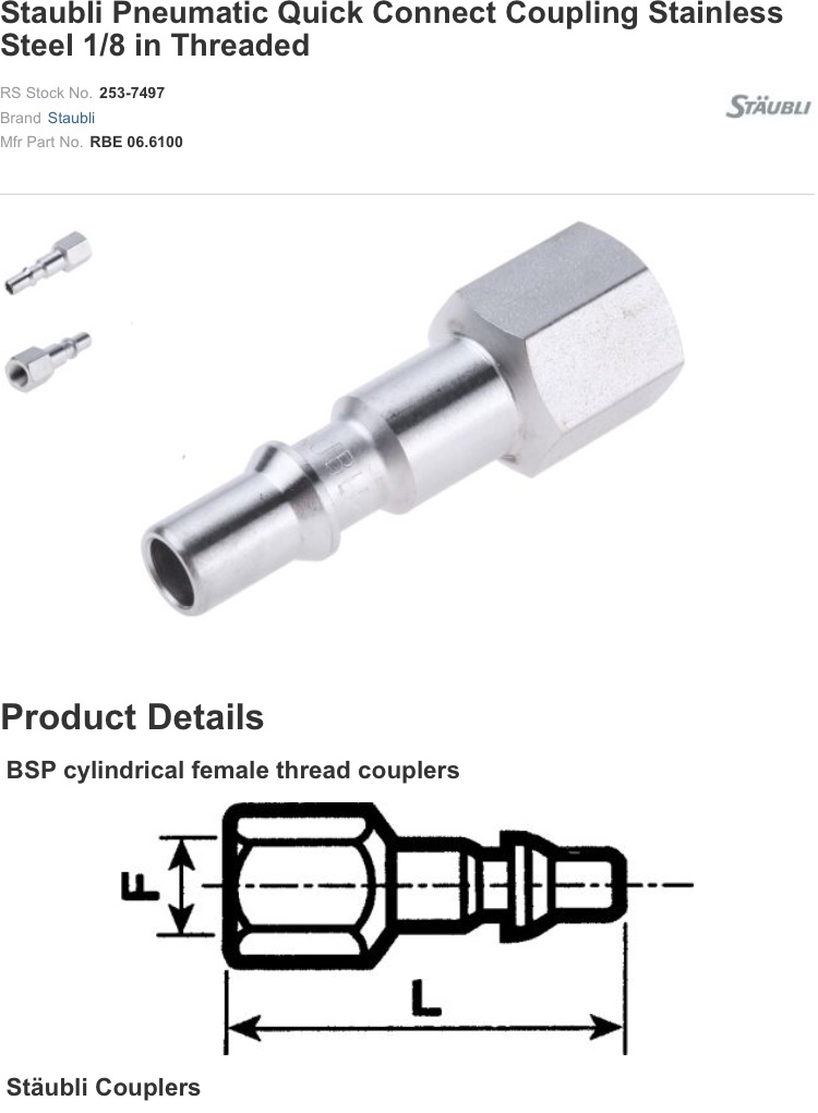

I do not see Snap On being a supplier of unique fittings.
There are two common style of air line couplers. Change both sides.... male and female.
4 bar is only 60 psi so far less than any shop air supply.
Audi's dynamic ride control is just interconnected air shocks so nowhere near a tractor or other machine's hydraulic pressures.

Do a goggle search for Audi DRC tools and also repair you may find something that will work for what ever it is your needing to do.

Why bother with this fitting? Buy a pair of fittings that work for your purpose.

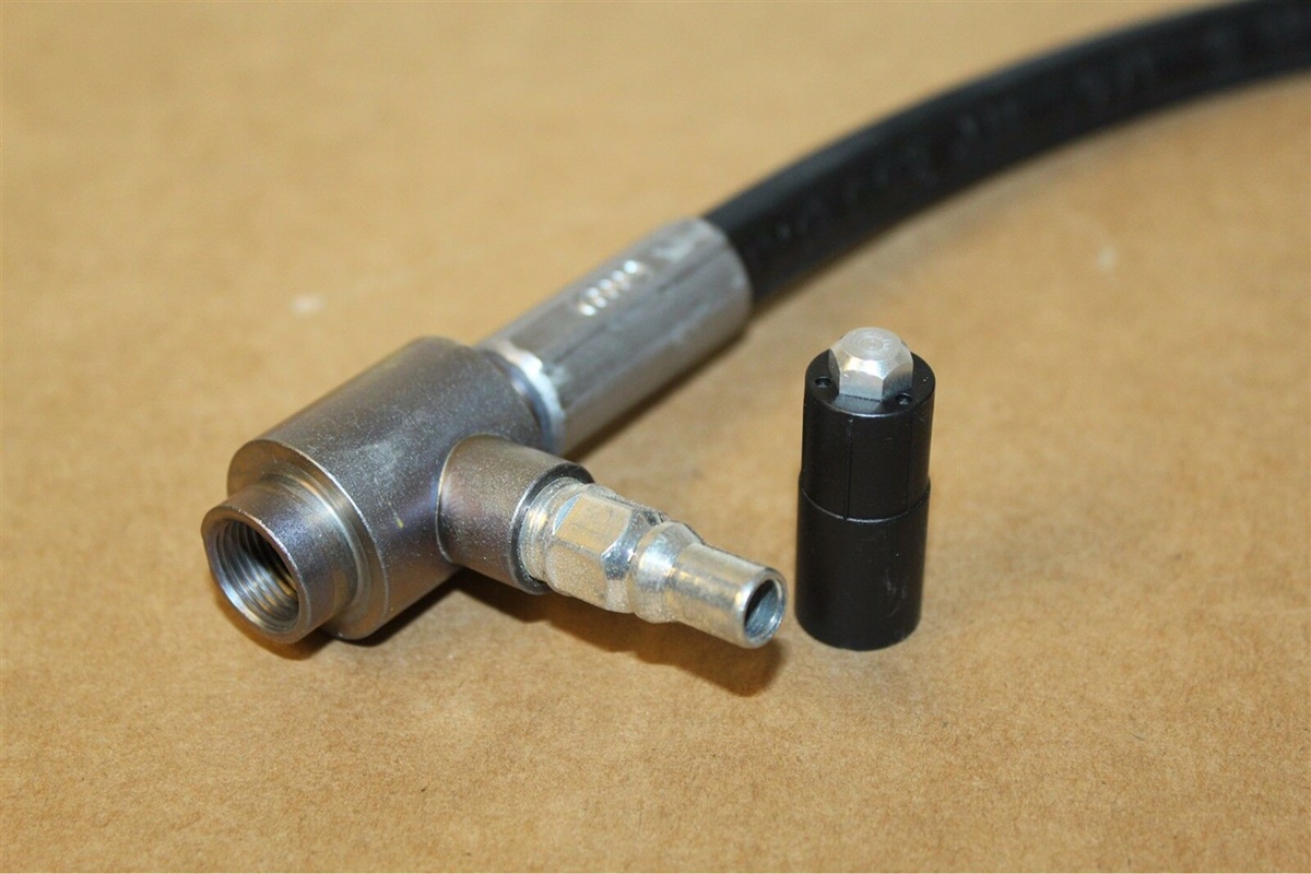

Was thinking of retro fitting them with something more common but if I was to sell the car I’d have to re fit the oem fittings and then I’d be needling the factory coupler anyway.
The car is a RS5
This is the closest I can get to it
This is the factory coupler
To me it’s some kind of fluid line
The system it self is designed and made by KYB
Originally the name was APA KYB which that trade mark has been out of date for some time now.
KYB is a hydraulic company that also go by the name of Kayaba
Here is a photo of the accumulator for the RS4
I suspect that this is a obsolete fitting that they had at the time for KYB hydraulics.
This is not found in any other job and all my years in the HVAC industry I have never seen this fitting.
It’s a a automotive fitting or a known commercial one.
Was hoping that this might be something in the truck industry. Have seen similar fittings for truck suspension.
Way past that point my friend hence why I’m so desperate
The service tools are completely out of my comprehension. To pay that much to do such a little job.
I can make this my self it’s just the couplers that I’m having issue with
No one seems to know what type of fitting this is.
