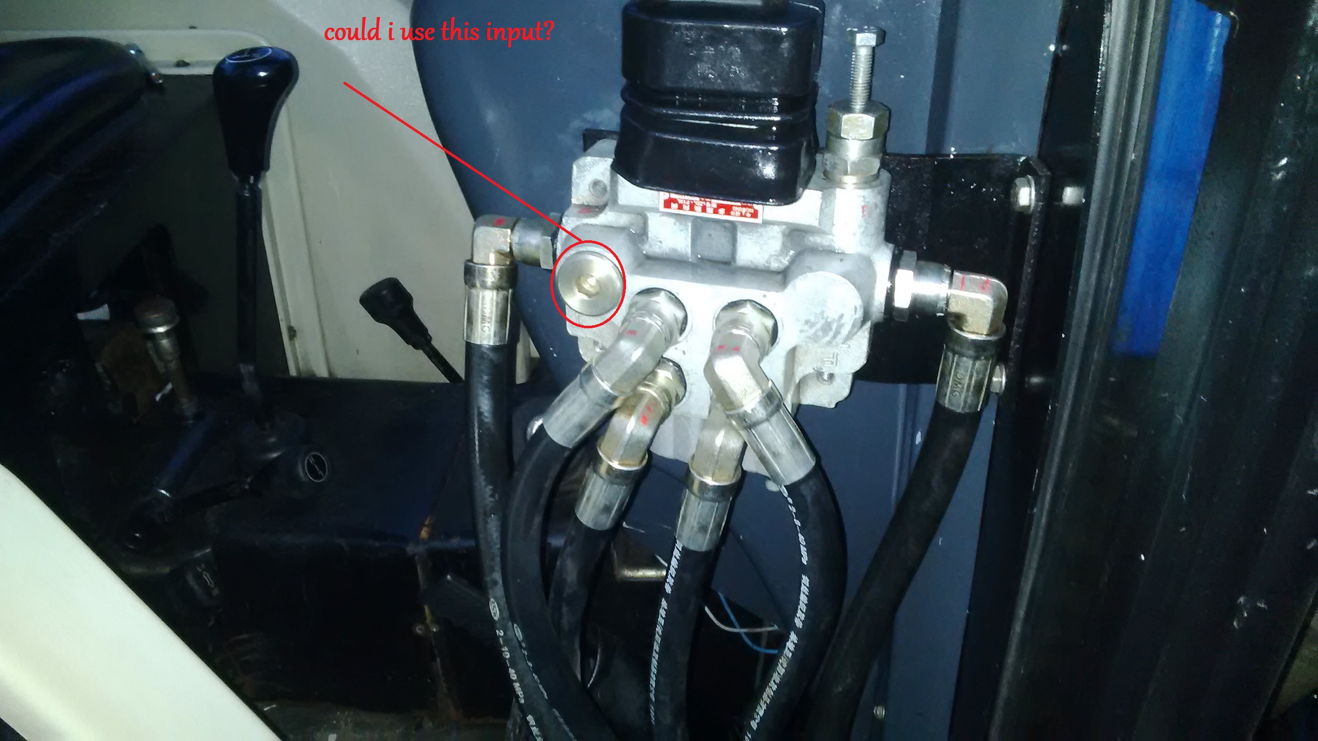

Good evening all, can anyone tell me what conversion fitting I need from this store world wide metric?
I have yet to find specification info for this FEL valve as to thread size and fitting type. thank you all.
   / Can anyone tell me what conversion fitting would fit my current valve from this site #2
That appears to be a 14mm ORFS on the power beyond port. What are you trying to do?

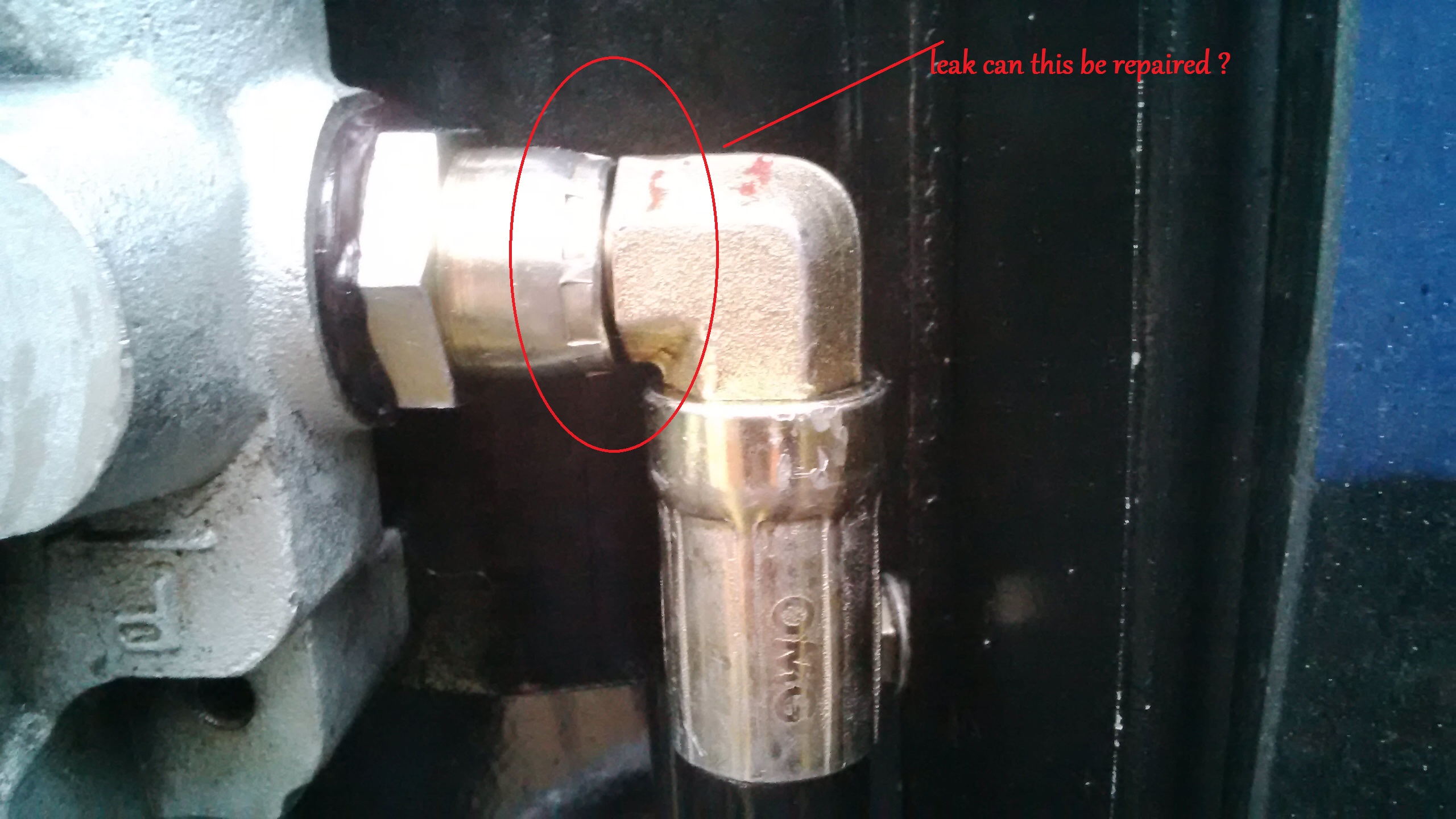

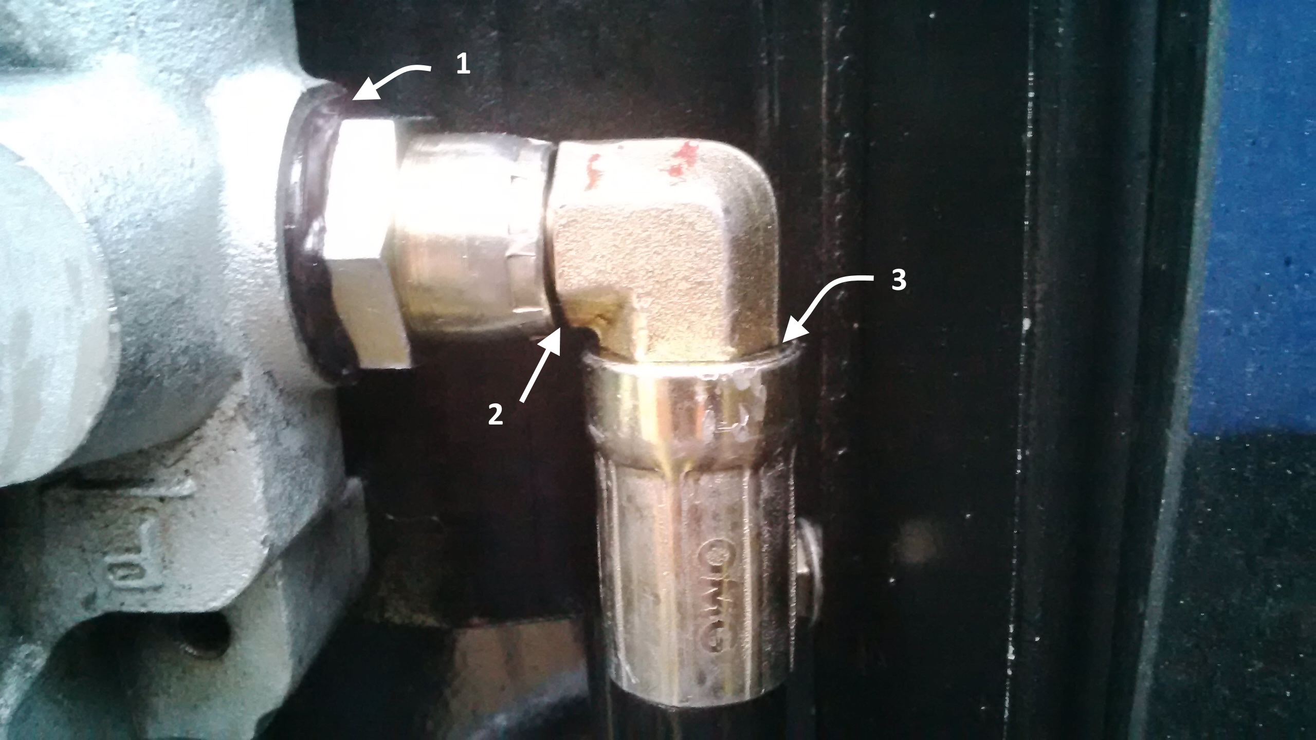

Good day Bob, I have a leak at the elbow joint well a drip so because those are odd size was thinking of getting conversion fitting from the at store I mentioned above see pictureValve leaking.jpg

Good day Bob, I have a leak at the elbow joint well a drip so because those are odd size was thinking of getting conversion fitting from the at store I mentioned above see pictureView attachment 425223
Did you put a new O ring on when you put the hose back on?
Hello Xfaxman, the only o-ring that I know of is the one you see on the picture is there another o-ring then the one you see on the picture thank you
   / Can anyone tell me what conversion fitting would fit my current valve from this site #7
No, that is the one, did you replace it?
And you never answered in the other thread, were is it leaking, there are three possibilities.
Tightly wrap a rag around the fitting and see were it gets wet first.

good day I thought it was clear on my picture sorry about that its leaking at number 2

Good day all. just a quick FYI I found the 2 conversion fitting for my spool valve and works great the in put and out put size is 15MDL-8MJ / Metric Conversion Male DIN 24* Cone Light Series to Male JIC 37* Flare Thread {1}: M22 x 1.5 Thread {2}: 3/4"-16 ( $32.00 each )
I ordered the 4 others for future use is I get a leak.
