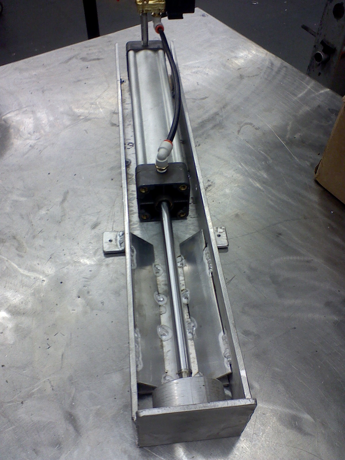

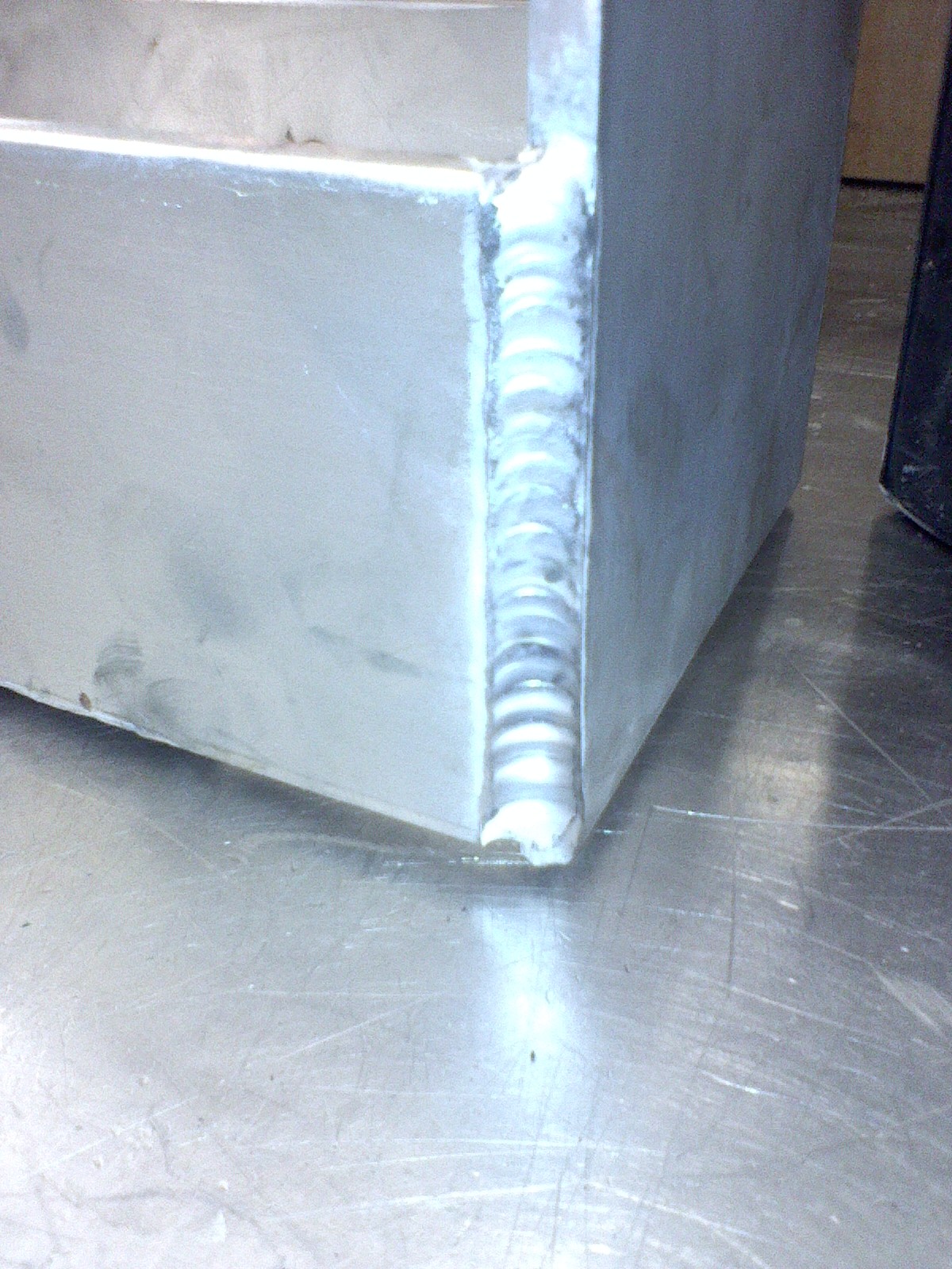

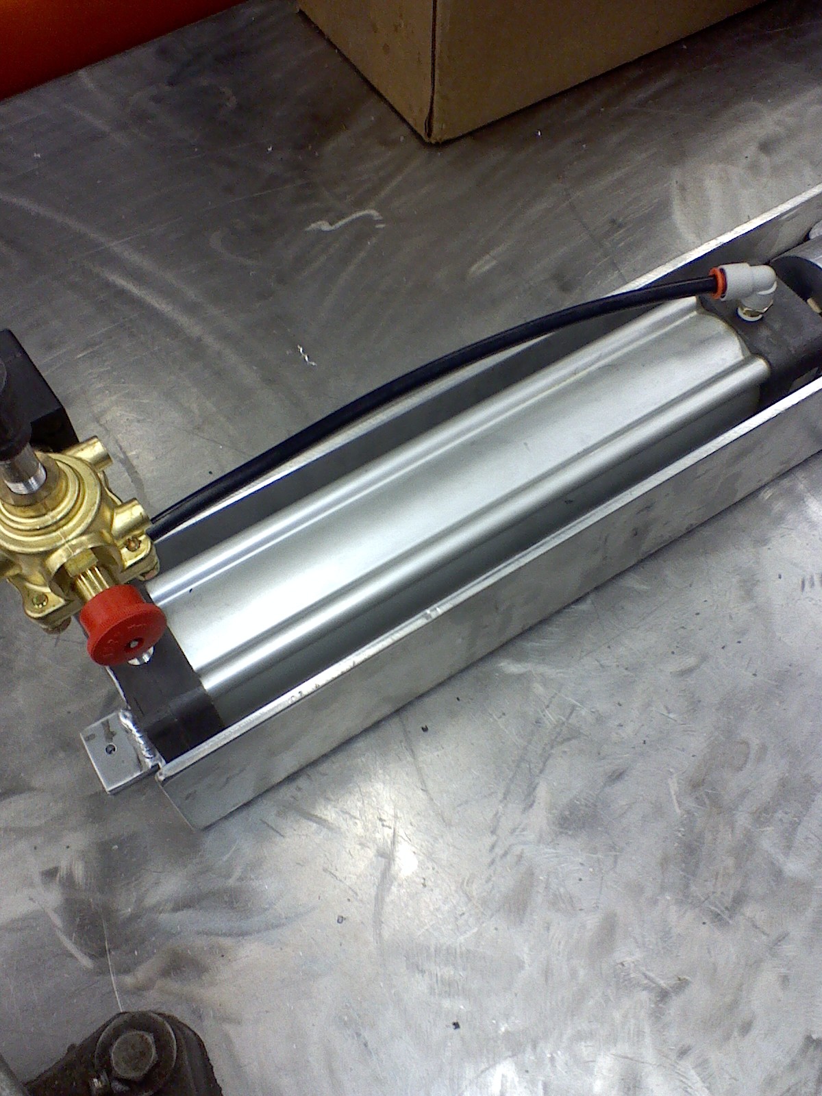

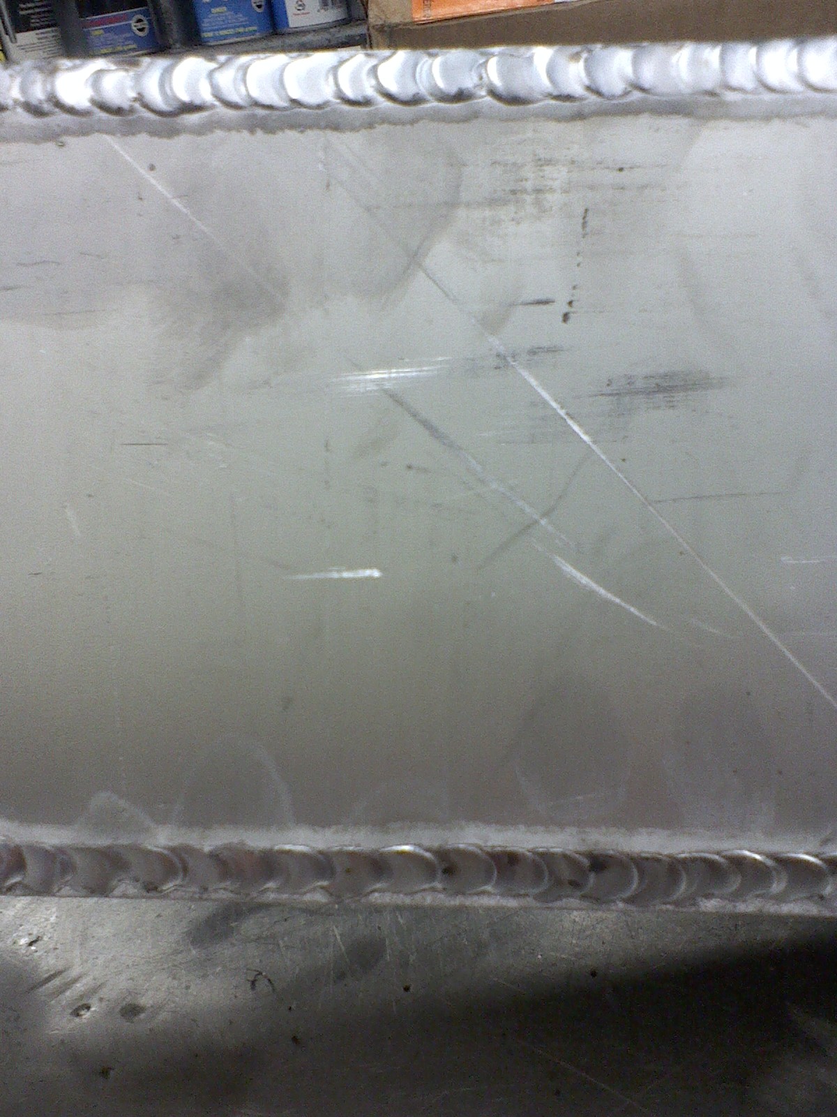

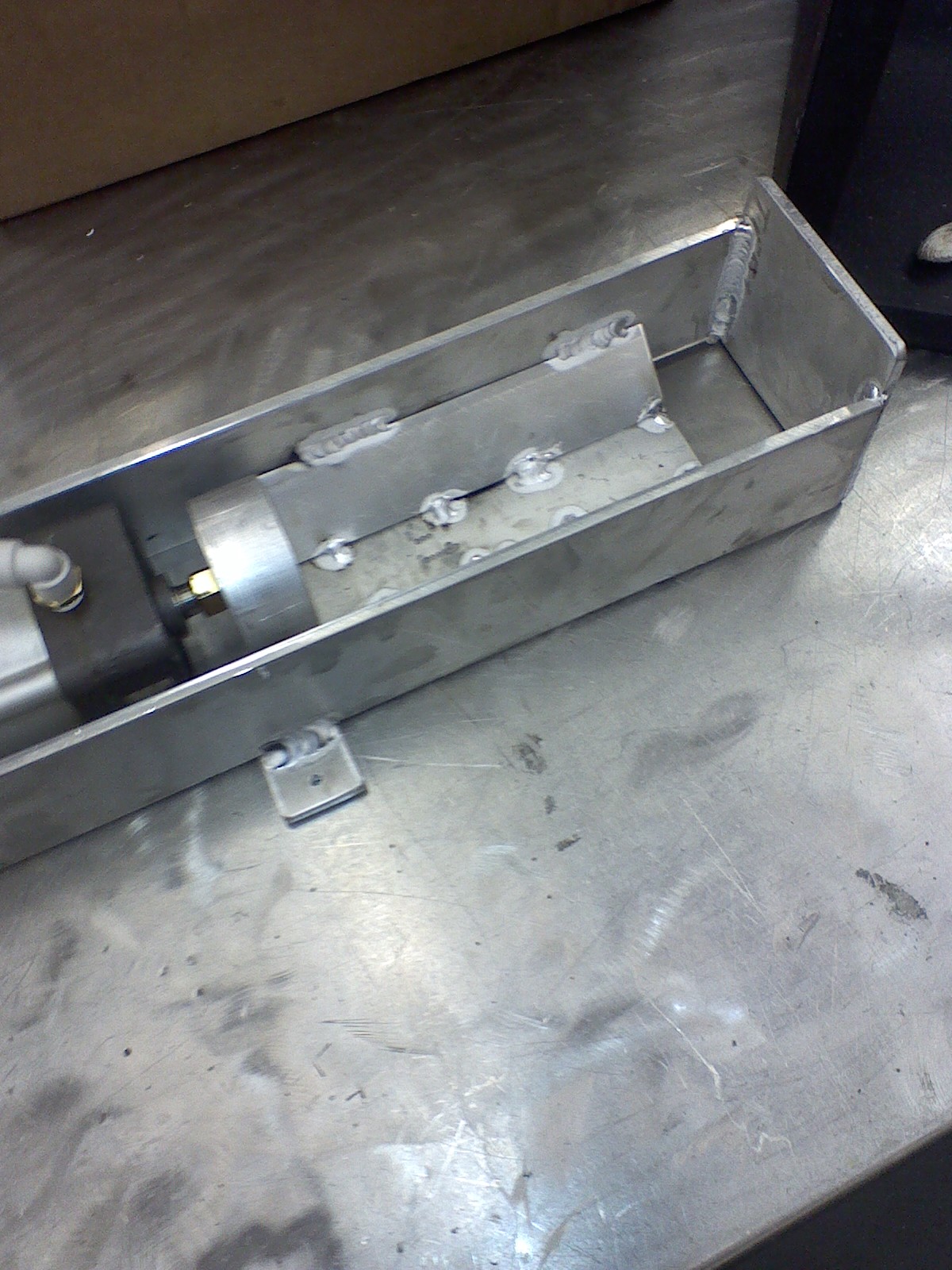

Some pics of the can crusher I am making.
The valve set-up is temproary. I have a lever DCV that I am going to use. This was set-up just to test. But has small ports so it dont flow fast enough.
Enjoy:thumbsup:

Looks nice but also looks expensive lol
/ Can crusher pics
Not really. The aluminum was just some scrap drops from the shear, and the cylinder was an old used one that was destined for the trash that I rescued.

Make a cut out in the bottom end and the can will fall out after being crushed. :thumbsup: Nice work!
/ Can crusher pics
It is cut-out. Notice picture 1. I know its kinda dont look like it cause its setting on a stainless bench. But where the angled VEE shape stops, is the end of the bottom.
This isnt the first one of these I have made. I just bolt them to the workbench, Let the end hang over about 6", and place a barrel underneath. Cans fall out very nicely.:thumbsup:

/ Can crusher pics
No guards. For personal use only. If I am stupid (or drunk) enough to leave a finger in there and hit the lever, then I deserve what I'll get.:mur:
/ Can crusher pics #9
ahhh I see it! Duh! Nice! Makes for rapid crushing! :jump:
/ Can crusher pics
It sure does.
And its actually more efficient than one might think. It takes 30 cans to make a pound. And they are bringing ~60-70 cents a pound right now.
My compressor....draws 15A @ 220V. With my power @ 12 cents /kwh, by my math, thats ~$0.40 to run for an hour.
Cycling this thing about 60 times causes the compressor to run for 1 minute to charge up.
So....under a pennys worth of compressed air to crush $1.20-$1.40 worth of cans:thumbsup:
