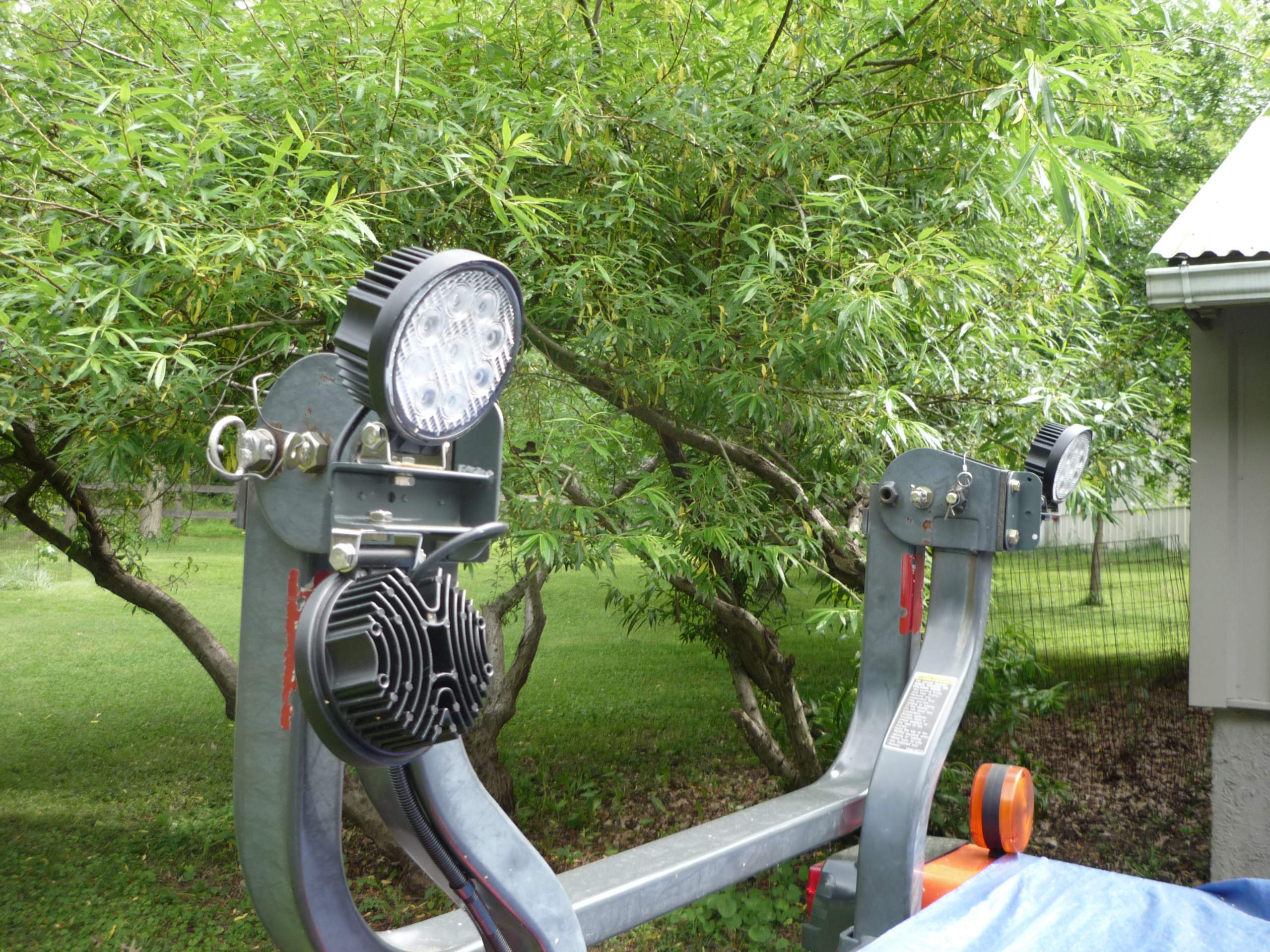

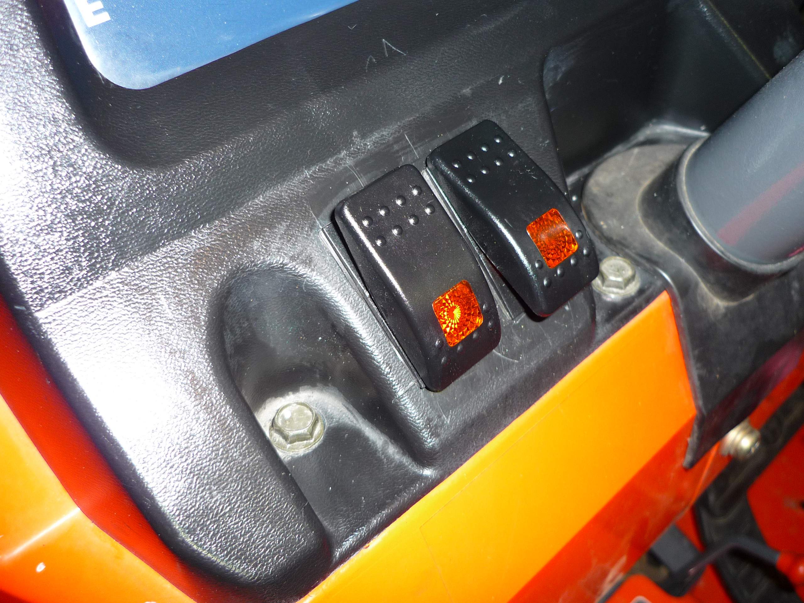

I have installed multiple LED floods and spots on three different tractors- all Kubotas, lastly using the two factory work light wiring harness points (with separate switching) with no issues. Yellow wires with bullet connectors, one under each fender. Having replaced the rear 55W halogen work lights on my first tractor with 27W LEDs, I will say there's simply no comparison- much more light, half the draw, and you can buy the LED lights for around $30 a pair with a little eBay shopping (even less if you buy 4), which makes it a no brainer, as they say. Cutting the switches into existing wiring is the hardest part.
