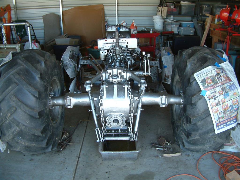

Hi,
I'm looking for some help. I own a MF 135 3-cylinder diesel vineyard model manufactured in France. I use it a lot for spraying, discing and bush cutting around my vineyards. I'm looking to move to another property that has a lot of wattle growing on it. I want to use the 135 for hauling logs and ripping. I would like to have greater width for better stability. Is it possible to replace the narrow axle on the MF 135 for a standard 35 or 135 axle? If so, what needs to be done?

Just guessing. But I'd think you need to replace the two axle assemblies (axle shaft and trumpet housing). Here's a view of the rear axles on my 1964 MF135 diesel.
I'd suspect that these longer axle assemblies would be pretty expensive from AGCO (the current owner of the Massey Ferguson brand name). You'll probably have to buy them used on eBay or from the salvage yard. I'd start looking at All States Ag Parts. If they don't have the axles, they probably know where to find them.

Many thanks,
Sorry to see you sold the tractor, it looks great. I'll shop around for used parts. I guess I need to weigh up the cost against replacing the MF135 with another tractor. But it has been a good worker and I'd be sorry to part with it.

Can you just flip your wheels around to gain more width? If not you should be able to buy some turf wheels and flip them around.

Well I dont know how rare the vinyard tractors were but I'd check. You might get enough to buy another straight up. Maybe cash left over. If you do swap out, Keep the old parts.
Thanks,
The vineyard 135s sell for quite a bit more than the standard models. I'll definitely keep the old parts if I change the axle. I need to check out the hydraulics. It wont lift a full disc. So maybe a good time to look at the axle swap.

Thanks for the suggestion.
One of the reasons I'm looking at a wider axle is that I could then fit a roll-bar on the MF 135. I have the specs for a roll-bar that can be bolted onto the standard axle.

I would tend to do a custom roll bar over an axle swap on that tractor. I think yours is a 8x6" lug nut pattern? There were standard wheels, turf wheels and orchard wheels. My turf wheels have the bolt pattern all the way at the edge of the wheel which makes the outside tread at 96". Those same wheels on yours might give you a decent width. This is not my tractor, but the wheels are the same. I would make sure my hubs fit inside the wheels you go with if you choose this option.
