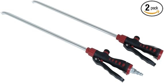

For the fins, I use a 2 gallon pump sprayer with dawn and water to get the soap deep in there.
I use them to flush out condenser and radiator on all our vehicles at least every other year.
Then use:
Radiator Genie, High Pressure Air and Water Cleaning Wands
