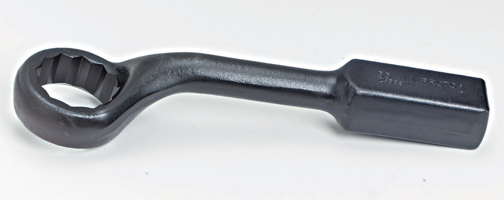

Hammer wrench & a slip on pipe bent to fit.
Or get a shallow socket and use a 24 inch pipe wrench on it.

I still say get a ratcheting box wrench, cut it in half, weld a 6" extension in the center. Working that many small bolts with a standard box wrench, at 1/6 turn at a time, takes forever. Ratchet wrenches are made for jobs just like this.
Very creative. Have limited arc of travel so too long is no good.

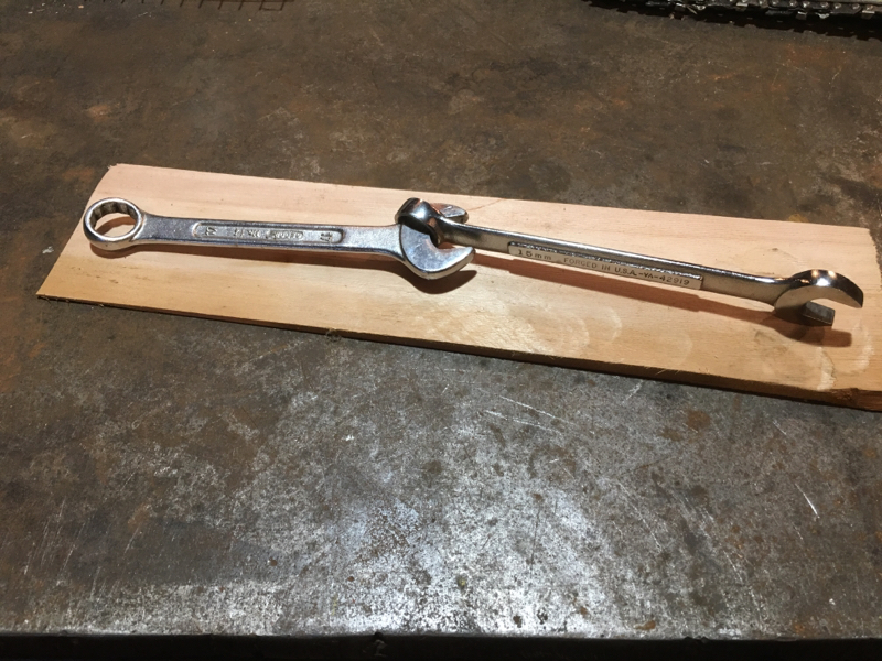

I'm guessing you tried this but it's one we used to use all the time at the garage:
It's a pain since you have to use both hands but it it might work to break the nuts free. Maybe you've solved this problem already...

Uh... You just taught me something...thanks.
   / Can I cut and weld two wrenches to make a longer one? #48
I use that double wrench trick often... Real lifesaver at times.
   / Can I cut and weld two wrenches to make a longer one? #49
I use the double wrench trick often. I've also slipped a pipe over the end. I've heated and bent wrenches to make a custom angle wrench. I've never cut 2 wrenches and welded them back together. Before I did that I would cut 1 wrench and add a piece in it or cut the end off to allow a smaller pipe to go over it.
   / Can I cut and weld two wrenches to make a longer one? #50
I use the double wrench trick quite often.
