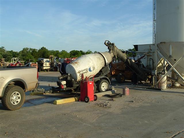

Here's a picture of a one yard concrete buggy that I'm picking up at United Rentals. Price varies all over the country, so you'll have to figure that out for your area. When comparing the price per yard of this and in a cement truck, be sure to find out the minimum charge and if there's an out of the way charge. Here, it's 4 yards that you have to buy. If you only use two yards, you are still charged for 4 yards. On top of that, I get hit with a $50 out of the area fee because I'm out in the country and it costs them extra to have to come out here. It is what it is.
I've found that the buggies are good for small pours and also those hard to get to locations. I did five yards for the footings on an addition that I put on a house this past spring with the buggies because of the location of the addition. Down an alley and through a small gate. It was either that or take down the fence or rent a pumper.

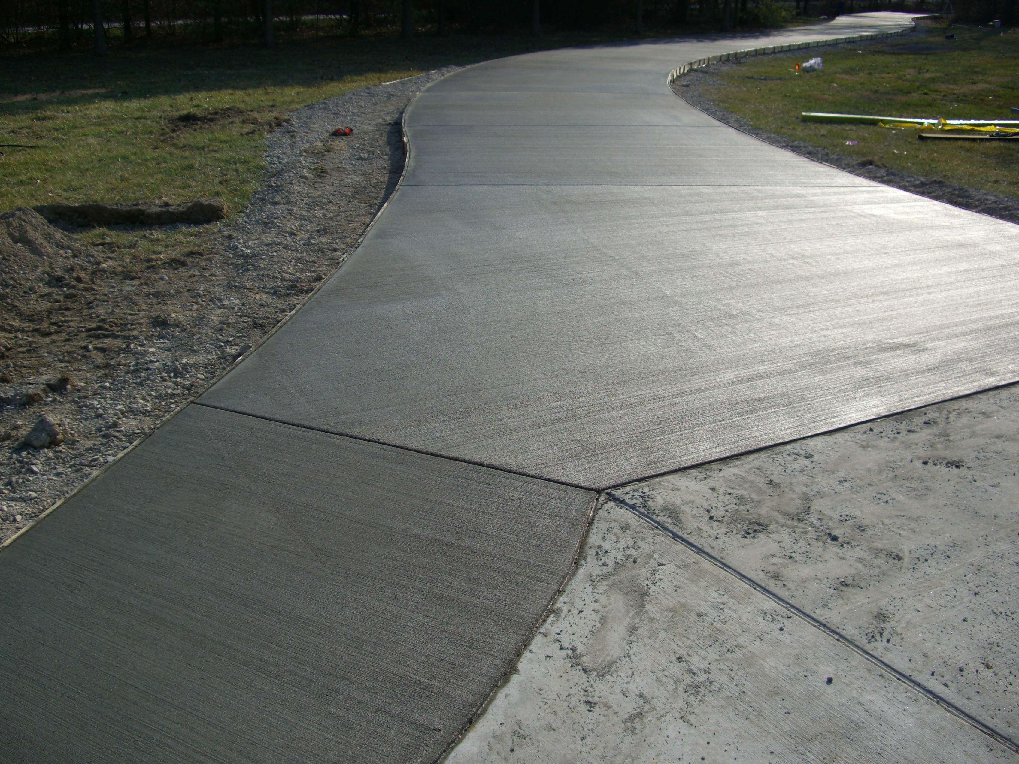

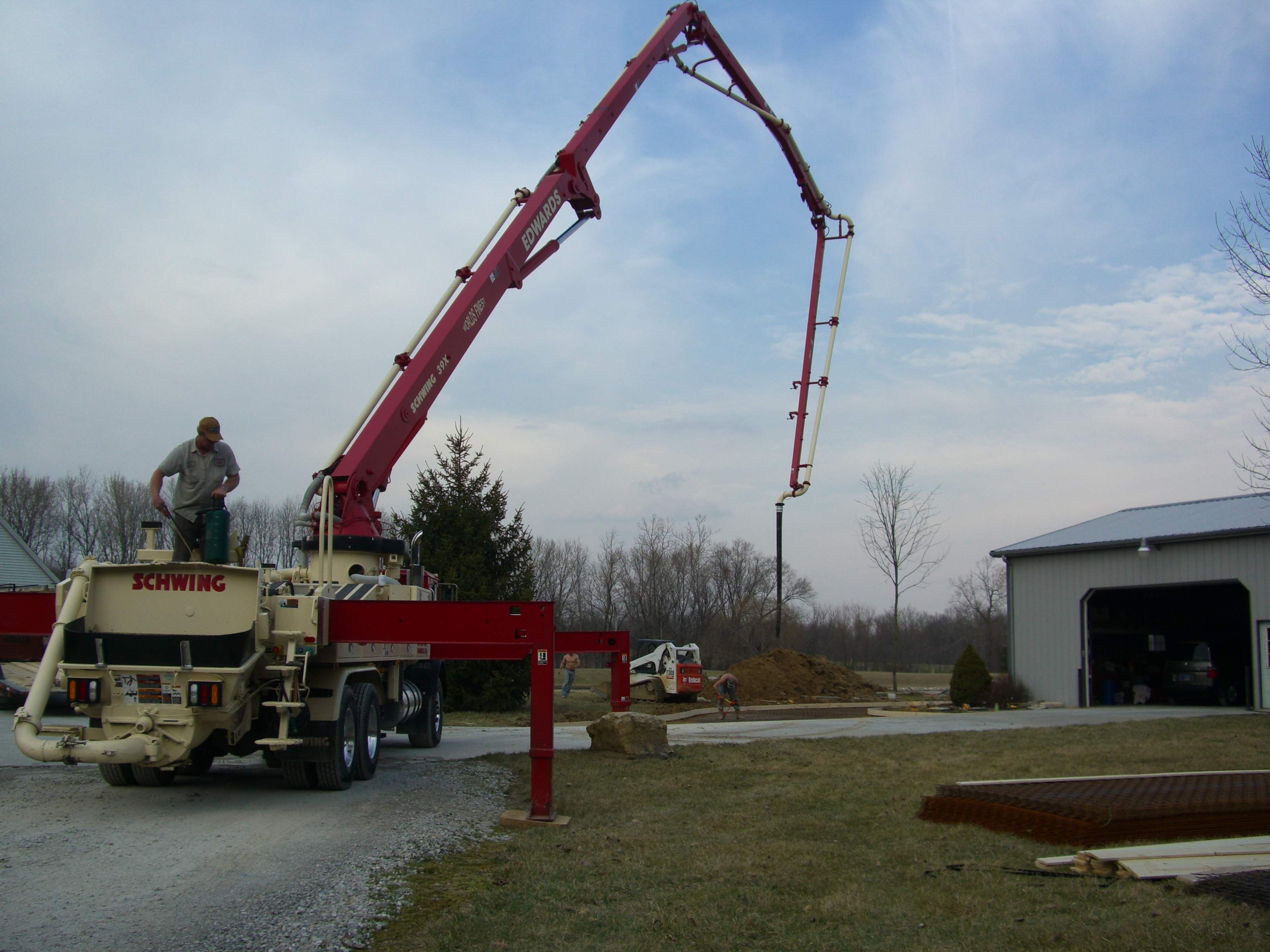

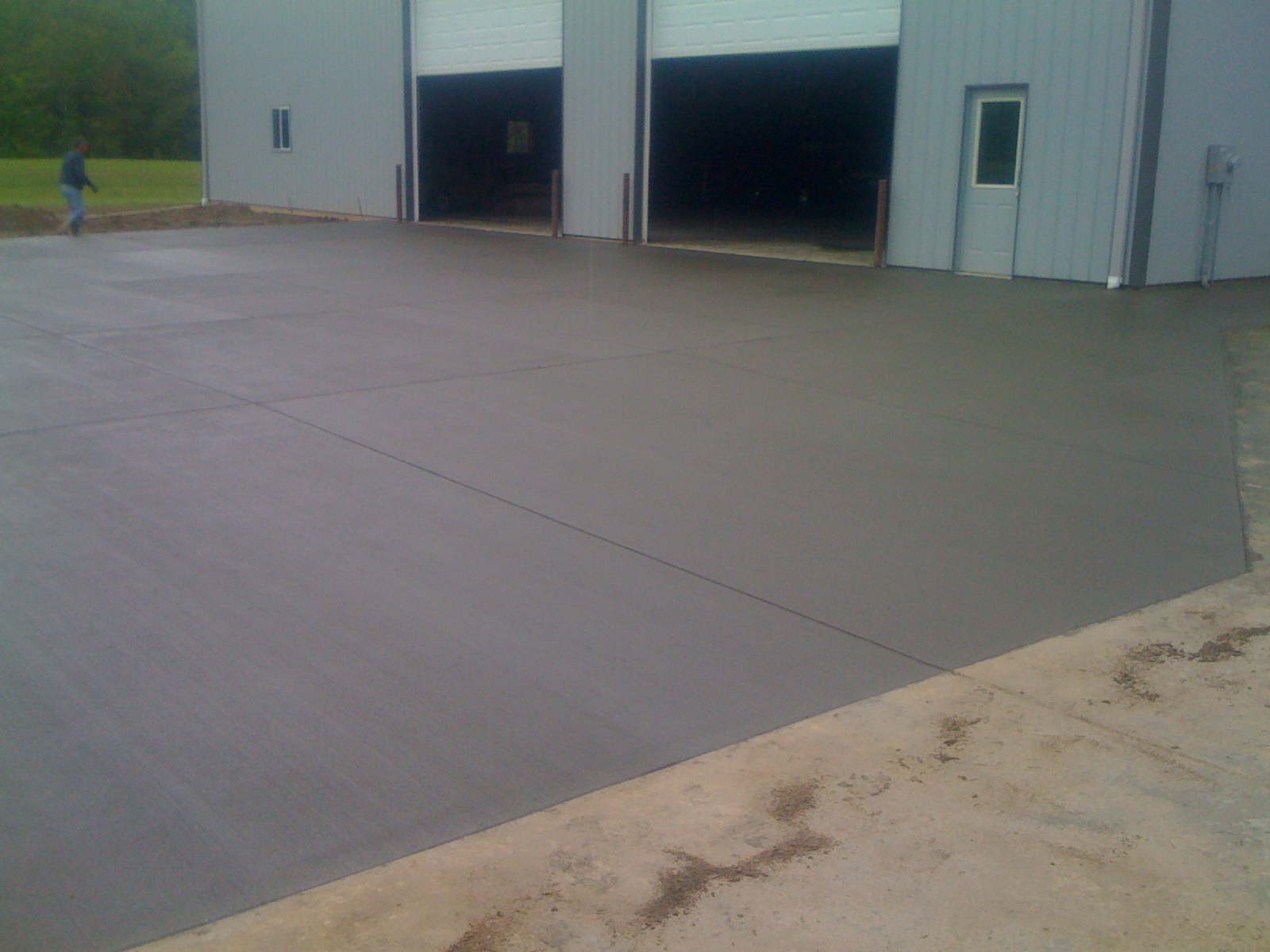

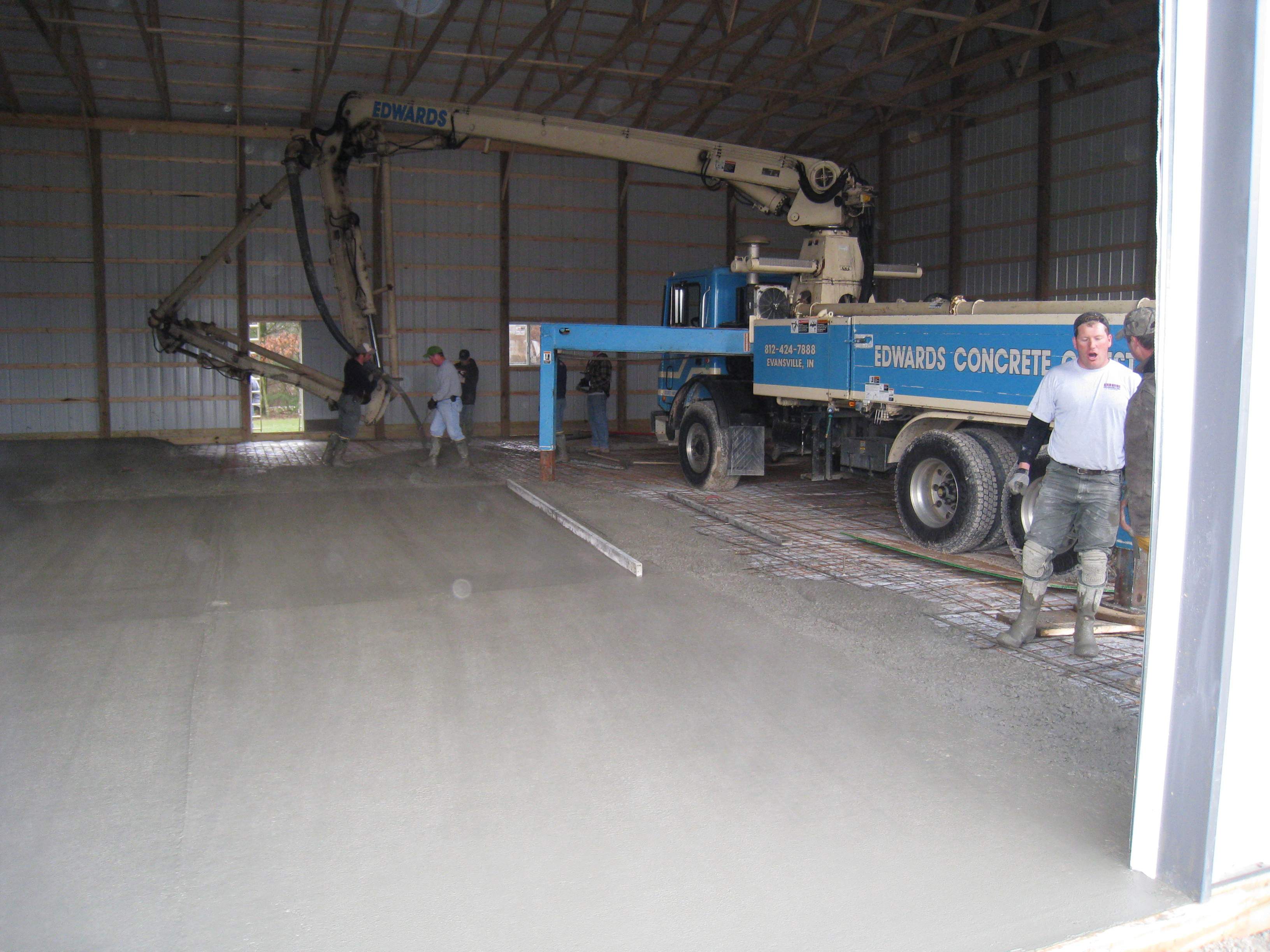

I'd have to say a lot depends on how young you are and/or how good your strength and aerobic conditioning is. I've done many smaller areas by hand, but most involved larger scale equipment. Last year I topped the 1000 yard mark at my place! For big commercial sites, that isn't all that much. For an individual homeowner, it's a bit much. For my larger jobs I've had huge pumper trucks (over 100' reach) here with a dozen or more full concrete trucks lined up down the street waiting their turn to empty their load into the pumper. The concrete truck drivers love that because they don't have to get a single chute off their truck and only get out of their truck to hose the one chute out.

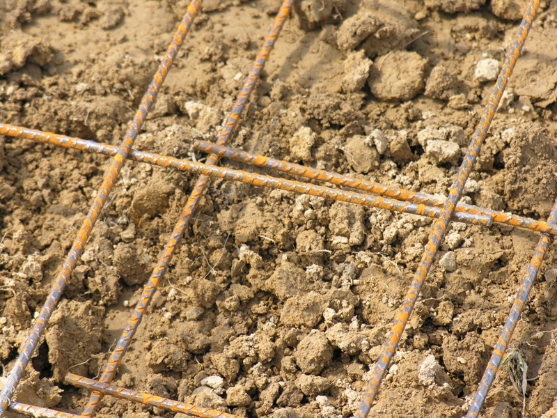

About the only thing that I found that I'd do different than what has been explained already is use sheets of wire mesh in the smaller jobs and not rebar. The wire mesh I use comes in large sheets and cannot be rolled due to the thickness of the wire. Basically what it is amounts to 1/4" rebar made into 8'X16' sheets. None of my concrete is less than 6" thick, so all this wire mesh is held up off the bottom by old bricks laid down before the wire is put down. Using the wire that comes in a roll seems to be a complete waste to me. I've removed some slabs that were only about 20 years old and the wire was pretty well gone. It had completely rusted apart inside the concrete and was offering no support at all. I have used 'footers' on all edges along with #5 rebar. Even in my barn where I store heavy equipment and run fork trucks (10" 5000psi concrete) pretty well all of my concrete has developed some cracks. To me the big issue is to make sure that the concrete doesn't move where it cracks. In other words, I don't want any part of the slab being pushed up vertically than other concrete. All the rebar and wire should prevent that.

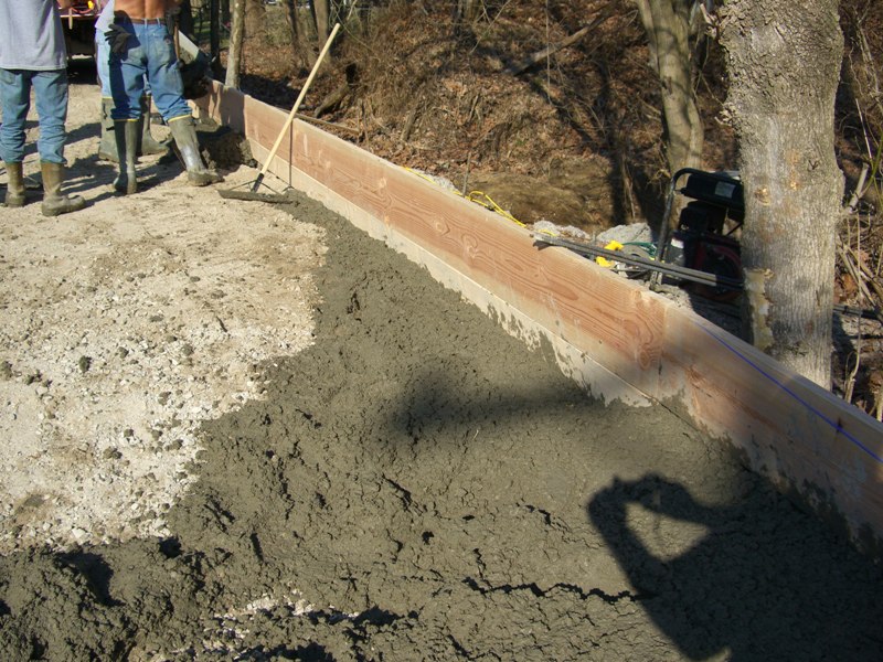

I included some pictures of a couple of the larger pours. One shows the "rebar matting" I talked about. In another you can see the forms for the concrete over my bridge consisted of a 2X12 on top of a 2X6. I didn't get any pictures of the 2000 pounds of #6 rebar I welded up and put into that portion because I was just too tired to move.
