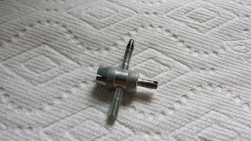

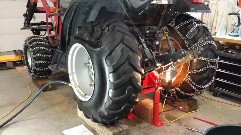

When I pressured up the repaired rear tire to 20 PSI... the tractor was tilting greatly because the other tire had a much lower pressure.
So I bled off pressure on the repaired tire to 12 PSI and the tractor was tiltling much less... but still tilting. Something didn't seem right so I decided to check the 'other' tire pressure. The 'other' tire was at 5 PSI which seemed way low. So I added pressure to the 'other' tire and got it up to about 9 PSI but then the valve core started leaking because of the corrosion. When I went to remove the valve core to put in a new one, the valve core disintegrated because of the corrosion.
The part of the valve core that the tool grips on to remove it is gone, the plunger is gone, the spring came out, etc. The valve core is still stuck in the stem with central hole open. The valve stem of the tube seems to be the type that does NOT have a separate core housing that can be removed and replaced. (The new tube I put in the repaired tire DOES have the separate, removable core housing).
So... if there is no possibility of removing the valve core and the entire tube must be replaced... I must drill out the stuck valve core in order to effectively pump out the ballast. (I have another tube on order but it's not here yet).
Any way to get the bad core out of the valve stem so that a new core could be installed?
I was thinking about drilling in with an undersized bit and hoping this would allow the stuck core bits to be dislodged. I would want to preserve the valve stem threads so the new core could be installed. But maybe with the corrosion, the valve core threads are fused with the stem threads?
Thanks for the ideas!

How long has the CaCl been that tire to corrode the valve stem like that? I'd try reversed drill bits, but I never heard of a valve stem decinercrating. 12 psi sound low to me.

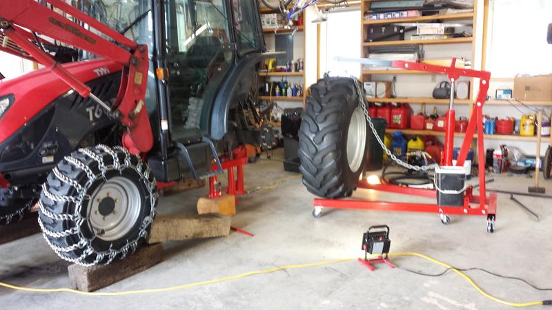

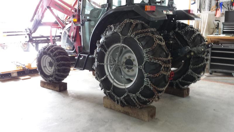

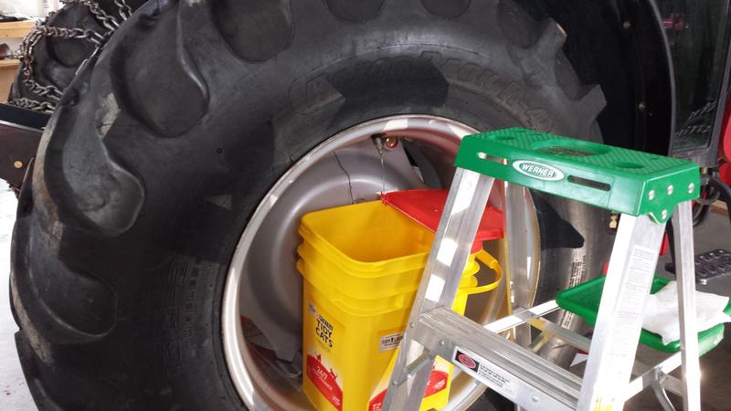

Thanks for all the ideas!, I'm sticking with the CalChlor for my particular application for now.
Thankfully, I got the problem sorted. I was able to extract the stuck valve core and installed a new one and the tractor is working again (without having to install a new tube) Currently running at 15 PSI each. Now that the fluid levels are down at the stem level, it's easy to jack up the tractor and install new valve cores to deal with the corrosion problem.
Thanks again for all the ideas!
